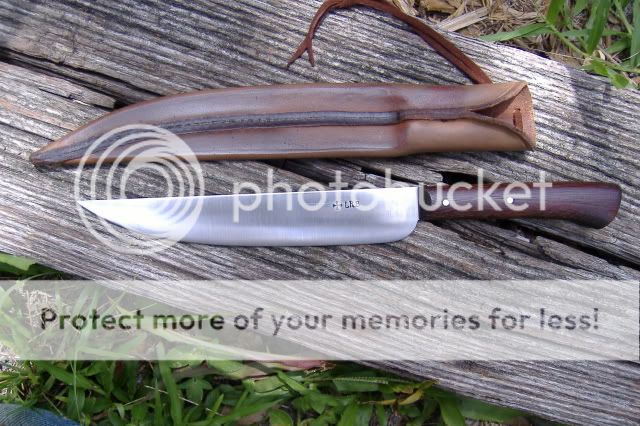

Sometimes called River Trade knives. After hand forging, the entire blade needs to be etch,similar to damascus. I am looking for any information on these early american blades and how to put it all together.

Rod, I do some period knives, although I'll bow to other makers. A big argument of mine with the reenactors is that the knife shouldn't look old. The knives weren't old when the people carried them. Also the roughness of the blades is an insult to the smiths that made them. A lot of even the trade knives were well finished knives.
One of the common "tricks" was to take bad steel and press the blade while hot between 2 file shaped dies. The Indians believed file knives were special, so by imprinting a "file" shape to the sides of an inferior blade they could get more in trade.
A lot of those knives were nothing more than large kitchen knives, same with belt and cartouche knives.
Etch in warm vinegar and spray with windex or baking soda water to neutralize the etching. Use mild steel, copper or brass for fittings, handle material should be either horn or wood native the US, usually maple or oak. I've seen rawhide used as a partial wrap on the handle. Most of the tangs were either through tangs and peened on the end or patrial tangs.

No need to use Fe CL.... a lot of us etch in warm vinegar. I etch for a couple of minutes, rinse it off and repeat until I get the finish I'm after. If you want more of a patina finish rather than an etch you can use mustard or some other acidic food product, I'm thinking about trying ketchup one day.

This may be of interest and others have probably discovered the same technique. I'm making a Hudson's Bay trade dagger and decided to vinegar etch the blade. If you wrap the blade in paper towel and soak it in vinegar and then move the paper towel around ie: pull it into small piles running across the blade (wrinkled) it will come out looking somewhat like ladder damascus. I have cleaned off the etch about 5 times to try new patterns. I dry it over a heating vent and peel the paper towel off after it's dry.
