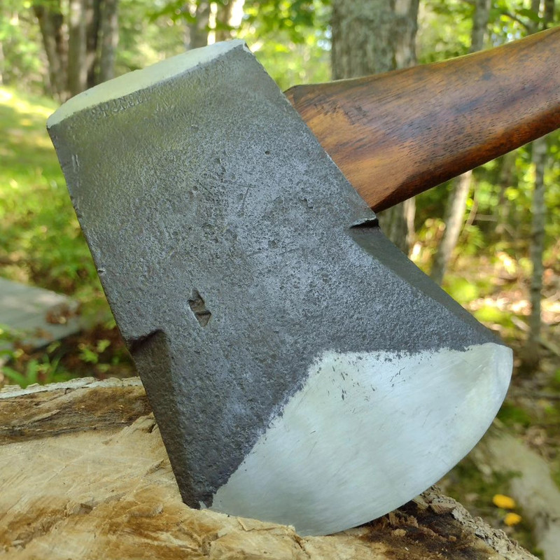

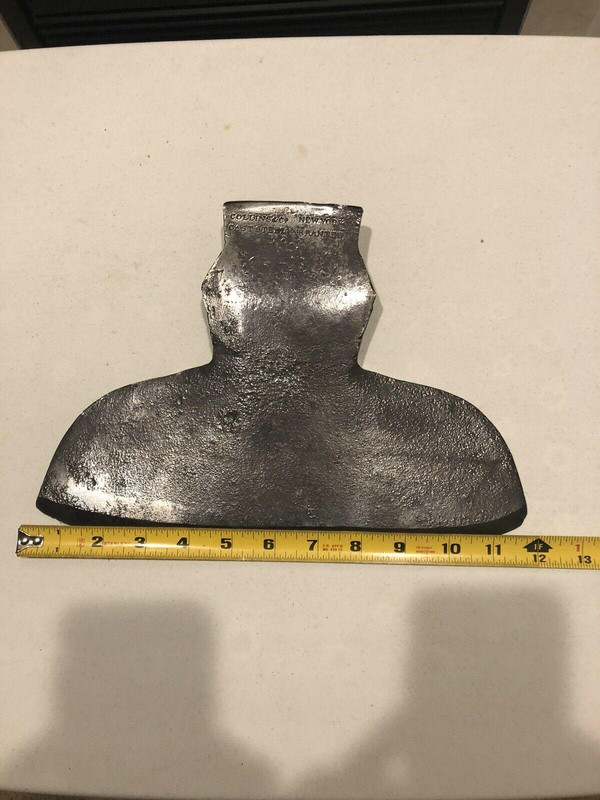

He folks- I'm looking for some expert insight on these 3 early "COLLINS & Co. NEW YORK" axes I dug in Minnesota yesterday. They were all cached together with a hand-forged beaver trap, a trade axe and a few other things. I don't collect foundry-made axes, but I have heard these are quite rare and potentially valuable. The one highlighted below is in the best shape-- the others have some pitting.

Eyes and those Yankee bevels look fairly modern. My conservative guess would be around 1875. Douglas offered similar heads in 1870ies . M.H Jones was established in1874 and later changed name to A.G. Peck. Peck was still making heads with those Yankee bevels around the turn of the century

Collins has never produced any axes in NY. Collins had only business office in NYC. NY location was used for marketing purposes when it comes to international sales (huge part of their business at that time)

Yeah they had offices in NYC and in Hartford ......but I've never seen any indication that they made axes stamped as being made in NY. Stampings say Collinsville, or Hartford, or Guatemala, or Mexico etc but not NY. There were however many counterfeits using the Collins name made over the latter part of the 19th and early 20th century with many resulting lawsuits.

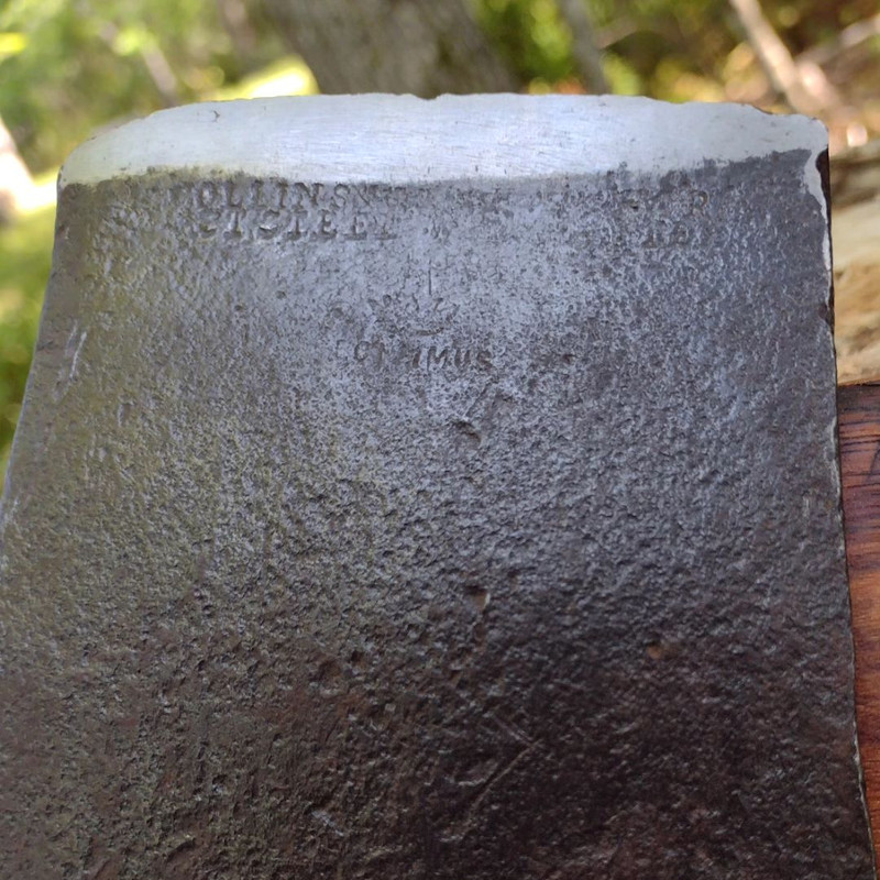

Ops' axe heads came from Collinsville factory, for sure. I have seen identical head with post 1876 Legitimus maker's mark.

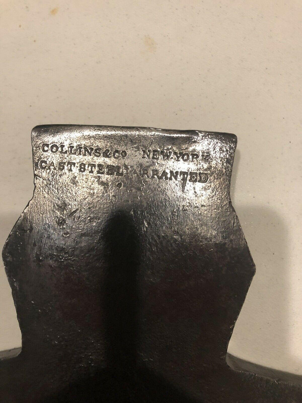

Collins&Co New York
Cast Steel Warranted

I talked to him a few hours ago and there's an interesting plot twist. At least one is marked D. Collins & Co, making it one of the period knockoffs that eventually resulted in the legitimus stamp.
Does anybody know which forge made the D Collins and Co knockoffs?
Interestingly my understanding is that they were discovered in a trade camp. I don't think it's a huge mental leap to think that's a likely place to find knockoffs of the time. I've never seen one in unused condition before.

Legitimus vs D. Collins
Used Josh's pics for comparison
437714050_25427764943504835_7084311224973303755_n-jpg.2563396
437741444_892454025986972_1373920272728323006_n-jpg.2563398

Very interesting! Yes, I think knockoffs could be peddled pretty easily by traders. The good news for the original owner is they're still very high quality axes. Didn't see much use, if any. Thanks for the work looking into these!
