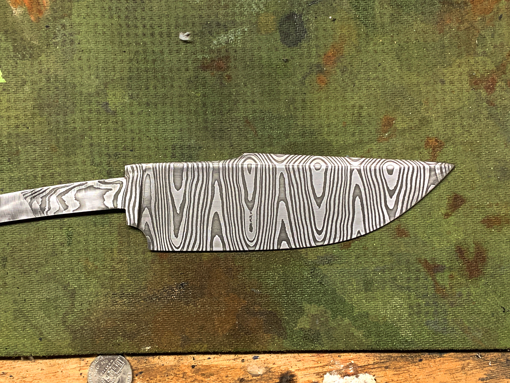

Howdy,
I made my first damascus this week. It was my 2nd attempt, my first attempt a couple months ago had a big delamination right through the middle, but I may be able to salvage parts of it for a guard on the knife I made from my 2nd attempt.
I dont have a power hammer or hydraulic press, so my layer count is low, but ladder patterns seemed more accessible, although I lost a LOT of metal to scale, and a good bit to cutting and grinding as well, and of course it was a lot of work.
Anyway, I'm really happy with how the blade turned out. When I was sanding before the etch I was thinking it was a lot more trouble than it was worth, but after the etch I suddenly had a whole new attitude :)
Now I'm kind of hooked on making this stuff.
I'm thinking raindrop might be another one I could do, although again I would lose a ton while getting enough layers hammered down.
Anyone have any other patterns that are more accessible to a straight hammer and anvil guy?
Heres the blade I forged from my ladder pattern. Its 6" from shoulders to tip. Spine is 3/16" thick at the base, with a nice distal taper. I could have forged the billet out more for more length, but I wanted to grind the bevels to make the pattern more interesting, and I also didnt want to stretch it out more as my layer count was low. Its 1095 and 15n20.
Don't forge myself but twist seems like a good idea for hammer and anvil (and big pipe wrench) guy.
Do you have a welder? If you do, you could do some mosaics.
When learning, try random, ladder, and twist.
Heavily hammered random can be fun to do and look pretty cool. Work the billet as usual through the drawing out steps. When the billet is still about twice as thick as desired, switch from the drawing/forging hammer to a big ball peen. After working the snot out of it with the ball peen, flatten/straighten it up just a bit then grind it smooth. Once that is done, finish forging the blade as normal with a regular forging hammer.
When doing twist, make sure the bilet is SOLIDLY welded up. It should show no lines along the sides. Grind it clean on all four sides (and inspect closely) and then forge it into an octagon. Clean it up again and then bring it to welding heat and twist it. When it stiffens, stop and put it immediately back in the forge. Don't let it cool to below red until all twisting is done. You should twist it as much as it seems possible. Straighten it up gently before each heat. To twist - put one end in a vice and grab the other with a modified pipe wrench. You can make a twisting wrench by welding a piece of pipe on the head of the pipe wrench so it has two handles. It helps if you forge the ends as squares when making the octagon.
Also, try damascus san-mai with a core of high carbon steel similar to the steel in the damascus. If the damascus is 1095 and 15N20, use a 1095 core.

I had 40 layers. I actually worked on 2 billets at the same time. Each had 10 pieces. Drew them out, cut, re-welded and had 2 billets of 20 layers. then I forge-welded those together and got one 40-layer billet. Of course by now I must have lost a layer or 3 to scale. After grinding my grooves in each side and then flattening the now-accordion-shaped billet I probably only had about 20 (visible) layers left in the billet which was just over 1/4"
the first time I tried making ladder I just cut nearly straight-in grooves and the result was I had some cold shuts, and also the patters that resulted had lines buncing up or really far apart alternately, so this time I really rounded out the grooves and was real careful flattening it. the rounder grooves evened out the spacing of the layers and helped prevent any cold shuts...
This is that billet before I flattened it...
Grinding into a ladder is going to do the opposite. The majority of the character is at the surface of the billet. The layers in the center have the least amount of change. So forging a ladder down will preserve more activity.
Grinding into a twist can do what you're saying, because there is more activity below the surface. If I were doing what you're doing, I'd practice doing twists, and when you have them down, try a multibar turkish twist. You can keep your individual billet sizes small and manageable, and welding them together by hand isn't too much of a chore since you're trying not to distort things at that point. Even a very low layer stack of 3 or 4 twists can be very intricate when finished.
As you can see in the photo's, grinding into the ladder did exactly what I thought it would do. It made the lines appear to zig-zag, which IMO is more interesting than when they are all running parallel to each other.
Definitely going to give the multi-bar twist a shot :)
Your blade shows 40 layers can make a very nice pattern. Looks good. Thanks for posting the photo of the billet showing how you ground the ladder portion in. The results in the blade speaks for itself - GREAT JOB.

I love bold pattern ladder. I did a cutlass that I twisted then laddered and if cane out looking great. What thickness was your strips to start with?
Yeah, some of the super-high layer count stuff looks awesome up close but then 5 feet away it’s hard to see. I’m fortunately I like bold patterns, because without a power hammer or press that’s about all that’s within my reach :-)
My initial stacks were 1/8 x 1 x 6
