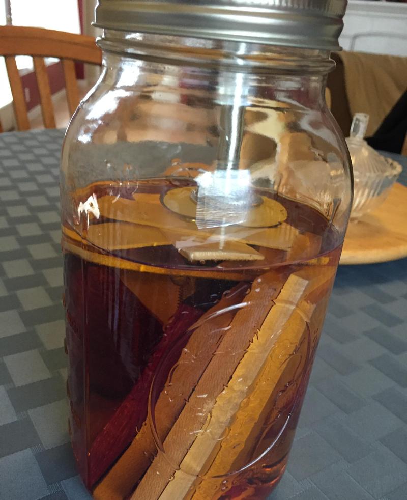

I was searching around here for an easy way to stabilize wood and while I'm sure there must be at least a few threads on how to do it yourself, I couldn't find any. Here's how I did it.
Most of what I needed I already had, but here's what you'll need:
Stabilizing resin (I used Cactus Juice).
1 64oz mason jar with lid and ring. At my local Target they were $1.88 ea
1 Foodsaver T03-0023-01P wide-mouth mason jar sealer or equivalent:
http://www.foodsaver.com/accessories-and-parts/foodsaver-wide-mouth-jar-sealer/T03-0023-01P.html
1 Foodsaver accessory hose, cut in half:
http://www.foodsaver.com/accessories-and-parts/foodsaver-accessory-hose/T17-0059.html
1 vacuum pump. I ordered a cheap hand pump from Amazon, but I think Harbor Freight has them as well.
http://www.amazon.com/gp/product/B00T3W3FB2
The vacuum pump I ordered had an adapter to attach it to the Foodsaver accessory hose. I fashioned a weight by cutting a paint stir stick into 3rds, stacking them on top of each other, drilling a hole through the center, and put a nut and bold through to hold them together. Once I put my scales in I slipped the paint stick into the jar and spread out the three sections, then put a heavy bolt and nuts on top of that to hold everything down. I covered the scales with Cactus Juice, put the lid and jar sealer on top. I was able to pull about a 30" vacuum with the pump, then I released it to let the lid seal on the jar. I'm sure I lost some of my vacuum in the process because I noticed the bubbles subsided a little when I did this, but I still had plenty of bubbles coming out after the lid popped and sealed. The nice thing about this was the hand pump draws the vacuum slowly, so there was absolutely no problem with the bubbles rising to the top of the jar and overflowing as seems to happen with electric pumps.
From this point I'll just finish with the rest of the instructions for the resin.

Maple, Padauk, Cherry, Leopardwood, and Sycamore.
A lot of people who use similar method with cactus juice resin are quite happy with the results, and sure it is a nice way to seal the wood.
The quality of the job boils down to the quality of the resin used, the amount of vacuum applied and gets better if at the end of the "pulling" cycle one is able to increase the pressure to drive the resin deeper into the materials.
For what it is worth you didn't pull 30" of vacuum ... no one has ever done that.
29.92" is the theoretical maximum at sea level. Really good ( and expensive) lab equipment gets close to 29", but a food saver probably doesn't hit much over 24".

That's a general recommendation for air drying wood. The wood has to be dry to be stabilized, the stabilizing agent is going to fill in all the areas that water uses to migrate in and out.
The wood under vacuum will dry further until the energy available reaches equalization. If the wood isn't dry enough to start with ice crystals will form and block the stabilizing agent.
I've never actually used an outside vendor but I would think they would outright reject any material that is too wet to process.

Although I am a beginner at knife making, I have a lot of experience with stabilized wood that I used for turning. In my experience I have not yet found a home stabilized wood, other than something that was rather pinky to start with, that the stabilizer penetrated to any significant depth. I think that the pros utilize a pressure process to facilitate full stabilization of the block. If you cut a 1x2 handle block down the middle, check to see whether the center is stabilized or not. Placing a cut stabilized block in water overnight to check for swelling is also a good test. Perhaps Cactus Juice will work on scales not to exceed 3/8" if held at 29" vacuum until no bubbles come out. I would 't trust it for thicker pieces but would love to hear whether anyone had tested with good results with larger blocks using a home process. For now I'm sticking with wood stabilized by K&G.
