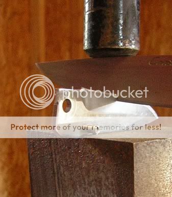

A341946D-C3A5-4788-989E-808C2857005B.jpeg 60CD1BC9-7305-45D0-877B-377D02300EAE.jpeg Picture of EDC2 3V and Busse Bad before hammer strike.
What will happen?
"Not going to happen unless I loose my mind"
INFI vs D3V? Hmm...my guess would be that they cut into each other!
Come on guys. I would love to see results but I’m not brave enough, dumb enough or rich enough.
I would love to have your opinion though and thought this would get your attention.

I would guess that the delta 3V would slice through the INFI to a point, and then the toughness on the INFI would overcome the higher hardness of the 3V and the 3V would crack. Just a guess mind you.

That is in fact what will happen. The harder thinner D3V will cut into the thicker softer Infi to a point until the section of the Infi reaches a point that exceeds the strength of the D3V where its lower ductility (plate martensite in that EDC) will lead to a break.
D3V at HRC 62 ~ 350,000 PSI, Infi ~320,000 PSI. ECD .030 BTE, Infi ~ .040 BTE. ~4 DPS primary / ~5 DPS primary
The EDC will cut into the Busse for ~ 1/8" then break
The test doesn't tell you anything about the cutting characteristics or edge retention of either knife. Both knives are high end high performance tools that deserve better.
