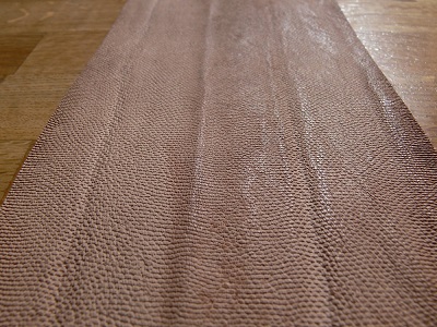

This is just speculation, I'm not at all familiar with Kangaroo's being from the USA myself but could the tail provide a better strop because of micro-abrasives / dirt / dust embedded in the hide? It would essentially act as a fine stropping compound. It looks like their tails drag on the ground fairly often, I imagine a lot of fine grit would get worked into the hide.
I'm curious about this tail leather now. I've got a couple edge pro strops with roo leather, but it is super smooth.
Yes, the kangaroo skin is smooth, while the tail has a palpable cross-texture; the difference is the same as between the human skin and sole. The older the animal, the more pronounced is that texture; the roo puts its weight on the tail all the time, I guess that might be the reason.

If you look at the second picture in the ebay listing and however your mouse's hand over the picture to zoom in,you will be able to see that it's the outside of the tail and look at the texture of the leather.
https://www.ebay.com/itm/KANGAROO-T...670226?hash=item4202ac0812:g:RegAAOSwy5xc~tYJ
