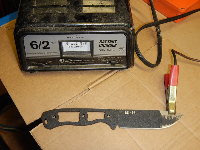

New 16 arrived in the mail a couple of days ago, and since I've been home lying around (back injury) I've been reading up on etching with salt water and electricity. I plan on stripping the coating, but before I do, I thought I'd give this a try first....
Basic setup: partially stripped blade for good conduction, car battery charger, salt water & Q-tips
Then I just kept dipping the Q-tip in the salt water and clmping it in the negative clip - the 6 amp setting seemed to work a little better. When it was all said and done, I think I ended up with a pretty good etch:
I'm sure it's deeper than the factory laser etch, I'll post more when I'm done stripping it
If I can rig up an A/C etcher, I'll give that a try before the strip - its supposed to darken the steel...
Thanks for checking this out!

AC will indeed darken the steel,and it will look much better when you strip it,so go for it.

Excited to see how deep it is after you strip the blade. I've got a BK7, BK4, and a BK10 that need stripping and I would like to deepen the etch before I do.

I think I fixed it...
I'm stoked that this came out so well on the first try!
Now I'm gonna have to come up with a patina to do it right...

It's too late for the 9 and its laser etch, but now that I've got the process and the setup, some stuff is cookin' up in the ole noodle. And I will post pics - just don't hold yer breath :rolleyes:
Wow, that came out great! Just the right depth I'd say. I might have to try this, I have a battery charger somewhere.
Just make sure that after you deepen the etch with the charger (or any DC power source, like a battery) get yourself an AC transformer as well (like for a doorbell or an alarm system) 16~24 VAC and that will blacken it. I also toothbrushed it with Bon Ami - basically baking soda, but that stuff is .99 a can! - before, in between and after the whole process. Gotta make sure the steel is clean and free of contaminants (like oil) before you start.
