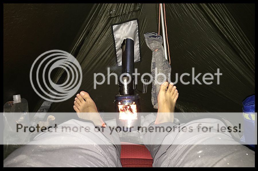

you've also ruled out a heated shelter...pretty nice when it's cold outside...that all-titanium stove is only a pound by the way.
all radiant heat to dry out wet socks and boots...no risk of burning since there are no exposed flames.
