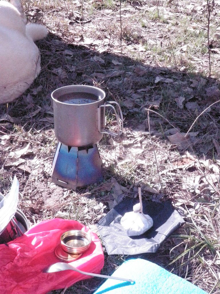

This was Jan-Feb 2016 on a day long kayak run. The Vargo is being used here with an alcohol stove (practicing our leave no trace ethic :) ) but you can see the discoloration that has happened over time.
The discoloration looks great IMO.

I must offer an apology BladeScout, I did not really answer your original question. At the time I got my Vargo, emberlits were a little hard to find/come by so I got the Hex as a "backup plan" kind of deal. If I were picking one of the two, sitting side by side for sale today, I would get the Emberlits in Ti. Simply because ther are no moving parts, the way it hooks together is as fail safe as a product could be. Now "after the fact" or after I had been using my Vargo for a bit I did hear reports of the little compression clasp feature that holds the Hex in its upright form giviving way or coming un-clasped when hot. It had never happened to me personally but some trips I have taken were 4-5 days deep in the bush. I considered the fact that having a boiling hot pot of anything spilled on me while that remote would be very very bad. So, after a little experimentation I found a girls hair pin (or bobby pin)was just right for slipping thru the clasp. You can just barely see it in my pic above. I got a huge card of these at the five n dime, 50 I think for less than a dollar.one stays clipped to the stove and a spare in the stove bag. As I said, I've never had a failure, but it's a tip that might be used or passed on should you hear a complaint about the Vargo closure. :)
