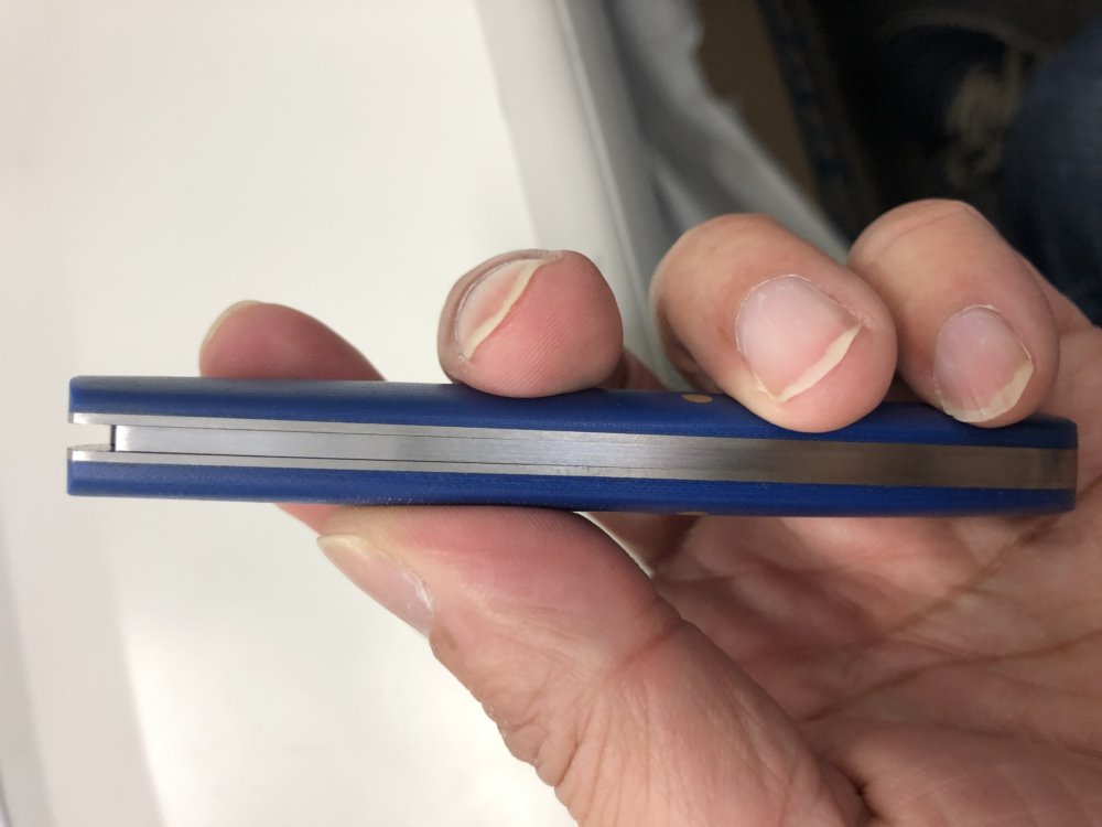

There are known design issues or specs, to lower the manufacturing cost.

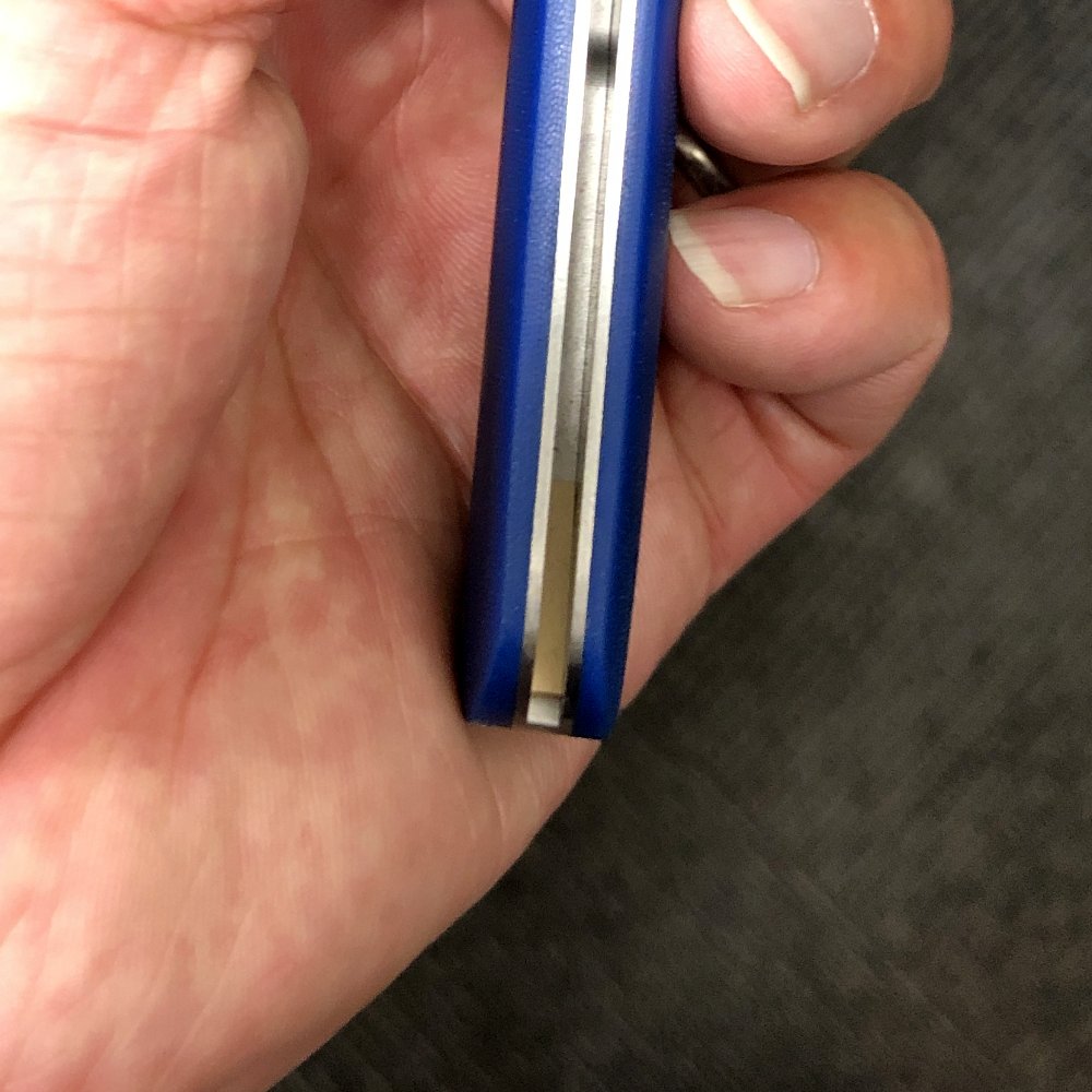

First, there are clear gaps between the liner and spring.
This is because they put washers without reducing the tang thickness.
Second, they say a knife may come with an off-centered blade.
Mine was exactly that.
I know these are just aesthetic issues.

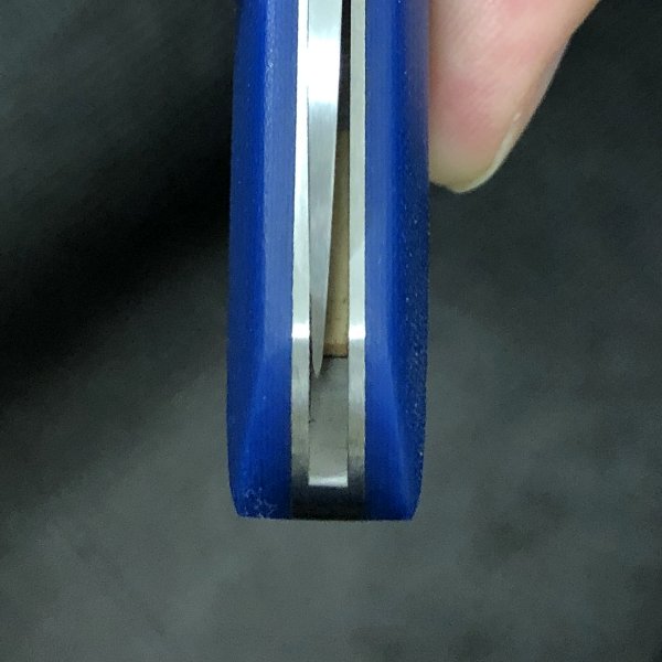

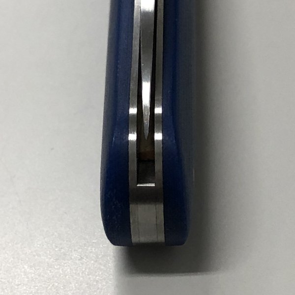

But the last one is an actual flaw.
The blade hits the spring very badly.

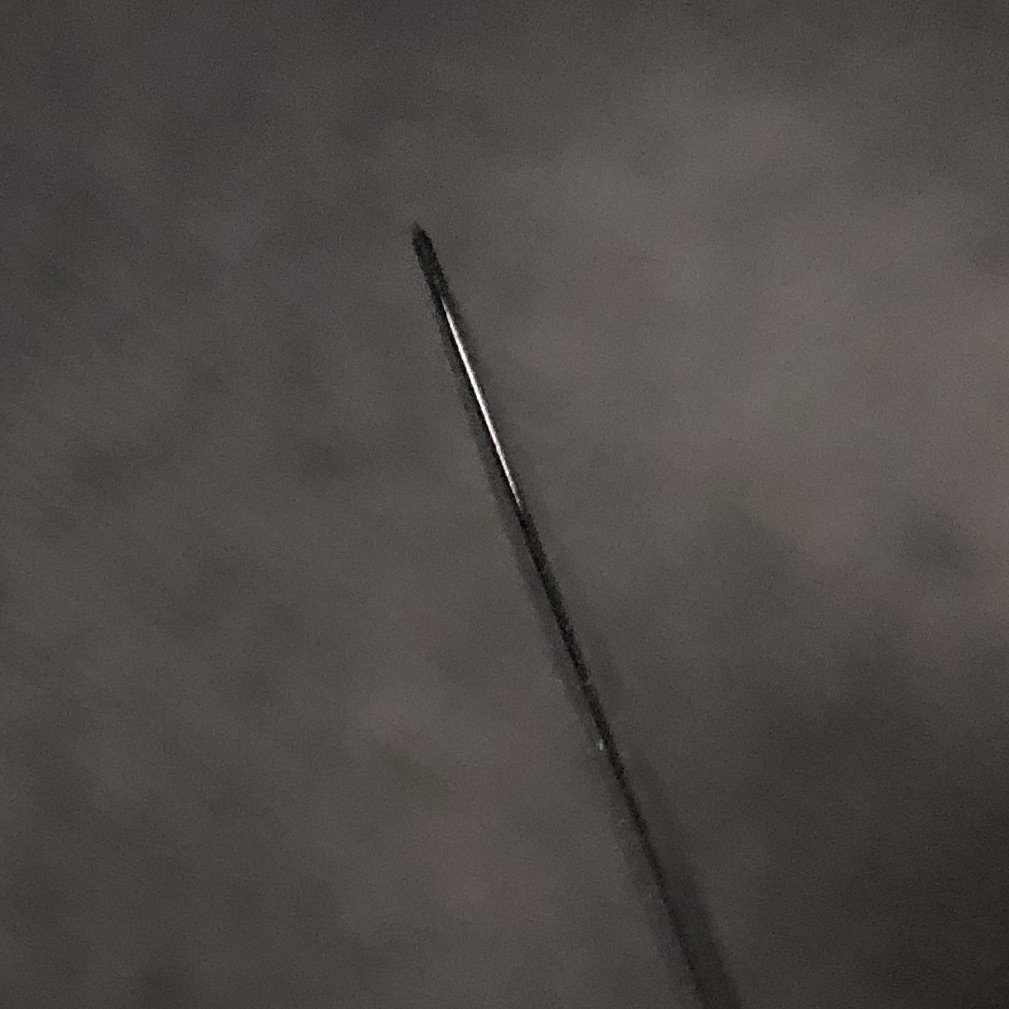

Edge was flattened near the tip (the shiny area)
I have had a few traditional slip joint knives, which had this same issue.
But after several sharpenings, it tends to go away.
For Enigma, it has not.
I have sharpened it a dozen times, and I still get a big ding.
*Sigh*
I got over with the gap issue quickly, but the other two really bothered me.
So, these are the reason why I had not used it until recently.
Then, thanks to this forum, I learned a way to remedy the blade kissing problem.
First, I should not drop shut the blade but close it with grace:)
Second, I put a piece of cork on the spring where the blade kissed.
It is not a permanent solution, but it is OK for now.

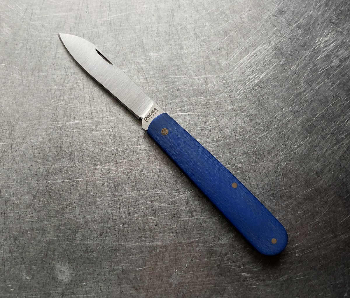

Blade:
Nicely thin blade stock.
The grind is nice but not as deep as I would like.
I may thin it down at some point, but it is quite slicey as is.
Edge retention seems quite good, presumably because of the steel at high hardness (62 HRc).
Sharpening and touching up are easy with silicon carbide and diamond stones.
Handle:
Very nice linen Micarta on mine.
Smooth but grippy enough.
The extra handle length for the blade size and the contouring provide comfortable hold.
Pins are all flush to the cover.
The mosaic pivot is aesthetically pleasing.
Fit and Finish:
OK, but not excellent.
Comparing to GEC knives and Lion Steel knives I have, this department is a major weakness of the knife.
The uncentered blade is one issue.
Also, there are some sharp corners and burrs left.
The back spring is not flush with the liners.
Oh, and there is a very slight blade play, which might be a result of my centering adjustment, though.
After correcting the centering, I can live with the others.

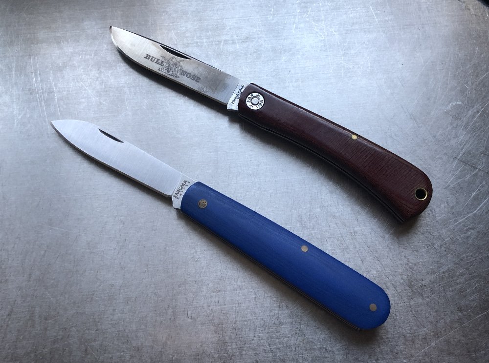

I think the Enigma knife is comparable to GEC #71 in size and cutting ability.
Superior fit and finish for GEC, way better edge retention on Enigma.
Comparison with GEC #71 Bullnose

Thanks for the review. You are very forgiving. For a $125, it shouldn’t hit the backspring or rub the liner. In my eyes it should also have a shinier blade finish.
Yeah, I guess.
Probably because their knives are unique.
When you look for a slip joint knife, which is as slicey as GEC knives and sports a high wear-resistant steel, you don't find many options outside custom knives.
Most of modern slip joint production knives I found are typically thick at the stock and behind the edge.
It is really beyond me why a sub 3" slip joint needs 0.12" or thicker blade.
So far, Enigma Knives is the only production shop I have found so far providing a traditonal-thin slip joint knife with a "super steel".
That is why I am forgiving.
I hope they raise the bar for F&F (relief milling, blade centering, spring position, and kick adjustment) even at a higher price.
