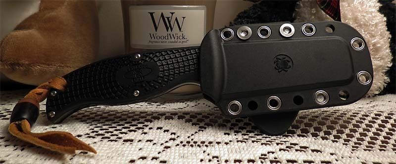

A word of caution on the sheath for this blade, one other person made comment that his knife became dull quickly from being put into the sheath, mine also seemed to show this too, then I tried to reverse how I had the knife in there and that seems to have helped.

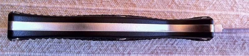

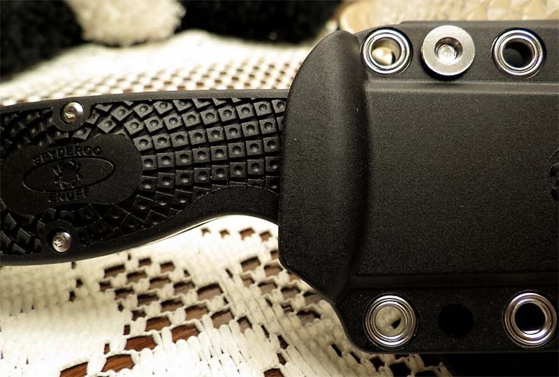

Here are a few images of how I now place the knife into the sheath, note the orientation, when inserted the other way, it would cause the edge to cut into the bottom of the sheath, but this way, it doesn't cut into it and the knife is remaining sharp...
I just took the info out of the box, the images of the knife sheath is opposite of the way I'm doing it, but, wrong or right, this seems to keep the edge from being abraded by the bottom of the sheath, the knife is still retained securely...
I ended up taking a large file, using the edge like a saw and filed down the inside bottom area and then I glued down a strip of soft leather, it seems to have stopped the edge being abraded and losing it's sharpness, thankfully!
