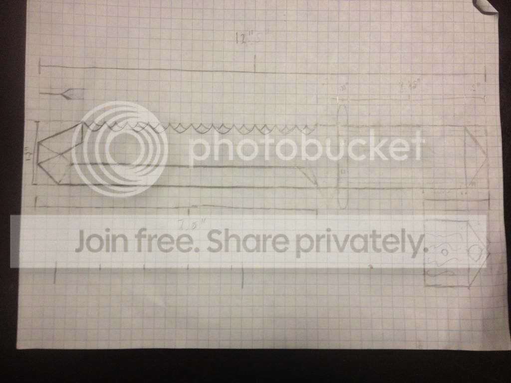

Hello everyone, I am new here and to be honest new to high quality knives. I am in the planning phase of my custom Explosive Ordnance Disposal (EOD) digging knife. It's main purpose will be to dig/ pry munitions out of the ground.
My choice of steel for the first attempt is ats-34 @ 59HRC and if it goes well I may do it again out of a s-30v or whatever y'all recommend for prying strength.
I will be having Texas knife makers supply do the heat treating and tempering.
Here is a picture of the knife. Everything from the guard forward is to scale but the paper is not quite long enough to get the whole thing.
I won't be using it on anything that requires the use of non-ferrous tools. But thanks for the suggestion! I have beryllium tools for those jobs.

I'm curious how you're going to "do" (I suppose I mean cut) the saw teeth? Those look like they'd be challenging unless you're CNCing this sucker. I also wonder what you need sawteeth for on an EOD digging tool?
Are the grinds chisel grinds? If not, what are they and what angles are you thinking about? If the knife is .25' thick and 1.5" wide the primary bevel is going to be hellaciously thick and a pain to sharpen.
How thick is this EOD tool gonna be? Would you be hollowing it out on the obverse side?
How big are the EODs it's gonna be used to dig up?
The handle looks uncomfortably straight. Is there a reason you haven't contoured it some? Ohhhhh, oh, what is the handle going to be made of and how're you gonna attach it?
Does the tang get drilled out to diminish the weight, and improve the balance, of this tool? Why have a skull crusher on this?
I'm think an S7 or D5 might be the ticket for the 2nd version given the licking you plan on giving this knife.

I had planed on doing them with a .25" chainsaw file. The purpose is for roots and grass. Most ordnance has been in the ground for 10+ years before we find it.
I don't think I'm following what you mean here. I planed on the cutting edge at a. 25* bevel. The knife does not need to be able to cut paper just dirt.
.25"", and no it will be solid.
How big are the (munitions) it's gonna be used to dig up?
Ranging anywhere from 30mm to 120mm thick and weighing 10-50lbs.
I left the handle straight simply because I'm new to making knives and have limited tools. Ergonomics are not a big deal as long as it's functional. I planned on using .25" thick G10 attached with .25" hollow brass pins and adhesive.
Negative , I left it solid for structural purposes, I'm open to suggestion here if I should Balance it? The skull crusher serves as a window breaker.

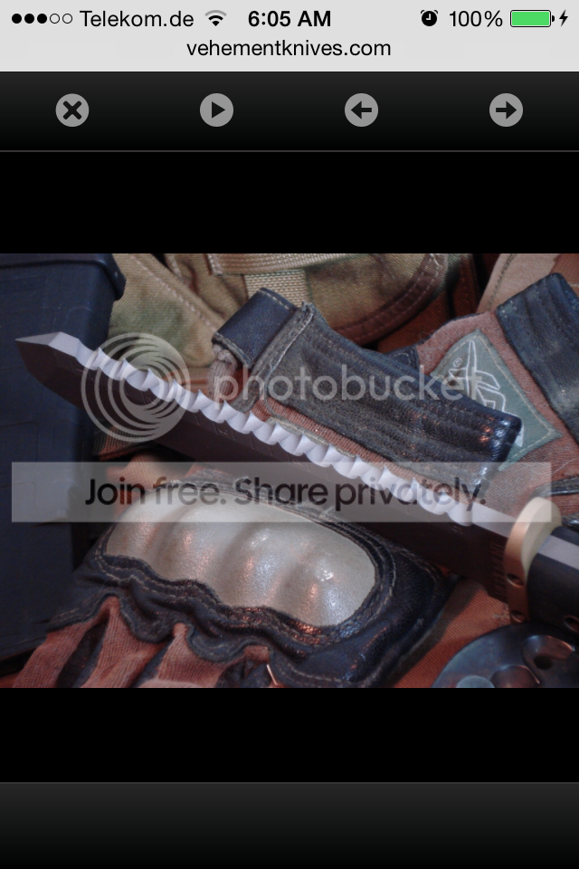

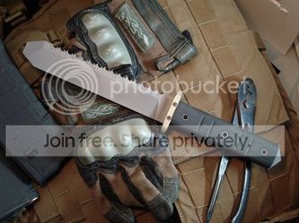

This was the knife that motivated my design...

Ergonomics are a big deal, especially in a case like this where the user may be working with the tool for large blocks of time. The better designed it is for using, the longer it can be used without causing strain. As well, the less time it is required to be used since it become economical in use. yes a plain straight handle will work but if you know how the tool is normally used, you can design a more functional fit.
You know what you need for your intended purpose best. My only comment would be to reconsider the window breaker point on the tang. In my imaginary knowledge of digging up ordinance, I could envision a need to push on the end of the handle, either as a means to push-penetrate soil/roots or in an attempt to pry a heavy object. The point on the end would likely make that a bit uncomfortable

Not sure if you are using the phrase "motivated my design" properly. I am surprised no one noticed this earlier, but reading through this post, it is obvious that the photos you posted are straight from the pages of Vehement Knives and your sketches are a blatant ripoff of their EOD/UXO Dig Knife here:
http://vehementknives.com/eoduxo.html
Not only that, but if you read their "About Us" section, their owner Matt is a trained/licensed bomb tech who has worked for years in the field and obviously put some serious thought and field testing into his design, which is extremely unique and customized for the job. Everything from your geometry and bevels to the window breaker and root saw is straight from their design.
Forums like this are a place to get inspiration and feedback on YOUR OWN designs and ideas. I suggest you try to come up with something not taken from someone else. It is discouraging to come on here and see disrespect like this.
