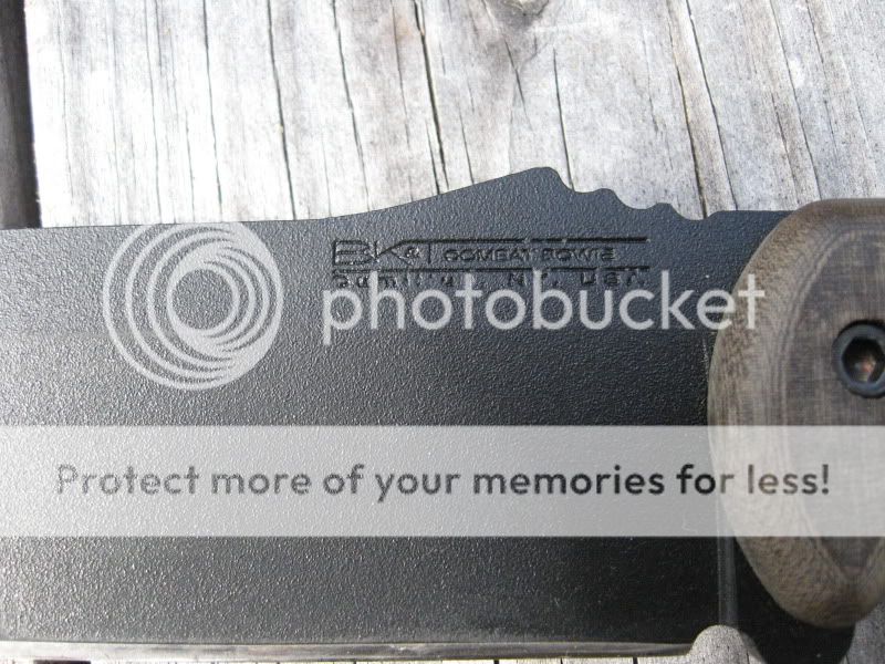

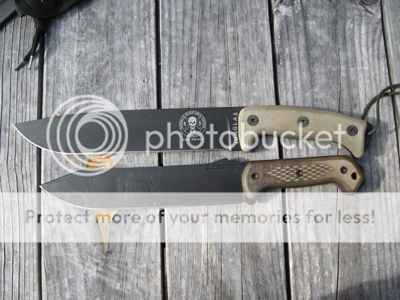

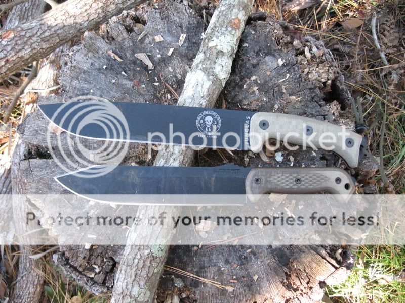

Recently a forum member asked me to compare the new Junglas with Becker's BK-9 Combat Bowie. My BK-9 is an older one made by Camillus in the famous 0170-6C steel, but Ka-Bar says the 1095 Cro-Van is essentially the same steel. The knife has not really changed since the Camillus days, so maybe this is a valid comparison. Also, I replaced the original grips on the Becker with micarta ones I bought directly from Camillus before they went under. I also sharpened the swedge (I don't know why). The original sheath is long gone, but the Cordura one I carry it in now is similar to the ones the new BK-9s come with.

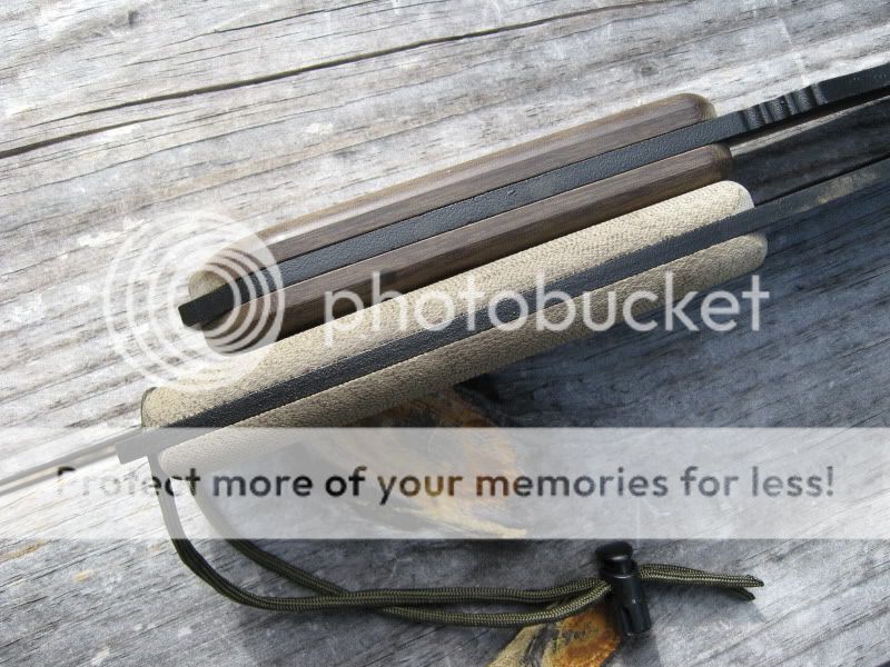

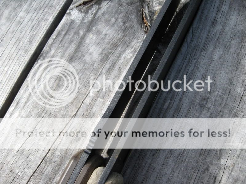

Both knives are nominally 3/16" thick, but my Becker appears to be just a little thicker than my Junglas.
The Junglas is a bigger knife overall at 16.5" compared to 14.75" for the BK-9. While the Becker has a 9.125" long blade, the Junglas blade is 10.375" long.
The Junglas is made from 1095 high carbon steel.

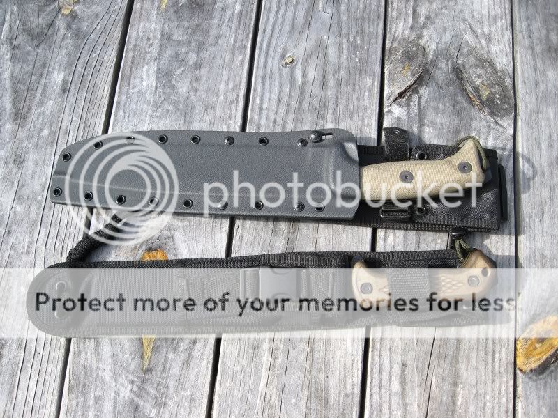

The Becker weighs 18.4 oz and the larger Junglas comes in at 22.4 oz. Right now, you can buy the BK-9 with sheath for $86.95 at Knife Center, but the Junglas will set you back $182.95. Part of the increased cost of the Junglas has to be the very nice Kydex/Cordura sheath and the well shaped micarta scales it comes with. With all that out of the way, time to take these choppers out back for some recreation.
THANK YOU! I had been wanting to see a side by side on these two.
The Junglas is exactly what it is: a 10" ESEE quality knife backed by the best warranty in the business. They could have gone cheap on the sheath, but they didn't. The Junglas can be found cheaper other places, and for the price you can find it at, that knife is a bargain. I don't know why I don't have one yet, probably because I put part of that knife money toward a Lite Machete back in April.
The Becker is a bargain. It's quite affordable for a knife of that size, but to sell a knife at that price, you have to take some shortcuts and that shortcut is the sheath. The Junglas sheath blows it out of the water.

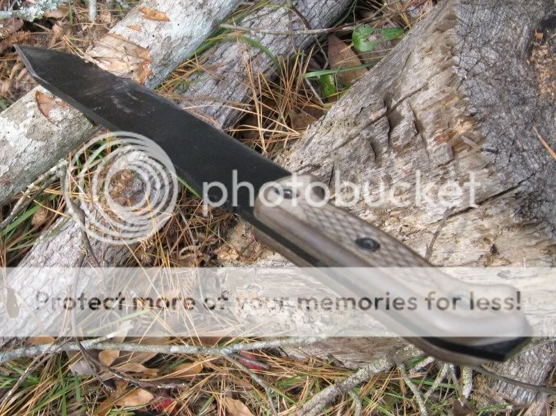

Both knives are light and lively in the hand, balancing just in front of the handles. The angled, contoured Junglas feels a little better to me, but I have no complaints with either handle.

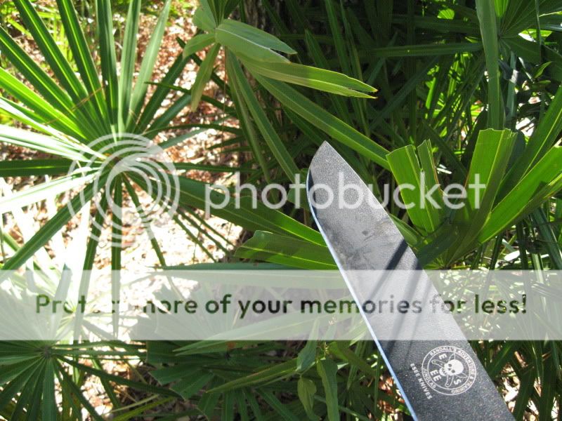

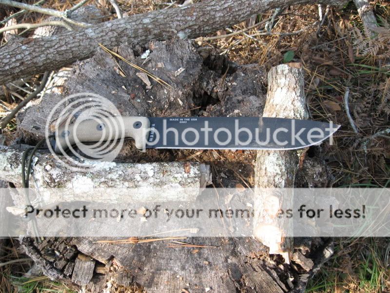

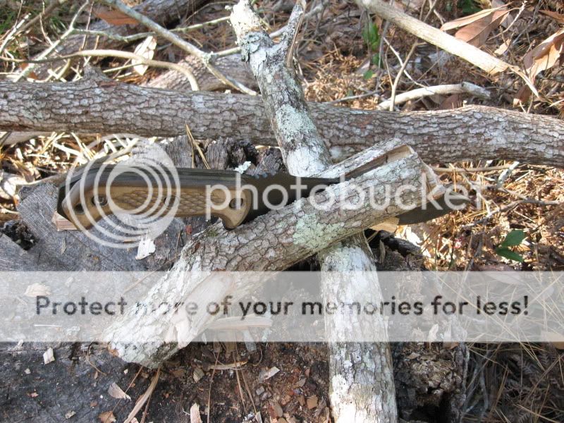

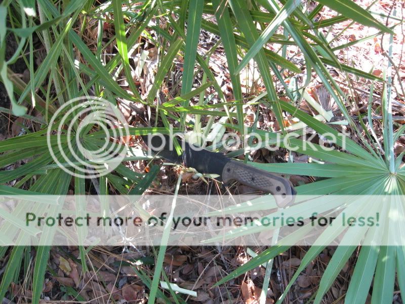

I did some palmetto slashing with both knives. Both are plenty sharp, but the added reach of the Junglas made it easier to use as a machete. It would slice the leaves cleaner than the Becker. Both knives will work as short machetes.

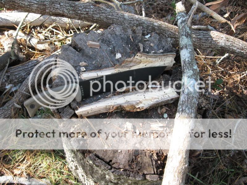

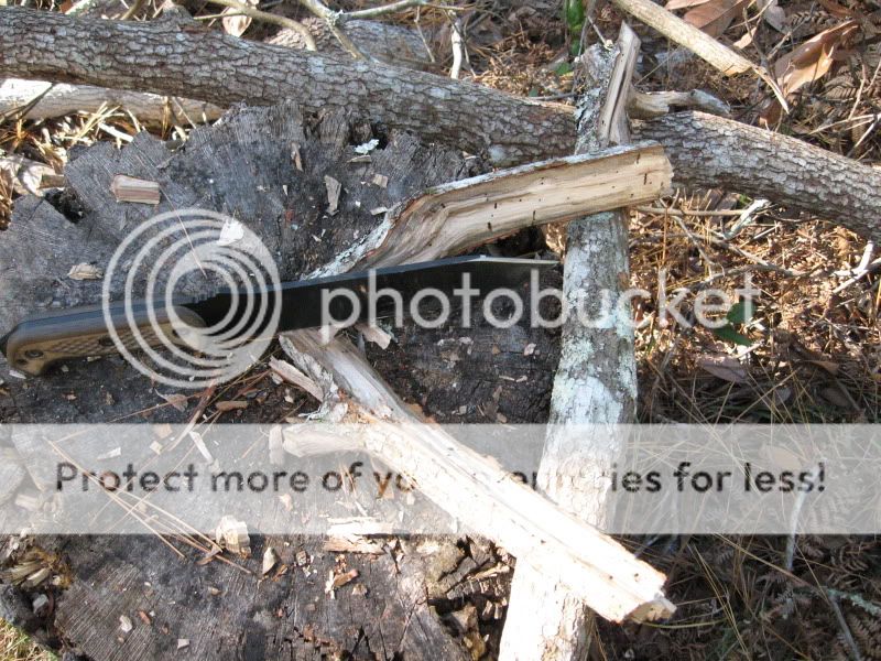

I split some wood with both knives using a baton. Both can take quite a beating with no ill effects. I have used the Becker for years and it has proven to be a very tough knife.

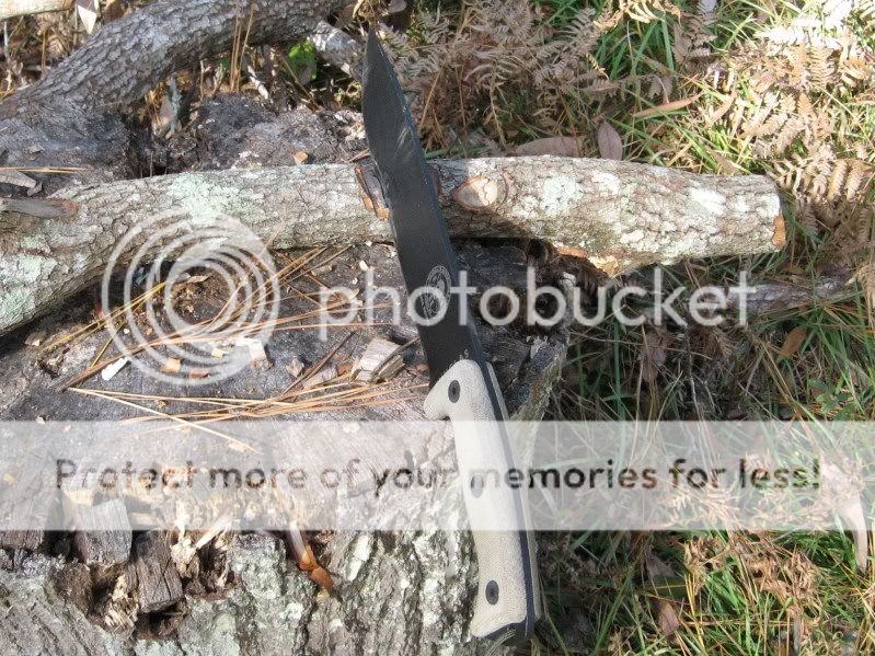

Both chopped well, but the Junglas was more comfortable for me to chop with. The larger handle helped and the bigger blade chopped through the dry hard wood in fewer chops than the Becker, but both performed well, as I knew they would.

I have wondered the same thing. My BK-9 is most definitely thicker than the Junglas. I could be mistaken, but the number .21" keeps popping into my head as the thickness. But it has been a long time since I bought the Camillus Becker, and I could be wrong. It is a touch thicker than 3/16". All I have is a tape measure. In any case, I doubt that such a small difference in thickness between .1875" and .21" would make much of a difference in the performance of the BK-9s. It's like 1/32 of an inch.
