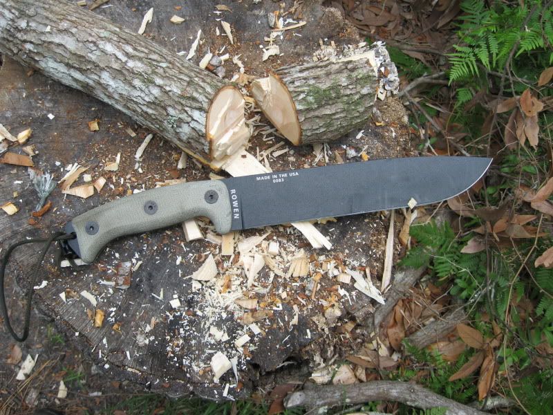

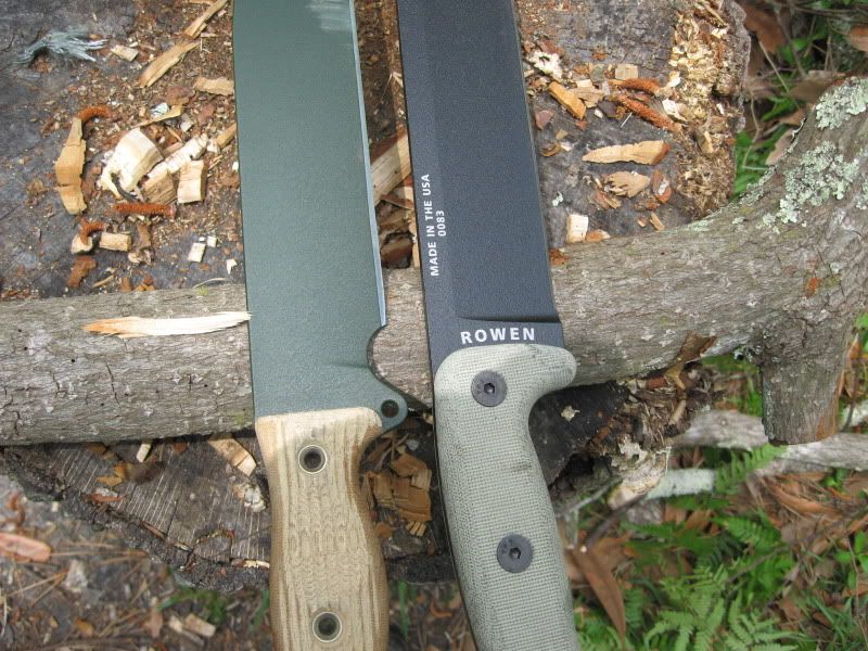

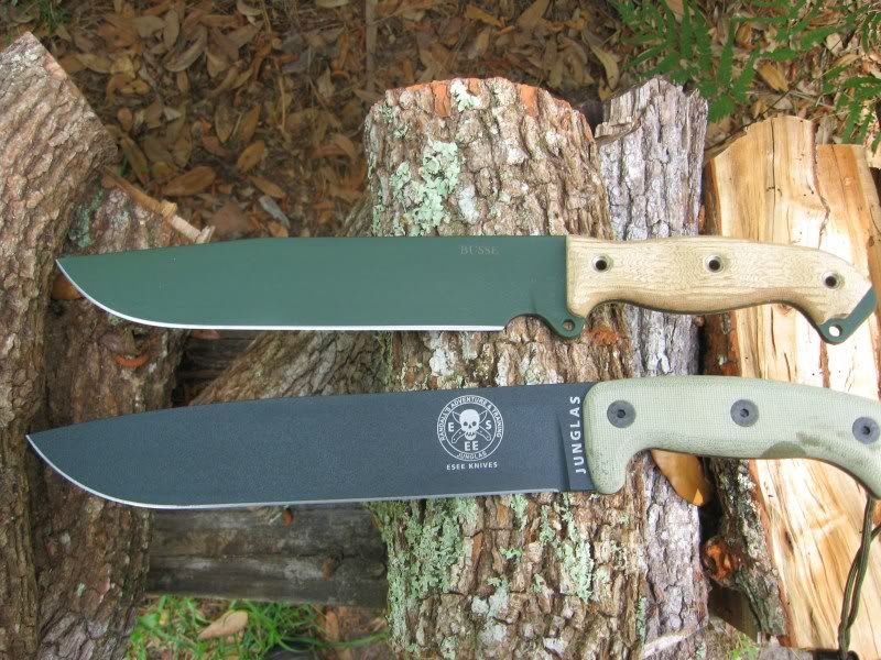

My new Junglas came in today. I have been wanting to compare this blade to the Busse Bushwacker Mistress. This is just a short comparison. These knives are so similar in design and purpose, it's scary. Both weigh about 22 oz. Both have 10 1/2" long blades nearly 2" wide and 3/16" thick. Both have micarta handles. The Junglas has a high saber flat grind with a bevel edge. The Bushwacker has a convex grind with a bevel final edge.

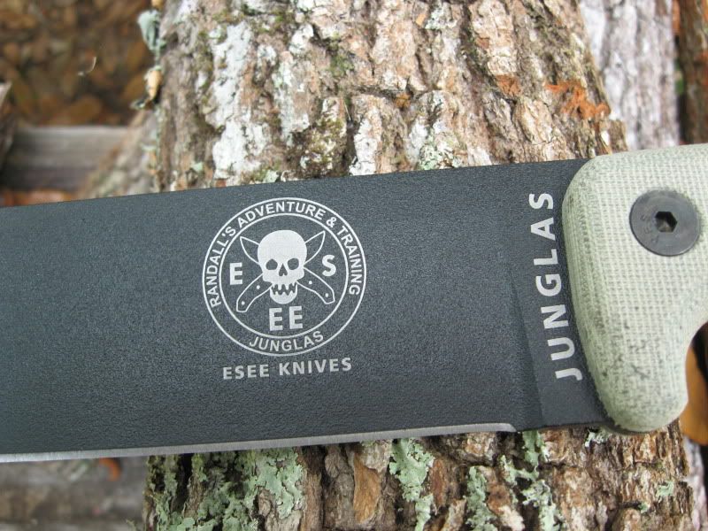

Fit and finish on the ESEE was every bit as good as on the Busse. Handles are flush with the tang. The Junglas has a very sharp edge right from the factory. The Busse, while not dull, did not come as sharp.

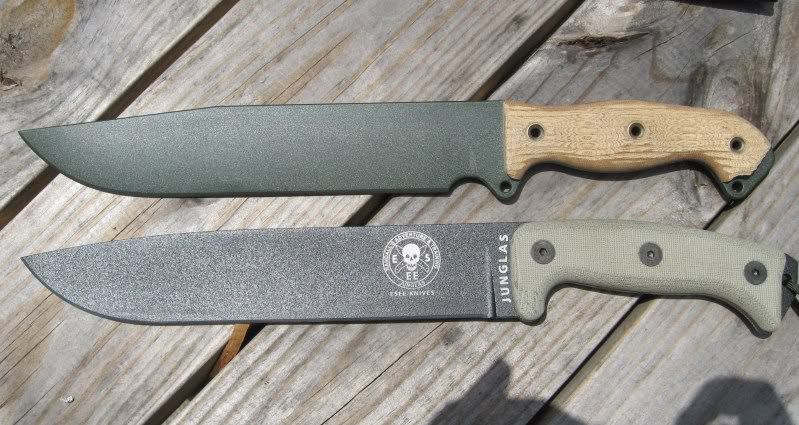

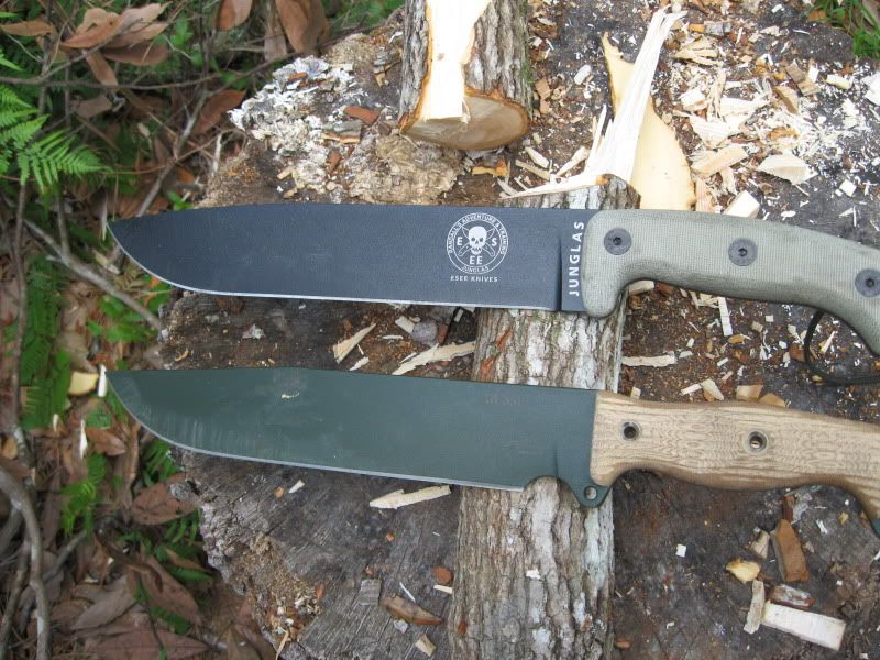

When you use them back to back, the first thing you notice is that the Junglas feels lighter and faster in the hand. It also has a more hand filling handle than the Busse, but I found both to be quite comfortable in use. Below, you can see that the balance points on the knives are different. The Junglas balances right at the blade/handle junction, while the Bushwacker balances about 1.5" forward of the scales, for a more blade heavy feel.

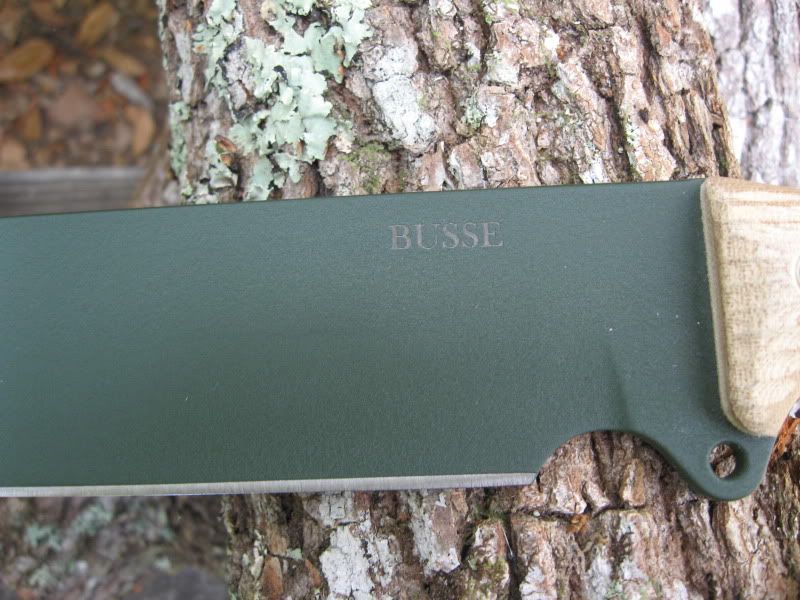

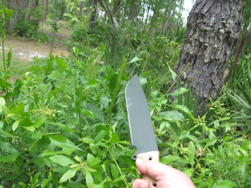

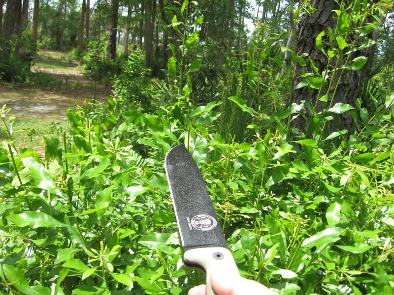

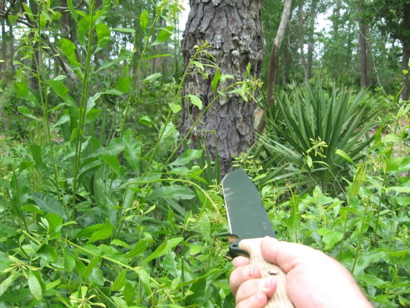

Also, the Busse has a large choil, while the ESEE has none. In use, the Junglas is very efficient for snap cuts on standing vegetation
The Busse did not do as well at this, but that is as much a function of the final edge than the balance. I know this because I have another Bushwacker with a full convex zero edge I put on it, and it does fine. But with factory edges, the Junglas slashes vegetation better, and it is faster in the hand.

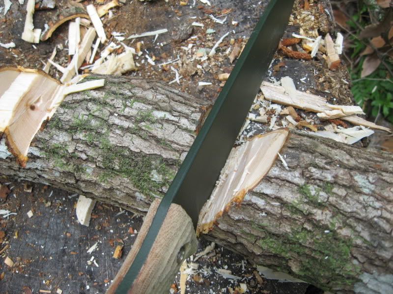

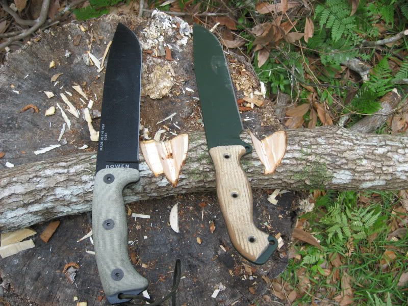

Next, a little chopping.

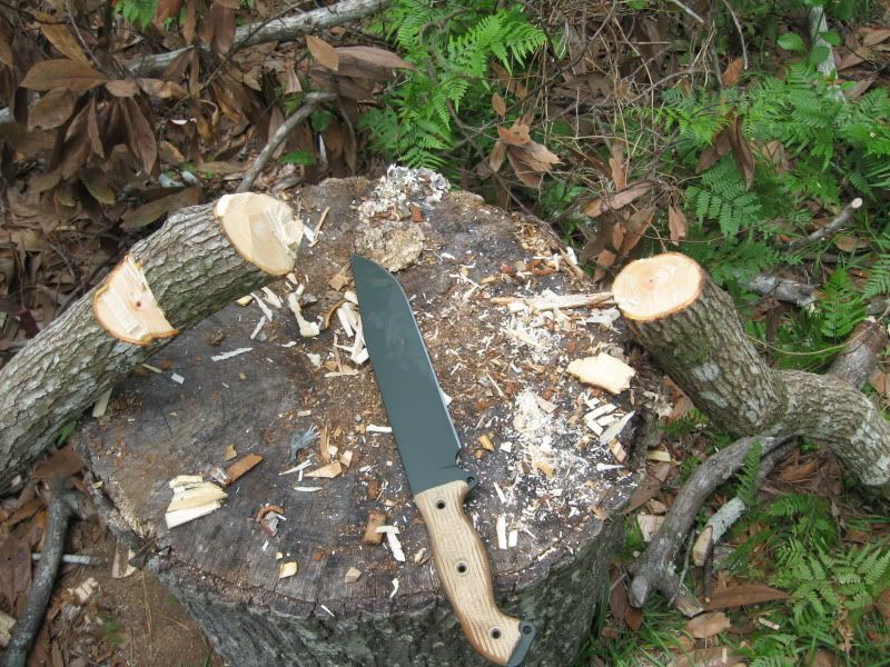

In chopping wood, the differences were not as noticeable. They chopped about the same as near as I could tell. Maybe the slightly more blade heavy feel made the Busse an easier chopper, but then the Junglas is sharper. It pretty much evened out.

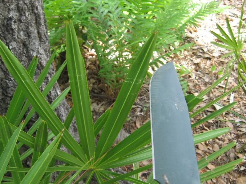

After some chopping, I slashed some palmetto leaves. One of the tests I use for machetes is slashing standing palmetto leaves. A good sharp one will cut them clean. And the Junglas did it beautifully.

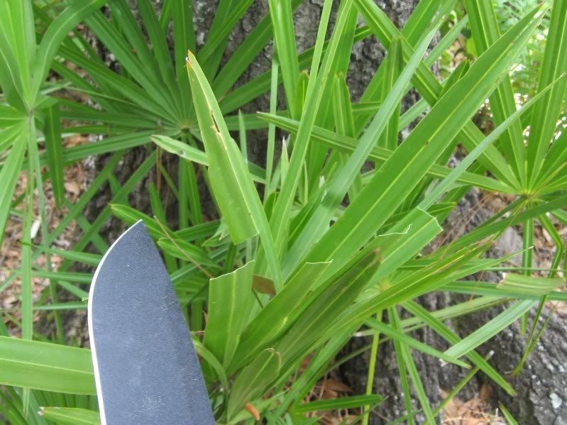

The Bushwacker scratched the leaves, but did not slice them cleanly. Of course, I can fix that in a few minutes on my belt sander, but this is how they did with factory edges.

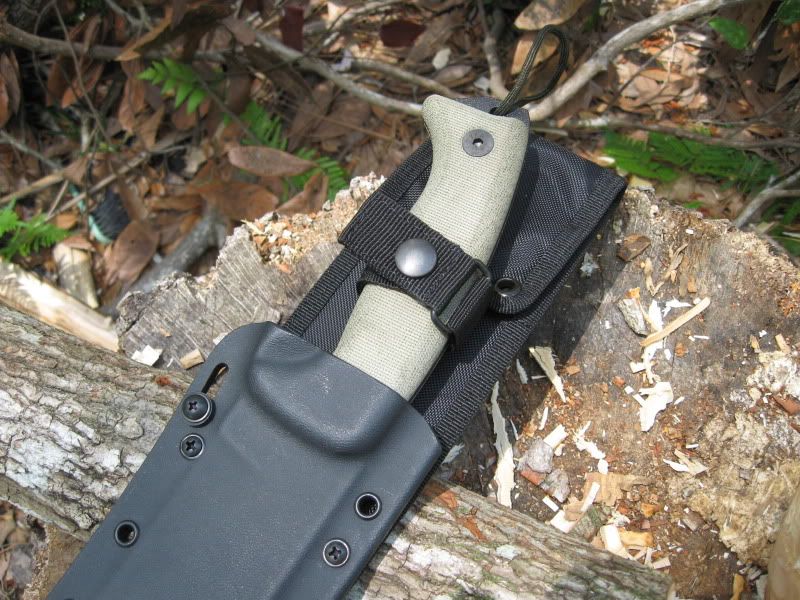

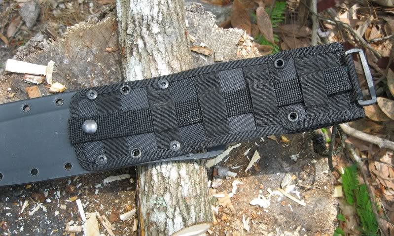

The Junglas came with a great sheath, as has been noted by others. For my uses, I doubt that it even needs the handle strap, but for those hanging upside down on Jeff's rope bridges, it adds some extra security.
The MOLLE back is good for those using military style gear. The drop down loop is handy for leg carry if you're wearing body armor, which most of us will never do. I plan to do a more extensive review later. It's not like I am running out of stuff to chop. I do not do "destruction" testing, but I am guessing the INFI is tougher than 1095. For $200 more than the Junglas, I would hope so. For me, well tempered 1095 has always worked fine with good edge retention, reasonable toughness, and easy sharpening. I just buy those Busses because I like them, I guess. They are some fine knives. But in bang for the buck, these ESEE blades work just fine for me. In summary, this new Junglas looks like a high quality jungle knife with better fit, finish, and ergonomics than its RTAK predecessors, and it is priced right.
