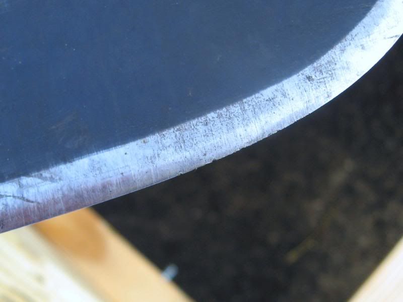

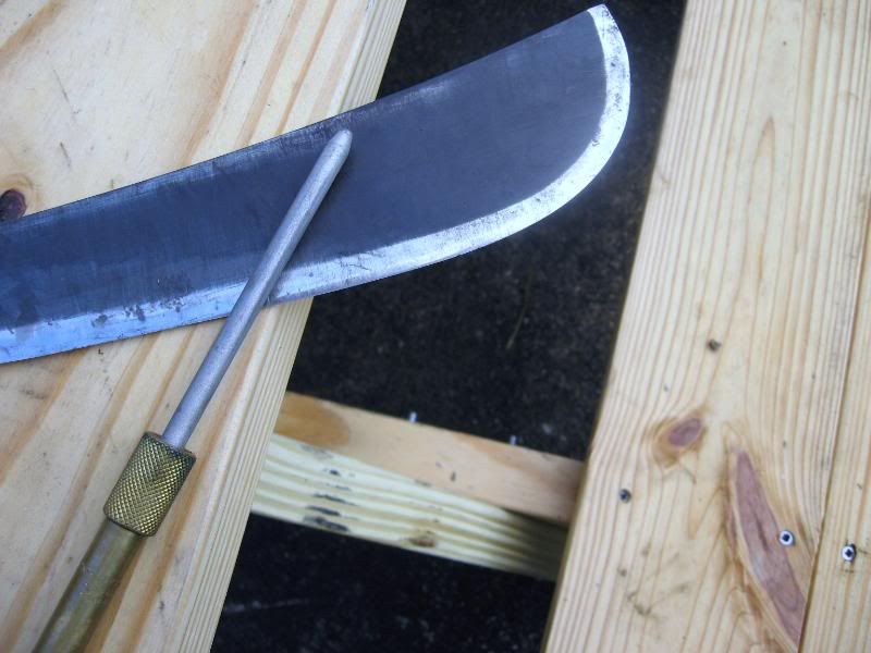

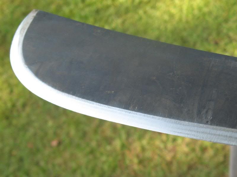

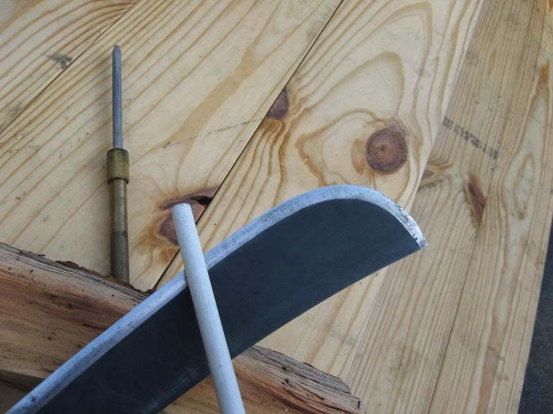

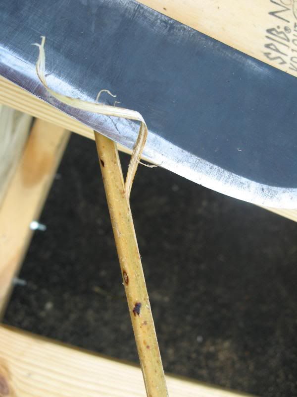

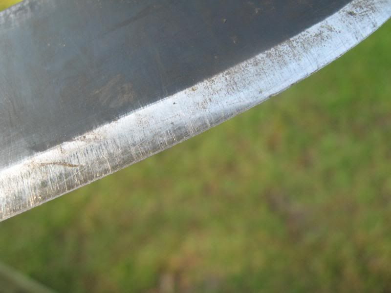

Machetes are rough use tools. I have a Condor Golok Machete that is the same steel and convex grind the new Lite machete will have. While splitting some wood for a recent oyster roast, I accidentally struck the concrete patio with the edge.
No big deal. I just used my pocket diamond sharpener and straigtened it out.
I used a 99 cent ceramic rod to smooth the final edge, applying very light pressure as I stropped the edge.
The new edge was then sharp enough to cut curls on my palmetto weiner roasting skewer.
So the edge was plenty sharp to continue using at the oyster roast.
Later, I used a 400 grit belt to restore the nice convex edge. You can use a strop for this, but it will take a little longer.
These are machetes. Don't worry about some "perfect" profile. You can even use a file to sharpen one. Who cares if your convex grind has a bevel edge on it? It will still chop just fine.
