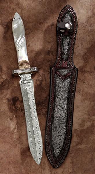

Mike when Lamont comes down with me to the H/I ask him , he does it all the time..on ss damasteel

all i can add Mike is that is how i etch my SS blades,for the patterns i do...works great!
