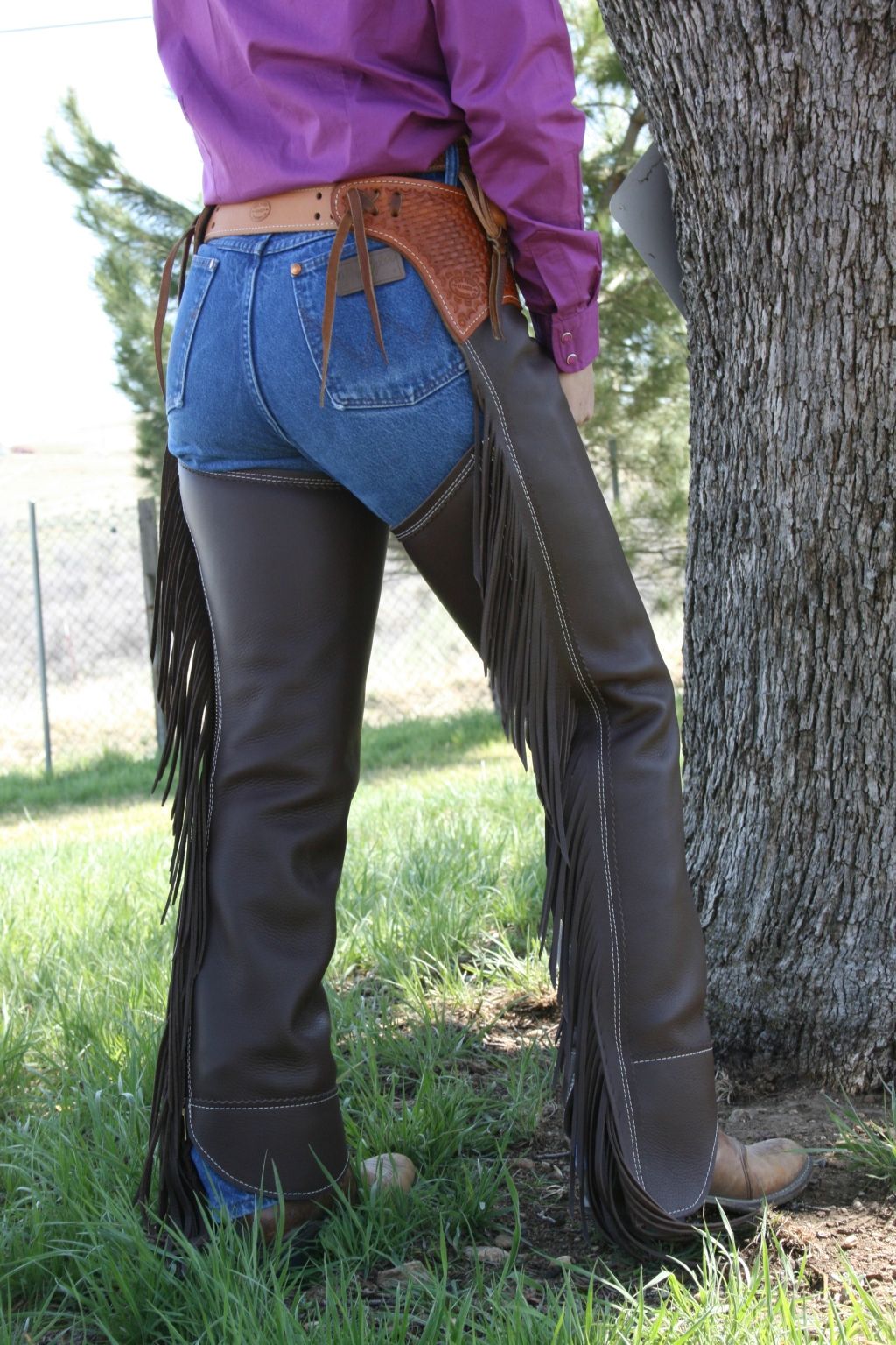

Jason that whole sheath rocks. Stitching is great! Very refined and elegant look. I have miles and miles of hand stitching under my belt (pardon the pun). I have to agree with Paul there comes a point where the idea of hand stitching becomes secondary to production. I can say this with with some emphasis as I have the ludicrous hand stitching t shirt. I once hand stitched a pair of shotgun chaps.
Not this pair but this pic gives ya an idea of how much stitching is involved in a pair of shotgun chaps. Yeah I did, I sewed a pair by hand one time. I'm crazy nuts I know.
But at the time it was a hobby, I wasn't trying to make money at it. Good thing cause the amount of stitching involved I was probably working for $0.15 an hour. I have made probably 250 pairs of these type of leggings and only hand sewn one and that ain't happening again.
