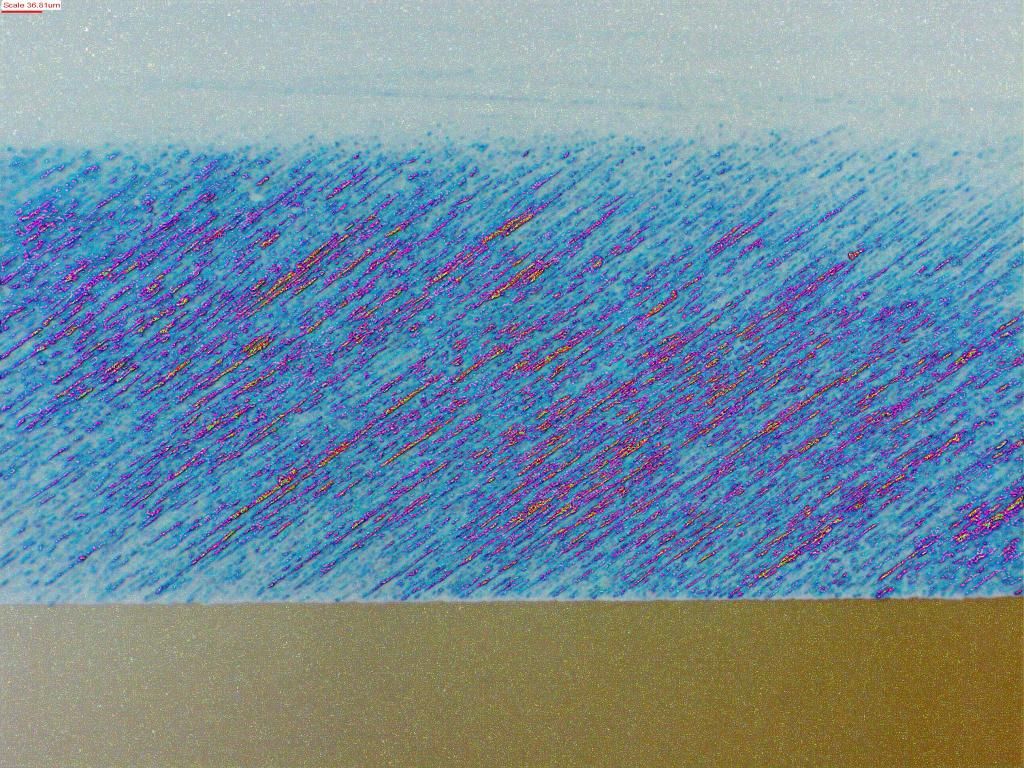

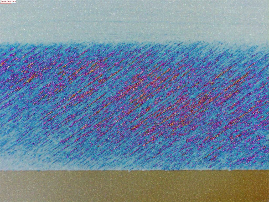

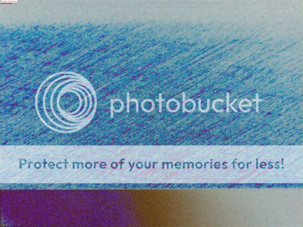

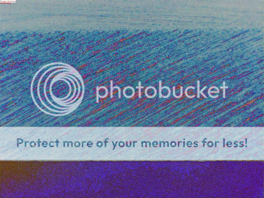

While not very scientific, here's some micrographs of edge convexing using wet/dry 600 or 800 grit (I can't recall which).
I compared it to a:
- DMT EF hone
- Razors's edge vitreous hone estimated at approx 800 grit
- wet/dry over steel plate, all at approx 4 ozs, and
- wet/dry over Washboard at 8-12 ozs - I applied more pressure to handicap the WB, test the hypothesis that the interrupted peaks of the WB causes the same "hardening" of the wet/dry as it does with regular paper. It does, WB convex is similar to vitreous stone, maybe a touch more, but far less than wet/dry over steel plate at a fraction of the applied pressure.
Test knife was hollow grind with V bevel 420 hc steel. Pics at 40x with a "contour" feature applied to highlight the shift.
DMT
Razor's Edge
Steel plate wet/dry
And Washboard
If I think of anything else I'll add it in. Bottomline, the biggest drawback is the convexing induced by paper formation under the abrasive layer - if not taken into account you can wind up making the apex more broad than you might intend.

I'm not used to such graphics - so let me know if I interpret them properly. Purple and yellow indicate deeper scratches, whereas gray and blue are shallower areas?
So the fewer purple and yellow is better? And if it is there, the scratch should meet the apex?
By that criteria, DMT is best, and WashBoard is better than the steel plate. And the Razor's Edge is slightly better than the WashBoard.
(Restricted to this sample, obviously)
Did I get that right?

Pretty much. They indicate more contrast, so deeper scratches and/or greater shift of surface relative to the light source. The DMT has an unfair advantage being a much smaller scratch, but its clear it also has less overall surface shift too. Being a hard plate and smaller abrasive, that's the control image.
