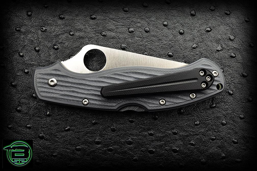

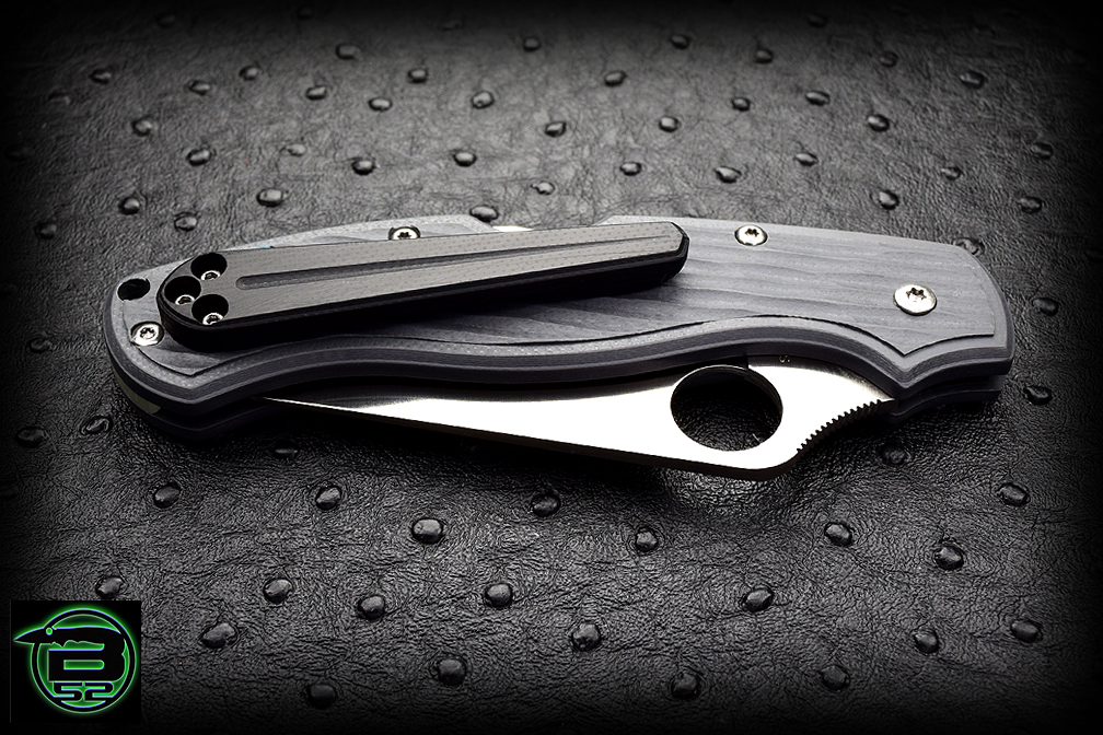

I've been heavily involved recently with the design and machining of full length carbon fiber back spacers for the CRK small Sebenza and Insingo knives. One member that purchased one of my back spacers posted some nice photos of his back spacer installed on his knife. The picture was of the clip side and he had a really nice looking sculpted pocket clip. I inquired where he got the clip and was told it was a MILLIT Knives product.
So... I thought to play a bit and see if I could machine a sculpted pocket clip for some of the production folders I machine scales for... primarily the Spyderco knives.
After creating the G-code file I needed to actually mill one so I can get a better handle on form and function and material capabilities... i.e. carbon fiber and G10.

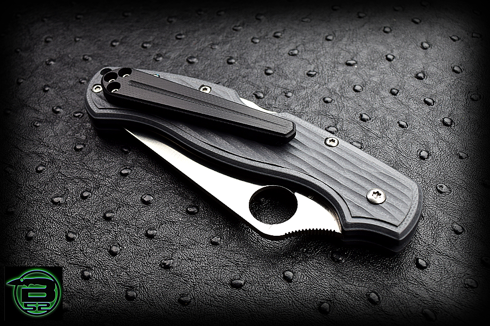

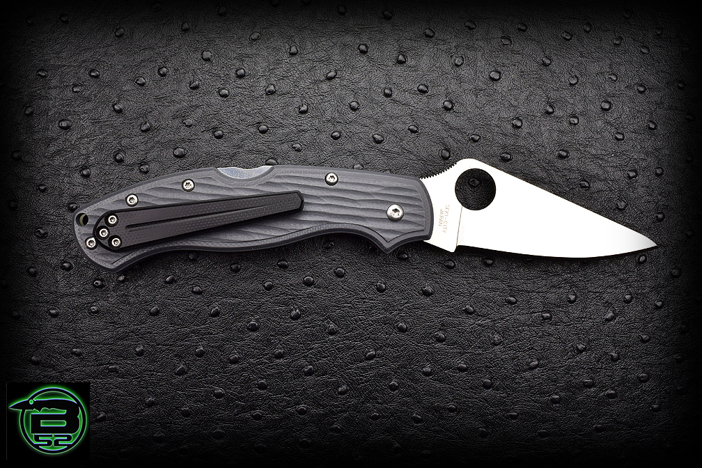

The photos are of the MK1 prototype machined in black G10 and installed on a Delica/Lil'Para.

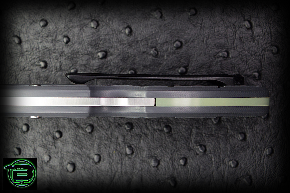

Right off the bat it is apparent that the pocket clip is much too tall or thick. The demonstrated G10 stiffness is such that I'm thinking I can reduce the thickness by 35-40%. I also need to address the relief chamfer at the clip tip for easier catchment of the pockets fabric edge. Retention strength isn't lacking... in fact it is overly strong.
Other than that... I think the idea and design is worth pursuing. More as it happens...

Haven't got to the point where I can evaluate ergos as yet. The MK1 was altogether too thick... by that I mean it stands off of the scale much farther than needed. I used G10 and not having a handle as yet on the flexural & strength characteristics I over engineered it. I'll thin the next one by about 40% and that will greatly reduce the profile height. THEN I'll look at the ergos...

My experience with G10 is that generally... it is a very stable, strong, and stiff material. Just my opinion... but given the short section arm for use in a pocket clip application I just can't foresee snapping that clip arm off. The force required would be considerable and it would also need to come from primarily one direction... that would be a levering force applied at the tip. There are always exceptions... but I think you would see something else fail before the clip snapped.

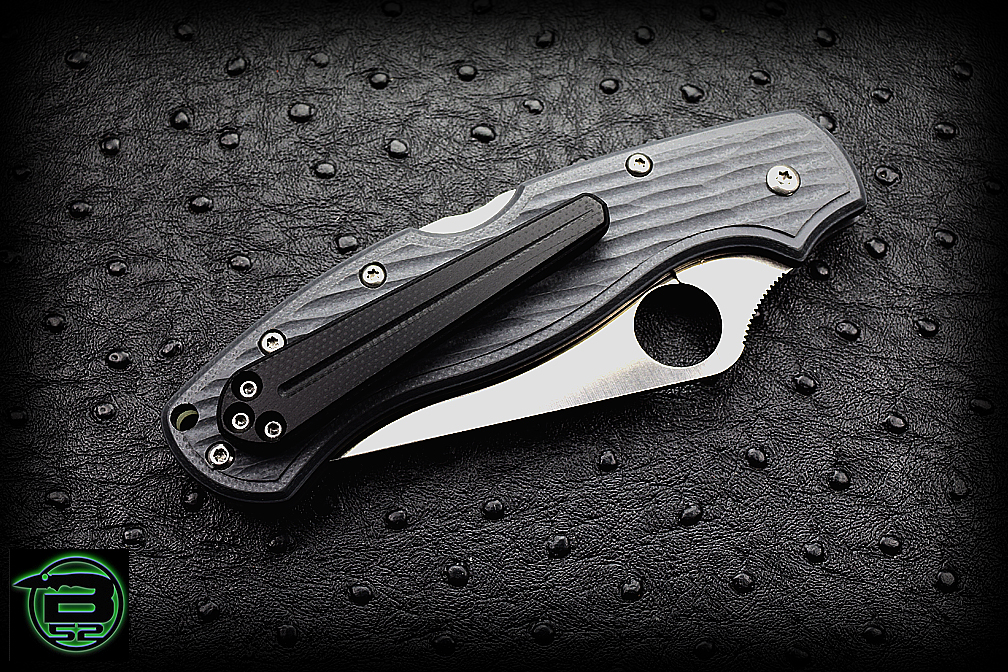

With the Nascar race postponed yesterday I went out and machined several more iterations of the G10 pocket clip... tweaking the design parameters with each one machined and tested.

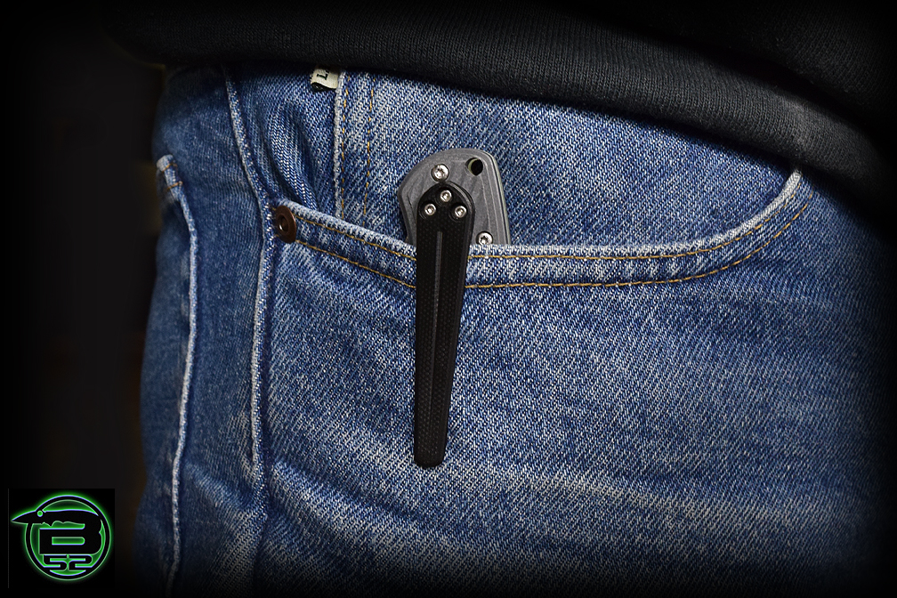

I believe I have now landed on a serviceable product. The MK1 prototype was greatly overbuilt. I ended up reducing the height/thickness by 50%... and the clip arm thickness by 40%. That was a surprise... I knew G10 was strong and stiff but this is the first time I have needed to tailor the flexural characteristics for an end result. As it stands now... this is clip number 5 and I think it looks great, feels great in the hand, and has great fabric retention.
Now I need to get one onto someone else knife and into their hand for some feedback.
