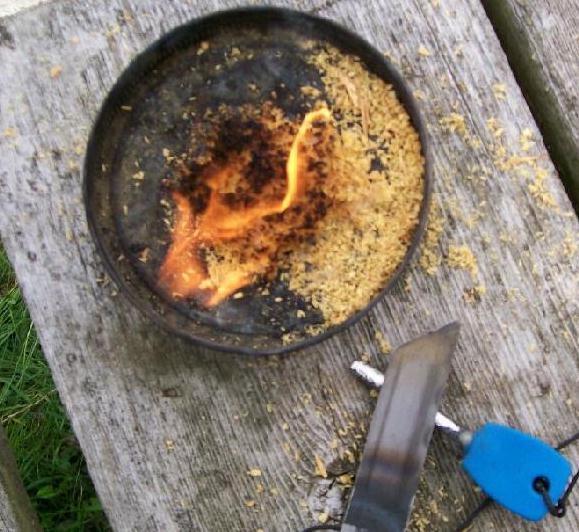

Ok did some quick experiments...
I ground up some fresh fatwood with the wood rasp...
Fatwood dust was slightly sticky and moist with resin...
The SWAK had nothing to do with the experiment, only to give everything some scale at to size.
I first used my Army model firesteel (orange handle), which is actually a Magfire, however the same firesteel as the Swedish. This firesteel I have a custom made scraper made from a piece of 3" industrial hacksaw blade.
It was slightly windy,so it took me a couple of trys to ignite.
Indoors or on a calm day I can get the fat wood to ignite usually on the first or second try. However it did ignite readily.

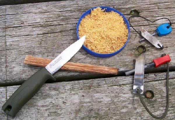

I then got fresh fatwood dust and tried it with my Scout model Swedish firesteel (blue handle) and old type scraper..
I got several small embers, however no ignition. I also used the new type scraper and still coudn't get ignition.(forgot to take pictures of the new style scraper)
I used my custom scraper and my Scout Firesteel, and after one or two trys I got a good strong ignition
So,, what it looks like is that it's the type of striker that is used which makes a big difference in whether or not you can get ignition for fatwood using the standard and supplied OEM scraper... I never thought of trying the Scout Firesteel with the back of the Mora.. This will be my next test...

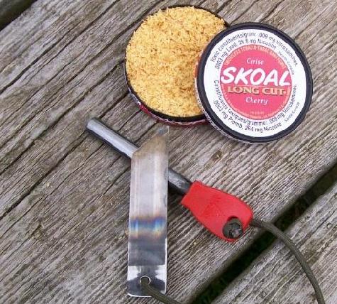

Went back out and tried the same experiment with the spine of the SWAK, which has been squared off on the 2 X 72. I guess next I need to try it on a stock untouched SWAK as a control.
I got ignition again on the 2nd or 3rd scrape from the SWAK without a problem.
In the upper right hand corner you can see the new OEM scraper that comes with the Light My Fire firesteel.
Rick had mentioned using Skoal containers to keep the fatwwod dust in.
If you know someone who Dips Skoal, have them save a few containers for you..
They are Excellent little containers to keep fatwood dust, or just about anything you can think of. It just so happens I have a bit of a habit, and keep my tins for just this sort of thing.
If you run some electrical tape around the edge when it's closed, you can pretty much seal the contents from the elements..A ranger band will also work very well...
