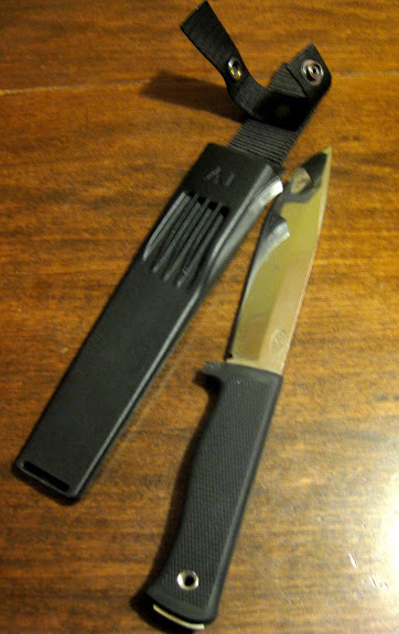

I'm wanting to make some custom F1 scales like the ones I made for my Becker BK2 :
From what I can see, the best thing to do would be to buy a complete thermorun handle and sheath rather than buying the blank.
My question is - are the rivet holes pre-drilled under the thermorun?

Thanks eonxbox360! Exactly what I was looking for. Any idea how hard it would be to drill through the tang with a drill press?
Marathonman
Marathonman
I would think it would be pretty easy if you get a drill bit that is made of harder steel than the steel of the F1.
I don't think it will be easy. Since the knife is hardened, so keep the cutting fluids at hand. and maybe buy a few extra drill bits. But i`m not a expert on drilling in new knives :D
Use high speed steel bit with alot of pressure and go slow, that should work fine... If worse come to worse, submerge the blade in water and heat the tang to draw the hardness out and try to drill again.
I've drilled through hardened steel before. Yes it takes time, and yes you do need cutting fluid, but it's not terribly hard. Tungsten carbide bit + cutting fluid should do the job.
HSS bits are weaker than carbides, but they may work as well. Actually they probably should work unless the bit is at the end of its lifespan.

you don't need to drill new holes,i used my A1 pretty hard without problems(handle is epoxied,and that's it),but cobalt or tungsten carbide bits,slow,not to hard pressure,with lot of cooling should make trough VG10.

I got it used,with damaged kraton handle,
so i striped handle and reground tang
Then i did same thing to S1(that thermorun handle was really too thin for my paws)
WM1 was blank..
So i created new line for myself,curly birch Fallknivens :D ,as for F1 i like the way they are.
