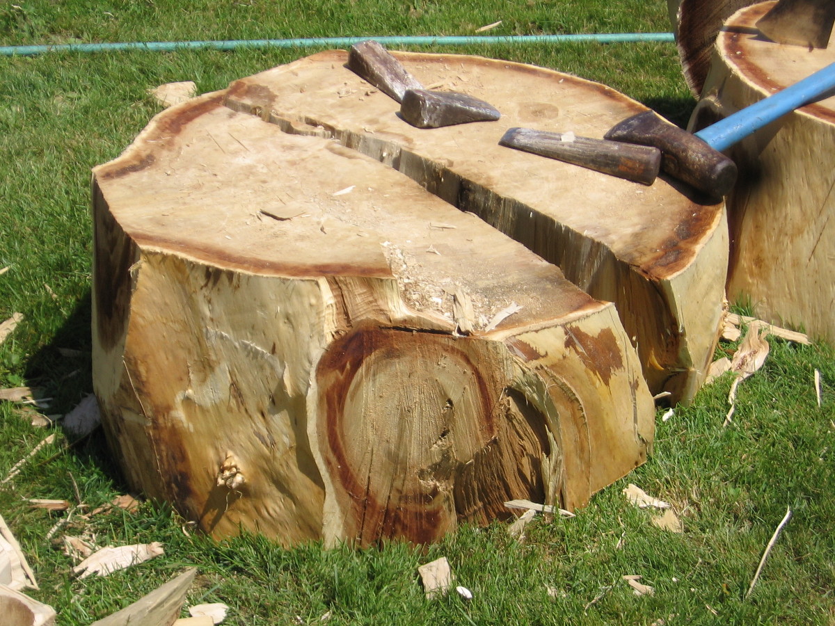

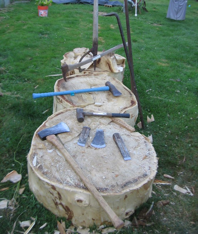

Examples of some wedge work. These are 36" rounds of black cottonwood with a twisted coarse intertwined grain. Axe or maul won't touch it. Note how I start with a pair of wedges close to the edge. Once it starts to pop open I drive a 3rd wedge in on the far side of the split.
You don't get nice straight splits out of this stuff. I try to plan my saw cuts through the largest branch crotches to make them easier to split.
After they split the intertwined grain still holds them together. I used that big wrecking bar to pry them open so I could cut those strings with an axe.
Dealing with a crotch. I split off the weak side first. Then I start 2 wedges on the near side wood directly centered on the crotch.
This was some gnarly stuff to split.
All split.
I have a wood grenade, got at a yard sale. Wasnt impressed. If I'm using wedges to split, which I'll admit I rarely do, it's as shown above.
