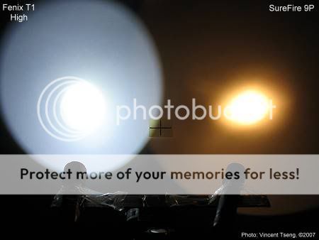

compared to the legendary SureFire 9P -
that's the 3x CR123 lithium xenon light (105 lumens) -
vs. SureFire 9P (3x CR123 xenon - P90 standard lamp)

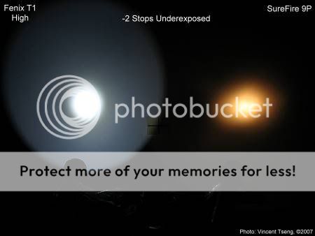

I would say the T1 is definitely brighter by a magnitude....
.... not convinced?
