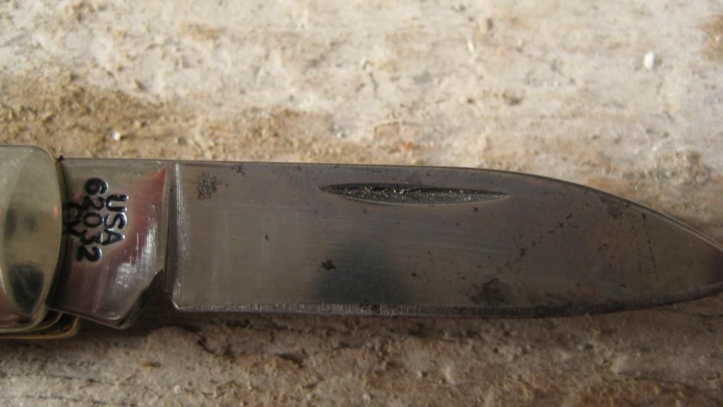

Hi guys!
I have a CASE knife I really like very much, but haven´t carried it much in past few months. It is the Texas Jack in Amber Bone and CV steel. So I carried it today for EDC. During a break at work I pulled it out and fondled a little with around - just for fun.
While I was cutting some small branchets I realised that there was pitting on the blade. At least it seems like this. It is a rough, round piece of black steel that looks like pitting. You can see it here in the upper left side of the pic of the blade
All the other black spots on there are from use, but that very one on upper left side is pitting, I think. When I go over it with my finger nail it is really rough and feels quite uneven. And it looks quite ugly, doesn´t it??
So what can I do to remove this and until it will eat deeper in the steel. Or would make any effect, at least?
I have to admit, that I have used to oil the blades when I put them away a longer time - I did this on this knife was well. I have no idea where this spot comes from. I really love that knife and carried it frequently- but I haven´t used the secondary blade that much, for a nice patina like on the mainblade!
So go and fetch your bukets with tar and the feathers :p :p
I know this shouldn´t have happened, but it did :(
This is pretty typical, and to be expected somewhat on CV blades; at least as compared to mine. An even patina can reduce the occurrance of them a little bit. I have a Case 6375 CV stockman (pic below), on which I patinated the clip and sheepfoot blades with a heated vinegar/water mix, and leaving the spey 'as is' for the sake of comparing how much difference the patina might make on the other two blades. I've noticed over time, the previously 'shiny' and unpatinated spey blade has accumulated a few 'rough' spots like you're seeing. I've also noticed this sort of spotting on my CV Peanut, which hasn't yet received a forced patina (that'll be fixed soon).
The spots can usually be minimized or scrubbed out with some metal polish, or some high-grit wet/dry sandpaper (maybe ~ 800+). After doing that, you might consider forcing a patina on the blade to even out the finish (some of the previous patina will be sanded or polished off). After that, might also oil the blades as you'd previously said you've done, if sweat or humidity is a bigger factor. I think sweat accounts for most of the spotting on mine, as they've turned up after I'd been carrying the knife in-pocket, in more humid seasons here.
(...and no tar & feathers necessary for you, Andi. Stuff just happens sometimes. :))

Thanks for the kind replie, David.
I almost thought about using some sandpaper or metal polish. When my Peanut was found after some weeks in a wet shag during autumn, it worked.
I´ve almost tried if you could remove it with some oil. But w/o success.
I want to be honest. I´ve never had the problem with pitting on any of my blades. But now I know how it looks like. :(

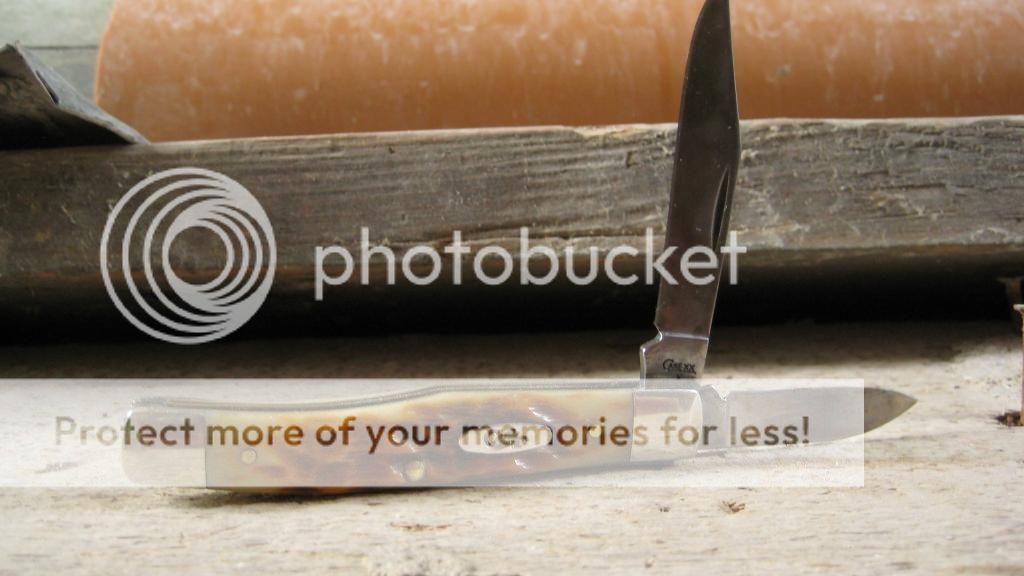

That's a great looking knife! I really like the bolsters and the scales! It looks like you've taken good care of it!
Thanks for the thoughts on cleaning up CV! I've got a yellow stockman too and in this humid climate they get a little rusty!
That's just character, Andi. Traditional knives just do that, and it looks fine. :thumbup::thumbup:
