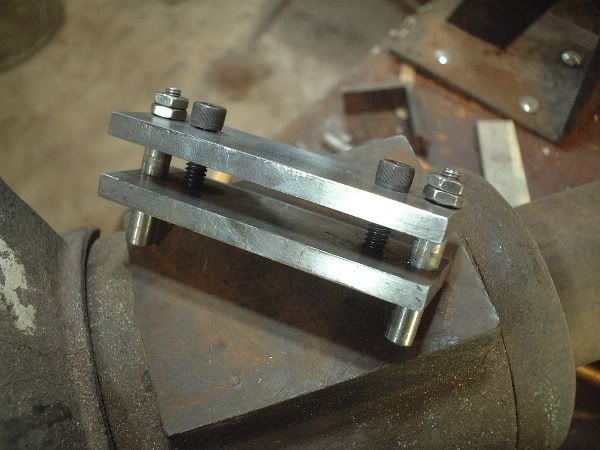

Maybe this will help -
The pins so closely fit their respective holes, that unless they travel the pins simultaneously, the outfit won't go together. that way, I know the edges are on the same plane.
Screws alone allow too much slop.
This is only 5/16 O1 - I wish I had had some 1/2" when I made it. The thicker the stock of both guide material AND pins the better.
And by the way, I've filed maybe 40 knives on that so far and you will see hardly a scratch! I fully hardened the O1 and only gave it about a 350 temper just to remove a little brittleness and keep it as hard as I could.

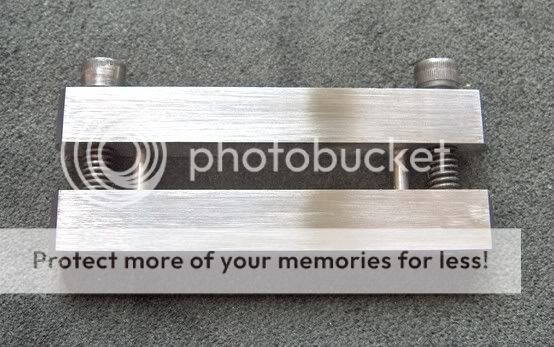

Those springs are a great idea! If they compress to the thickness of the blade.
Nice and thick, too. I like that.

karl, i dont think thoes are springs if you are talking about the ones b finnigan made. you are seeing the threads from the cap screws i do believe

I can only speak for the way I did it.
I used 5/16" O1 pins and plate.
I turned a 10-32 thread on each pin. Drilled a .185" diameter hole through both plates clamped together. Then, on the inside face, counter-sunk the
.185" hole to 5/16" so the pin shoulder could sit inside.
While they were still clamped up, I also drilled the 1/4-20 tap hole size through both plates. Then, enlarged the pass-through hole in the top plate to .250.
Then enlarged the .185" hole on the bottom plate to 5/16".
Chamfered hole corners.
Hardened.
Surface ground faces.
actually i thought about putting springs on the first one i made but decided they werent needed. the threads do look like springs in that picture though so its an honest mistake. a good optical illusion:D

Karl, I was looking at all the photo links myself trying to find which one had springs.:D I am not that creative, but it might be a good idea.
