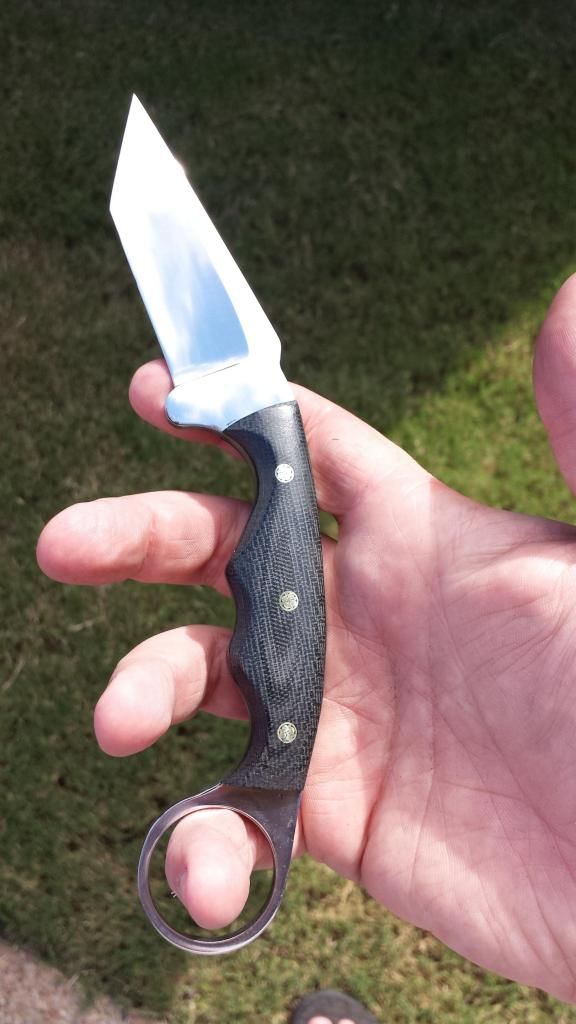

I’ve made several knives with finger rings out of O-1 Tools steel. I have yet to find a way to get the hole in them without trouble. I use 3/16 thick O-1 and put a 1" hole. Anyone got a tool or trick they use, I am looking at possibly getting a 4 flute end mill bit for my drill press, the ones I’ve seen are High speed and I usually run my drill bits or stair step bits slow with lots of coolant to keep it from hardening the O-1(which doesn’t seem to work with the stair step bit). I just have several to do and would like a more stable way of doing it, any help would be great.
I put the ring hole in this one using a dimond hole saw for granite counter tops, it took forever and isnt a viable option...

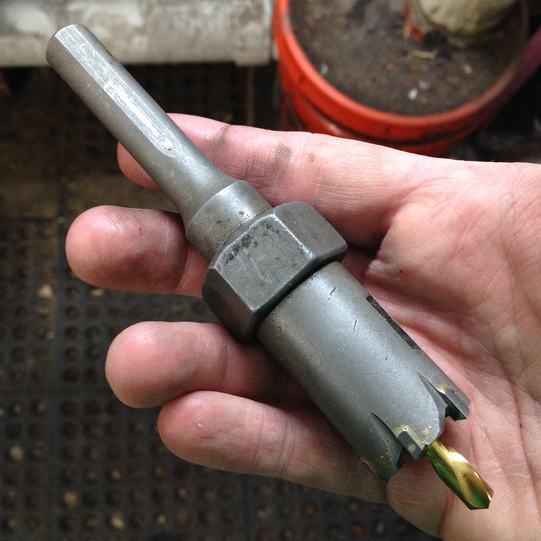

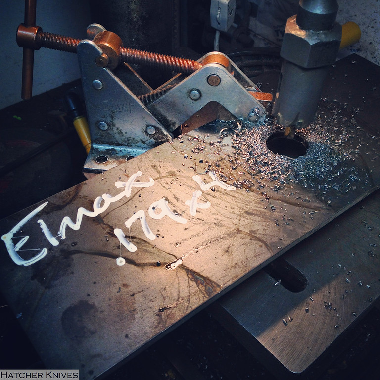

I've used this 1" carbide-tooth holesaw from McMaster to drill dozens of holes in O1, CPM154, 3V, S35VN, Elmax, etc.
Thanks for the reply's. Ive tried the step bits and the Bi-metal hole saws and they work but with limited life. I make most one off after drawing it up for the person so water jetting inst really an option as its only reasonably priced when you get multiple done. I am ordering the carbide bit suggested i think that would give me a bunch of holes before wearing out. thanks again for the responses...
Shawn what speed did you run it and did you use any coolants or water? I ordered one yesterday..
I generally run it at 390 or 510 RPMs. I will generally stop and spray it every 10-20 seconds with whatever I have handy to keep it cool. If you have a cheap press like me, be sure and check the top nut above your pulleys as it tends to loosen and it'll decrease the torque you have available. Also, I always drill 1" holes before profiling . . . much less stressful that way. :)
