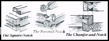

One of the big decisions you’ll have to make when setting out to build your log cabin is what sort of joint to use at the corners of your structure. There are various options from the square notch to the simple notch, all with varying degrees of difficulty. Every single one of these techniques is perfectly attainable with determination and a sharp axe.
Any of the techniques in the illustration above will work, but the chamfer and notch approach has three slight advantages. Firstly, it’s stronger and more secure. Secondly, the sloping bevels allows the joint to shed the rain. Thirdly, it is the most beautiful of the three. And if you’re doing this for the sheer joie de vivre of the thing, then notching and chamfering presents the biggest technical challenge.

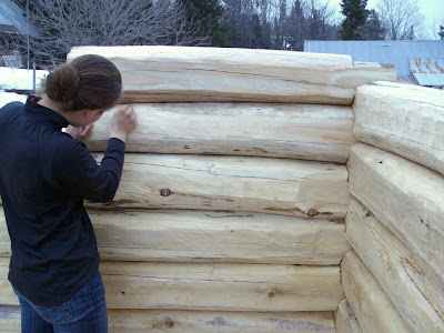

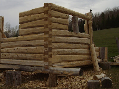

Steve, I was hoping you would show up. The pictures your cabin construction was was the inspiration for my original post. Correct me if I'm not seeing this correctly, but it looks like you've gone for the full dovetail joint in that picture?

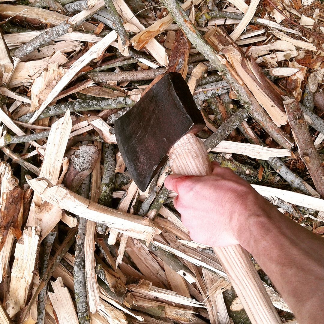

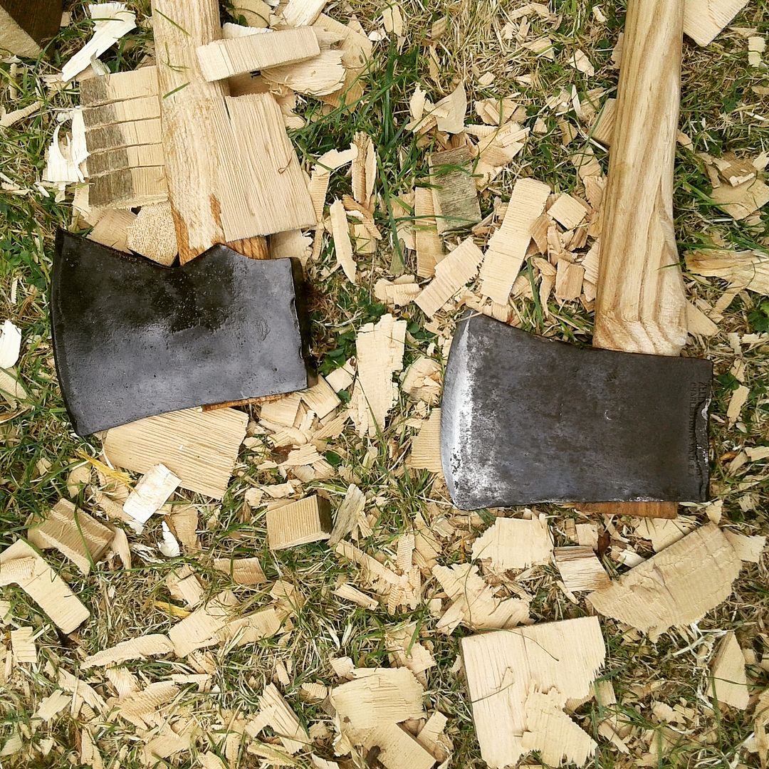

I just realised that I forgot to include any photos of the actual axes. As well as the ones pictured, I was also using a boy's axe.

That's not my cabin, I guess I should have been more clear that Peter Vido and his daughter were building it in Canada, and he sent me the photos to post here since they don't have high-speed internet. She's a member of this forum and occasionally makes posts here.

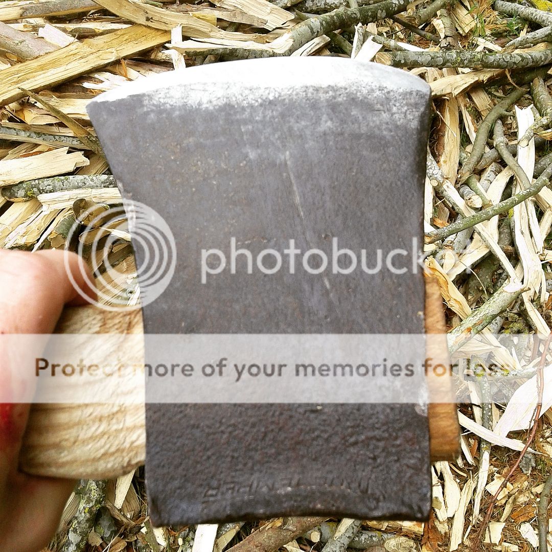

Thanks for sharing those- seems you work like I do, I cannot seem to break a sweat without bleeding as well!! LOL
That looks like a nice Belknap Jesrey. ;)

The illustration you show looks like it came from one of Eric Sloane's books. Sloane's art work is great but he was often incorrect on his descriptions. The log notch you are using is called the half dovetail and is an excellent notch. In my opinion the only log notch that is better is the full dovetail or compound dovetail. A Plumb 2 1/4 lb boys axe with a 18-20" handle is my favorite log notching tool.

Bill, I don't consider myself to have done any work unless I have at least one minor flesh wound. Yes, it is a lovely Belknapp -- what sharp eyes you have! :p

Old Axeman, thankyou for pointing that out, I have now edited the title of the thread to properly reflect the correct terminology. I was also using a 2-1/4 lb boy's axe that wasn't featured in the pictures. It's my favourite weight of axe for the sort of things I like to get up to.

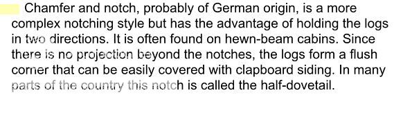

The author in your link uses those terms interchangeably. As this author as well.
From: https://books.google.com/books?id=j...R cabin OR corner "chamfer and notch"&f=false
I am leaning in the direction that "chamfer and notch" or "half-dovetail" would both be proper. I'm just trying to learn, so any comments are welcome.

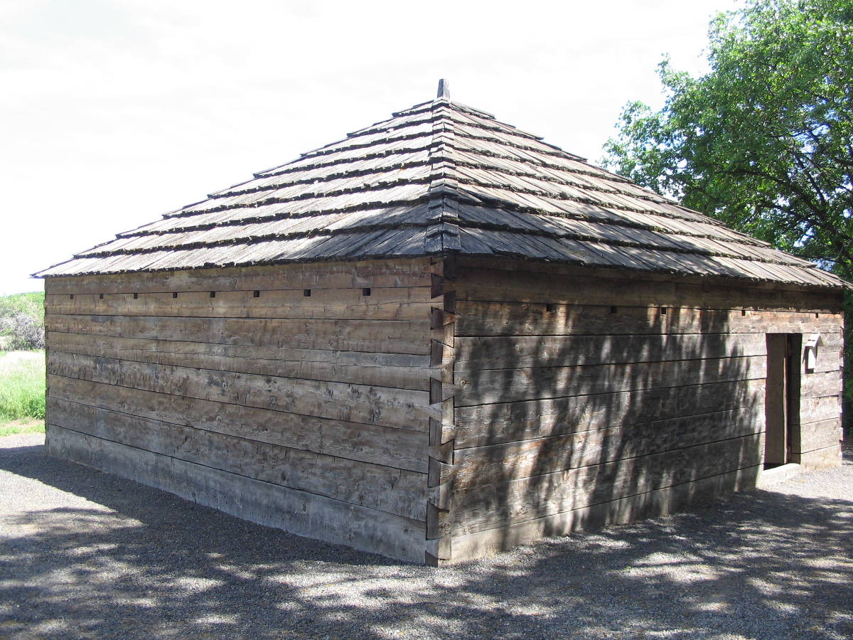

We built that way in Washington State, too. This blockhouse uses the compound dovetail that Old Axeman mentioned.
