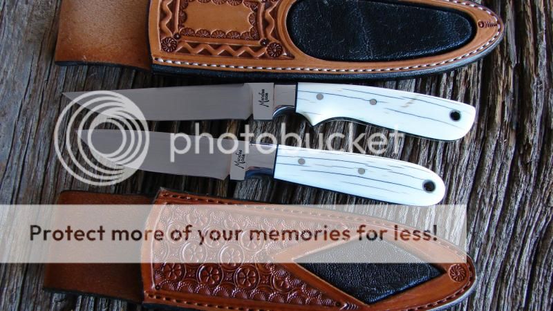

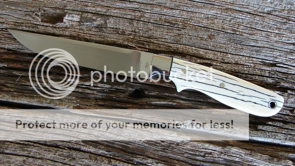

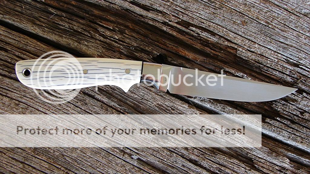

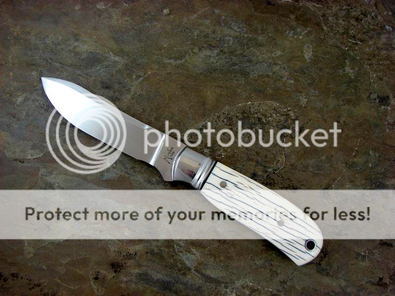

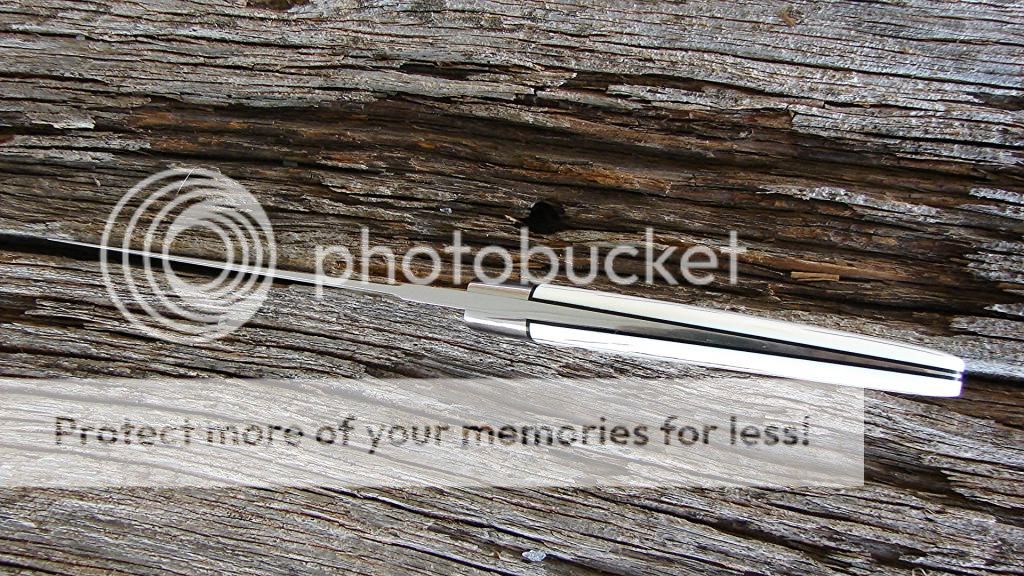

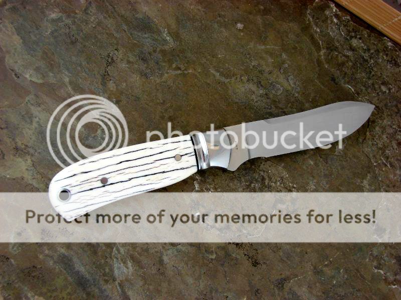

I have seen ivory stained and ruined by oiling. I never understood the commonly given advice to use baby oil on ivory. It crops up often on the internet and even in books.
On the same note, oiled leather sheaths can stain an ivory handles knife. Neatsfoot oil seems the worst, as it has an amber color.
Because it hasn't doesn't mean it won't.
Maybe that's why yours are cracked.....
