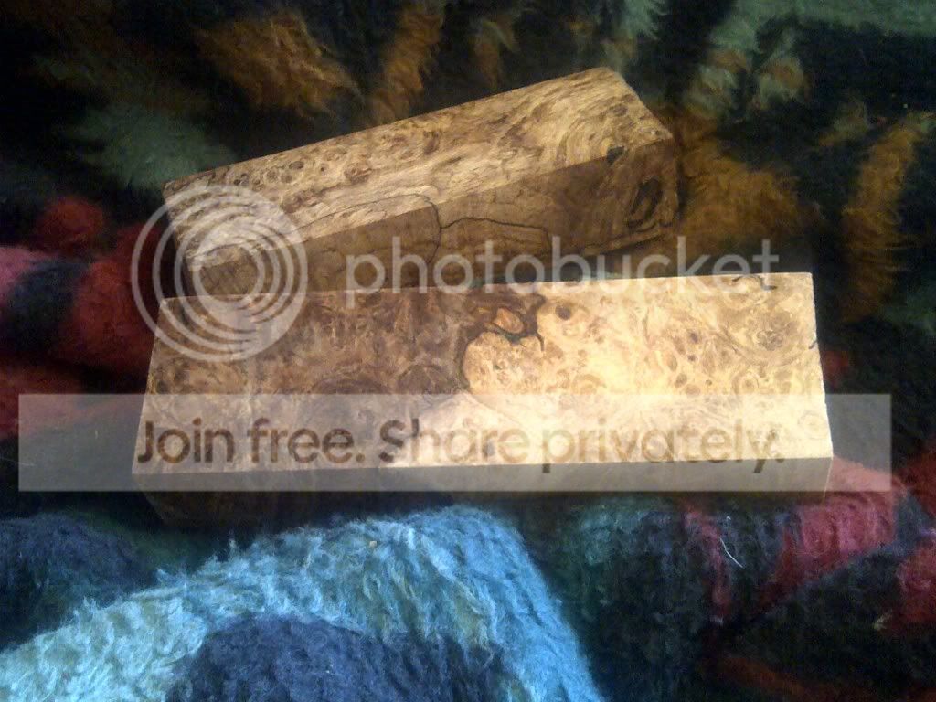

Greetings Gang.
Noobie here trying to finish a folder with stabilized spalted maple burl scales on it. What is the best way to bring out a high gloss on this type of scale?
I'm sanding with 400, 600, 1200 and then buffing with Jackson 51 rouge. The spalted part of the wood is taking a very nice shine but the burl is looking dull. This is making the finish look blotchy and inconsistent. Is there a better way to bring out the high lustre on the whole piece?
BTW- Not sure this makes a difference, but I'm using the micro muslin wheels on a dremel tool since I don't have a buffer yet.

Oh, what the hell. Just because we all need something to drool over.
Mineral spirits was what I meant. And yes, this technique is for bare wood so sorry I missed the "stabilized" part. Guess I got excited about sharing a tried and true technique with others. This does work, and you get basically a very stable finish that is tough, renewable as needed, and ready for wax or any other final finish you wish. Best of luck. Yes, the burl chunk is drool material!!
