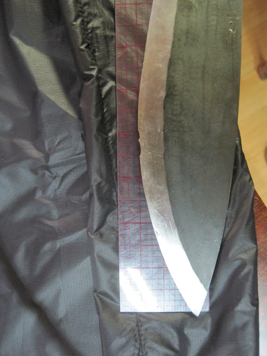

Bought a Tamang off the DotD recently, my first Kuk. It's incredible, I love the feel in hand, love the style. There was a little inconsistency to the profile near the tip, but nothing I cant work out.
I decided to take it out to the yard and clear some limbs and such that I've been meaning to get to, and my craptastic machete hasn't been "cutting" it. Pardon the pun.
It made short work of some pine saplings, small soft stuff about 6-8" diameter, but when I took it to work on the limbs of a fallen tree I thought was oak, even though it was only maybe 2-3" stuff, I knocked some pretty good chips out of the belly.
Now I'm pretty sure it wasn't oak at all, but hickory, and it was pretty knotty inside the wood.
I know that I'm likely supposed to be using a burlier blade for this kind of stuff, so I'm not faulting the kuk, just want to know if there's any tips to working these chips out and if there's anything I need to be aware of during the process?
Any reason I can't take it to the mouse-pad and sandpaper, and give it a slightly thicker convex edge?
Which kuk around the same size would be more suited to these types of chores?
I'm in love regardless, although I'm guessing I might need to relegate this one more toward camp chores.

That's what I would do. Though about what size are the chips, and did you do any touchup on the edge before starting? In my experience, HI has started putting a much sharper edge on than they used to, starting maybe a year ago. But I think some of the guys doing the sharpening are a little too enthusiastic, and I've seen wire edges on every blade I've gotten during about that time period, ranging from just a 2" spot, to the entire thing having a wire edge. Nothing that couldn't be knocked off in a minute or two with sandpaper, though. So you might have had a wire edge, and actually only damaged that. It's also possible than the overzealous sharpening softened a very tiny, thin layer, much like what can happen with the mirror polished ones.
Actually, hm. If they grind the final edge only on one side, it'd have a wire edge, but it would also be a tiny bit softer on that side, but not the other. So the khukuri actually would be "self-sharpening," sort of like a rat's tooth. Maybe that's the trick to some of the old "magic" khukuris that were supposed to never need sharpening.
I've done this so many times it's not funny. Just keep using it, and eventually it will go away. Unless you're heavily relying on it, one small chip won't affect performance much.
I've dinged both my 18" WWII and my 15" AK (before my wife claimed it) by not seeing big old nails in a big old fence post. Both sanded out pretty well on sharpening. Neither are pretty but I trust them both. Nice score on the tamang, by the way.

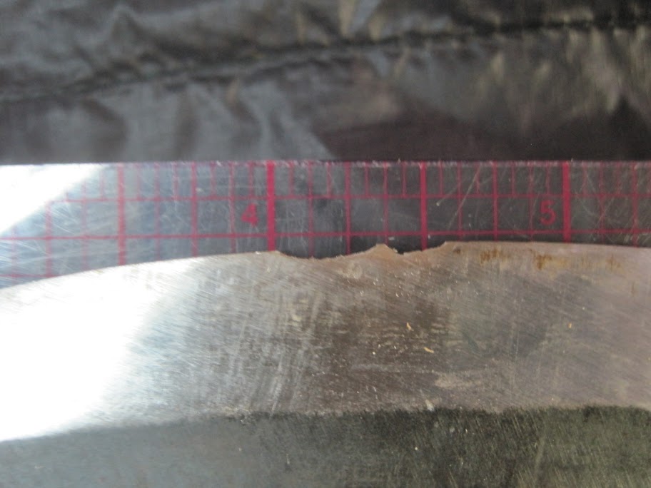

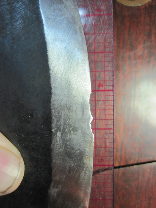

Well it got two small crescent's knocked out of it in the "sweet spot" area. They're both right beside each other, with only a small piece of metal separating them. One is 3/8" wide by a solid 1mm deep, and the other is about 1/4" wide, same depth.
Another strike in the same area would likely connect them, leaving a solid 5/8" long section missing.
It did have a shaving edge on it when I pulled it out of the box. In fact, even the non-chipped areas I used to chop with will take hair off still.
That's bigger than I've had happen to any of mine. Are you going to send it back or sand them out and see what happens?

Wow, those are big chips compared to what I would expect! As you say, though, the Tamang blade geometry puts it last on the list of kuks for this kind of job (after the AK, Bonecutter/GRS, and sooo many other heavy-duty choppers). The more axe-like the edge (convex, I guess), the better the chopping, and a thin, wide bevel is great for a weapon or light vegetation that a machete would normally handle.
The same issue bothers me a bit on my AK Bowie and on the old-stile, wide-bevel Bonecutters. They are just too razor-like for serious tree chopping given the RC hardness HI offers of close to 60 RC. Competitors' kuks have a much softer sweet spot, in my limited experience, of around 56 RC, making the chakma useful for fixing rolled edge as opposed to chips; there are pluses and minuses to both approaches, IMO.

I can't see your pics because I'm blocked for photobucket but if they are the size you say the tempering is probably off.

I'd contact Yangdu about it, but those don't look like terrible chips given the style of blade you were using.
I'd convex the blade and let time and use work them out. They aren't going to cause any performance loss.
