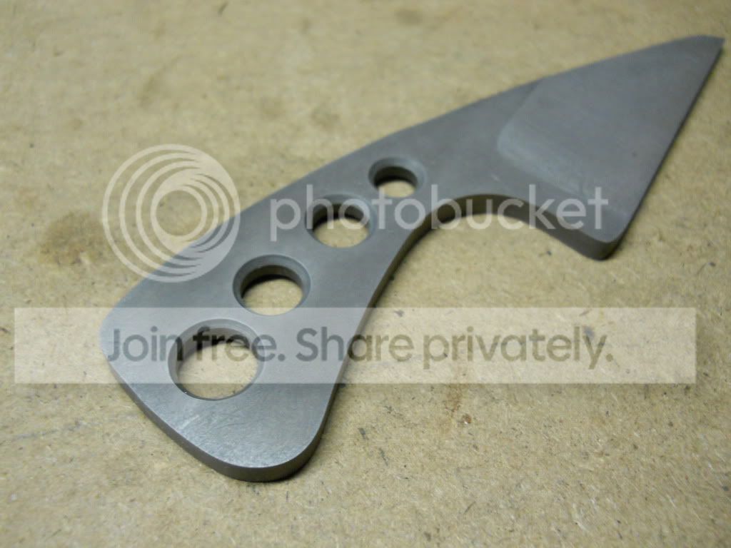

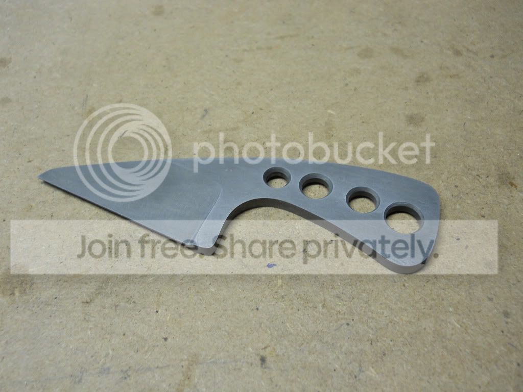

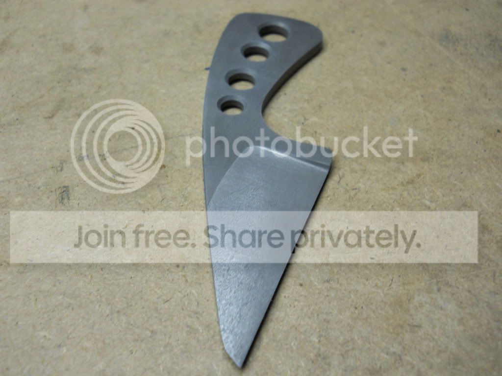

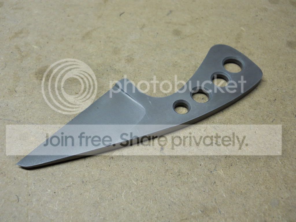

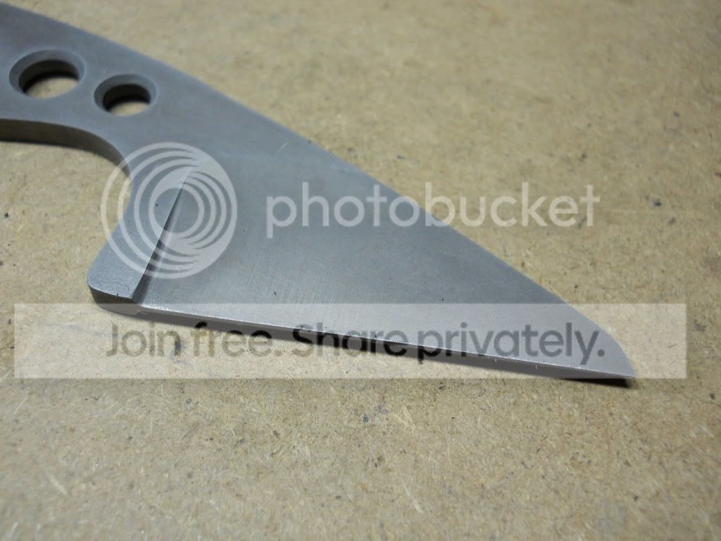

I wanted to try an acid washed finish on some of my D2 blades. I looked locally for some ferric chloride and didn't have any luck, but I read a few threads where people were happy with the finish they got from Muriatic acid, so I found some at Home Depot and gave it a shot. Here are my results with one of my D2 Two Finger Wharnies.
How does it look? Any suggestions for finishing? I just used some super fine white scotch brite to lightly buff it a bit but that's it. I've never done it before so I'm not sure if I should just etch it and leave it or if there are any other finishing steps I should be doing.
Thanks for any ideas.
Jonny, that looks awesome! Did you neutralize the acid afterwards? It reallt makes it look like a factory blade. How far did you go with the metal finish before the acid bath? I think a nice higher grit finish would look awesome done that way.

Looks good. I usually add hydrogen peroxide to the acid for a faster reaction. 2 parts hydrogen peroxide and 1 part muriatic. Do not inhale. Do not etch near an open flame.
Just neutralize with baking soda & water. I'll strop the edge to a bit of a polish then maybe a quick wipe with mineral oil.
Looks really good. I'm using muriatic/water to etch my steel and like it well enough.

I tried a low concentration with purified water to start and got almost no reaction. This was with a 50/50 mix with muriatic and water. I used windex to neutralize, wasn't sure if that was correct, but figured it works when I etch my logo so I might as well try it for the muriatic too.

Yes, it's the concrete etch muriatic. I believe it's not full strength which is why I needed the higher concentration with water to get this color. I might try it without any water and see how good that does. I'd still like to find some ferric chloride to try.
