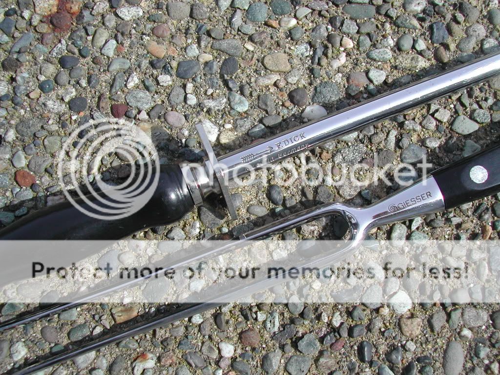

Today in my backyard while chopping with my FFBM and NMSFNO my NMSFNO spilled out of my hand and bounced off my FFBM. Upon inspection i noticed a rolled edge near the belly of my NMSFNO. There's a slight flat spot and it's pushed to one side.
Is there a way to fix this without removing too material and redoing the entire egde?

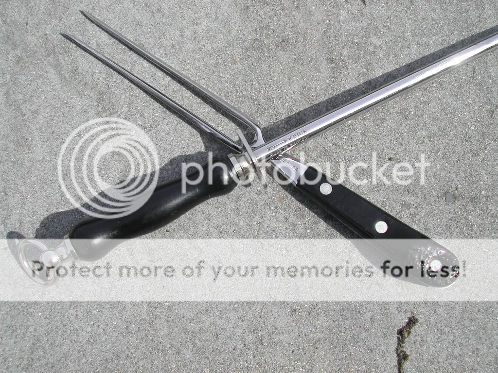

Yes, you can use a smooth rod to push the edge back like the one shown below. Then just sharpen like normal.

The general recommendation is to NOT use the typical grooved butcher's steel on a rolled edge. That will scrape away some steel from the edge. As noted above, clamp the knife in a vise, and use firm pressure with a smooth hard cylinder. Stroke away from the edge and you should be able to push the rolls back in line.

The rod shown above does not "cut", it is a polished smooth rod and will only "push" the blade edge, removing no material. Kitchen steels that sharpen are basically fine round files and I don't use them. To use the smooth rod, you "push" the edge with the rod in the direction from the spine to the edge to straighten it.

If you want a smooth steel you can use the smooth side of a drill bit
