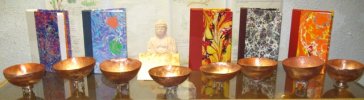

Whoops, I never thought about how you might be starting with a piece of work hardened brass, but it sure could be possible. The metals we get for our classes are not. The 11th grade jewelry classes have been making rings from pierced copper sheet sweat soldered to sterling sheet. Each of the students flattens their distorted copper strip (after cutting it off the sheet with shears) with a rawhide mallet on a piece of steel without dents. In 9th grade we do almost what Stacy just mentioned... make bowls from 6"-7" pieces of copper sheet. You can kind of make out a piece leaning against the Buddha in the photo.
