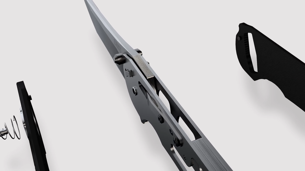

We've talked about it a few times but this is the first time I've seen it explained in such detail. Blade HQ did a very good job debuting it on their "Knife Banter" web show on YT. (Full episode here.) I edited the full video for Deadbolt-related content and took a few screengrabs.
I've got to say that at first glance this looks really promising. I feel the exact same way about CRKT as the rest of you (the place where cool mechanisms go to die ...) but I'll be damned if I haven't gotten my hopes up.

Interesting design for sure. I do not understand how it keeps the blade closed and how it deals with blade play, I would like to examine it myself.

I was wondering about blade play too. My guess is that the lock wears in the axial direction and we just can't see that geometry in these diagrams. At least, that's what I hope.

Based on my limited understanding of how this works, it seems like side-to-side blade play is more likely than up-and-down.
The spring on the push button release looks, well, like a weak spot in the operation.

I don't know for sure but if you look at the odd-shaped hole just behind the thumb stud and the long stud that enters it, it looks as if it's designed to settle in up or down. I'm guessing it pops in when the blade is open and closed.

I might be missing something but it appears as though their exploded diagram shows the pivot barrel is in the wrong spot? It should be to the right (outside) of the clip-side liner.
Also, what is that leaf spring that's bolted to the show side liner? It looks like the detent mechanism?
Edit: Yet more questions. How does the locking piece return to position when the button is released? There's no obvious connection between that piece and the button. It looks like it might be affixed to the end of the plunger, which I would think might prevent disassembly.
Edit: I should have watched the video all the way through, as it explains the disassembly question.

I think that leaf spring is for the detent in the closed position based on what I can see. It looks like a torx screw goes through the pivot to secure the button and the lock so should work for disassembly.

I think the lock piece would try and push out on the opposite side so if your pinch grip pinches both sides it should remain locked from what I can see but can't say too much until people have them in hand.
Is it just there for thumb flicking?
The knife shouldn't need a detent since the deadbolt lock will hold the knife closed as well.
