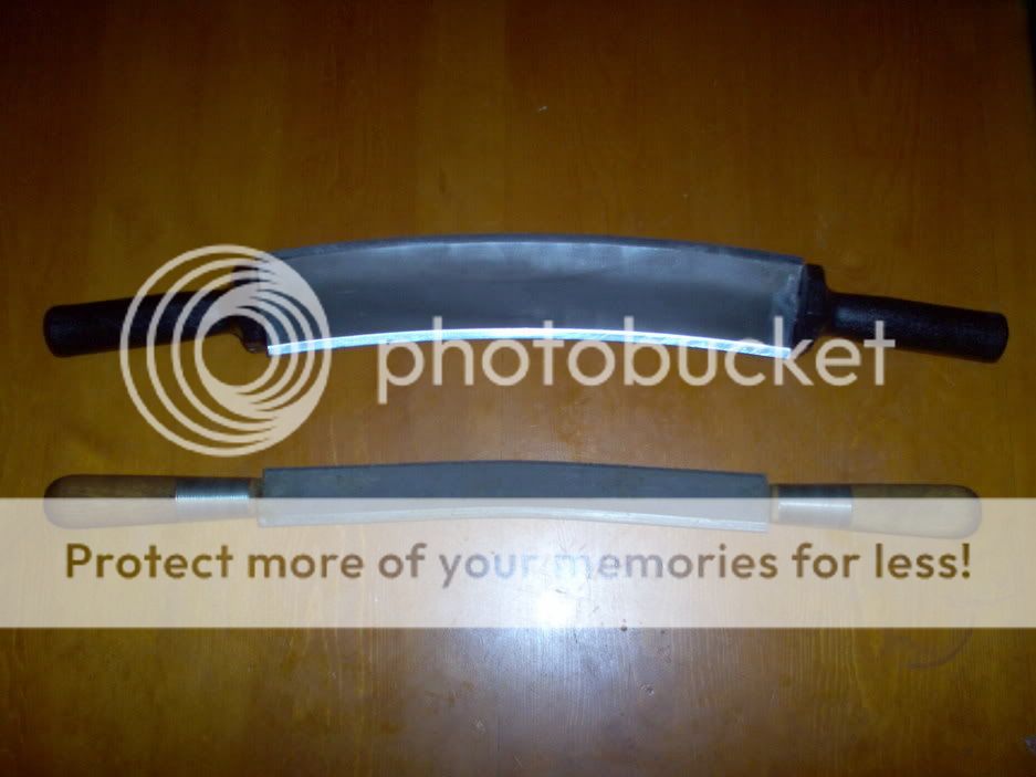

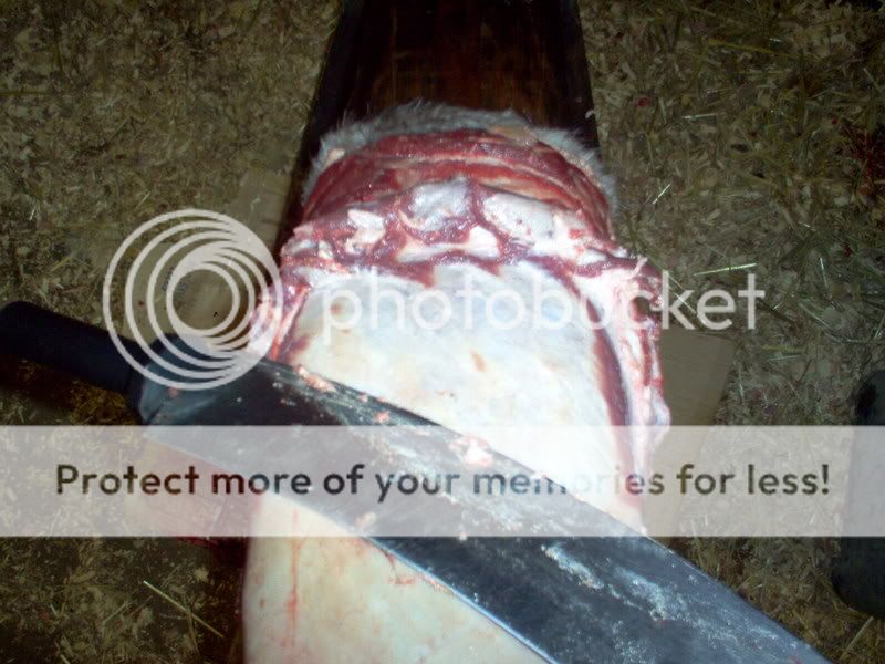

Im a trapper, Ive skinned and fleshed many,many hundreds of critters. A good fleshing knife needs to be have a sharp chisel grind on one side, not dull..Try to shave the grissle off a coons neck or a beaver hide you will know why. It will not "push off" like a mushrat,mink or bobcat will..It has to be shaved off..The back side of the knife needs to be dull for those jobs..
Check out the shape of the Sheffield fleshing knife and the necker 700..Also the post, those are the kind pro fur handlers use..
here is a pic of the 700 and a "cheapie"...While the cheapie will work in that shape the 700 is far superior..
Here is why it needs to be sharp..

I grew up trapping in Alaska and can vouch that Kentucky has it right on the design. I would also stress that you want the slight curve in the blade with the "squared" blunt edge on the outside curve and a good chisel grind on the inside curve.
since we are talking aobut curved part
the cheepie i sharpend looked warped a bit along with the curved shape is that by design or jsut a crappy knife that was bent a bit at some point?
