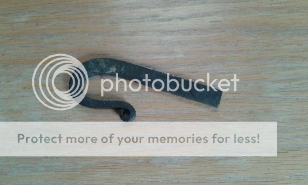

A piece of file that I cleaned up the edges on. :o
When I decided to take on making a kit and char cloth I did it all on the cheap. All free stuff that I had lying around. The piece of file worked so I never replaced it.
