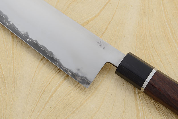

52100 also loses a lot of it's carbon in this procedure. using nickel will work very well however you lose the shadowing effect that makes stainless carbon san mai look so cool. one way to get that back is to use a very thin shim of high carbon steel between the nickel and the stainless. This will give you the shadowing and protect the core from decarb. I would use .002 or .003 nickel and 1095 between the stainless and carbon steels.
http://www.bladegallery.com/pics/91898_2_b.jpg
