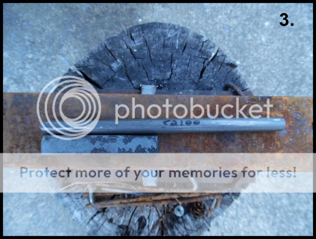

Not sure it this will be helpful to you guys, but it might help out somebody without access to a press or powerhammer .
I don't have a press or a power hammer, so I had trouble getting any width back when I was trying to forge little integral bolster knives out of some 7/16" round 52100 that I was sent to play around with and practice on in a trade. I saw Ray Kirk (he was the original source of the steel I had) forging this same size on his power in a video he shared, which enabled him to spread it to a decent width for some of his smaller integrals. I believe he even stated how a power hammer really makes a difference it how much width he was able to achieve with this size.
Anyway, I ended up upsetting the (about) 7-1/2" length round stock down to about half its length which caused to grow to a little over 5/8" in diameter. I then forged it into square stock so I could forge it down on its corner (or diamond), which really helps 'squish' the steel out in its width without losing much to length.
I had remembered reading about this technique somewhere online a number of years ago written by Tai Goo, and how he used it to get a good amount of width when he forges RR spike knives.
Here are a few pics from a couple years back when I tried this technique.
Here is the upset and then squared bar next to a piece showing it's original length and size:
Same thing, but different angle:
Rough forged. Here you can see how I forged it down on its corner (diamond):
And finished forging:
