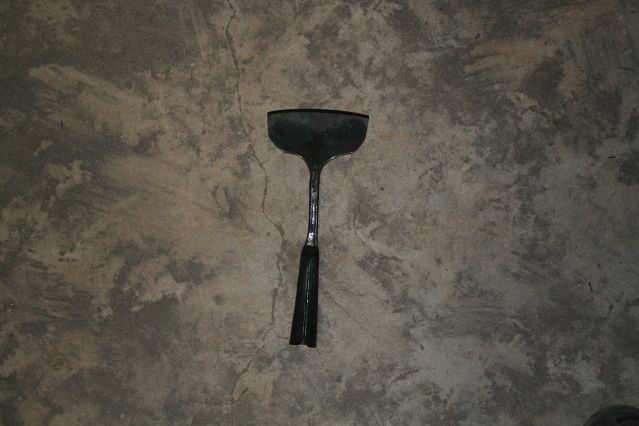

I know it's not an ax, but this seems the most appropriate sub-forum.

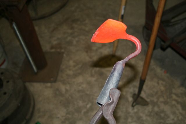

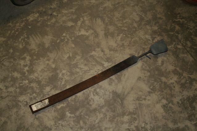

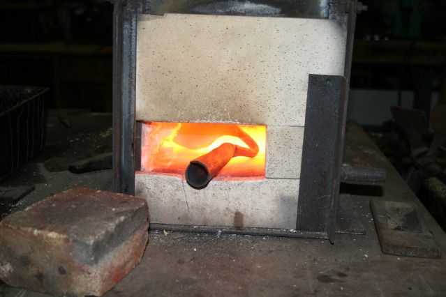

This was commissioned by a Zombie Squad member as a present for his sister. Most of the forging was done with Gunnhilda, my homebrewed power hammer. I started with a piece of new leaf spring stock, forged out the neck and spread out the preform for the socket. I actually used math to figure up the size of the socket to fit a regular hoe handle with a bit of shaving on the handle to ensure a tight fit.
Then I rolled the socket and cut the hoe free from the parent stock.

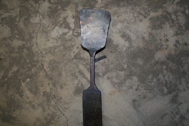

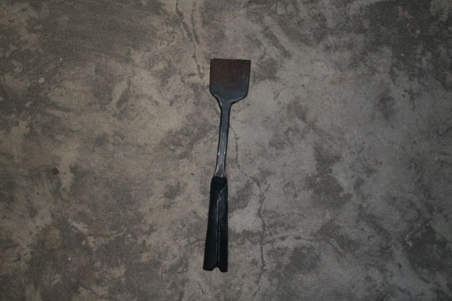

Then I spread the blade out and thinned it down.

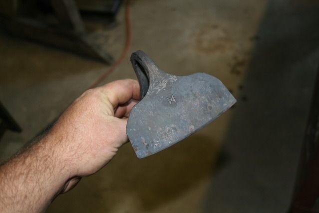

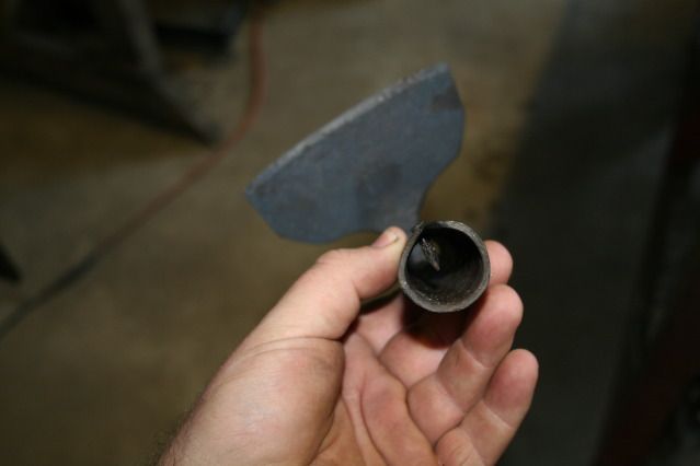

Because the neck got forged a bit off-centered when I forged it, the blade came out off-centered. I trimmed it more even and ground the edge bevel in.

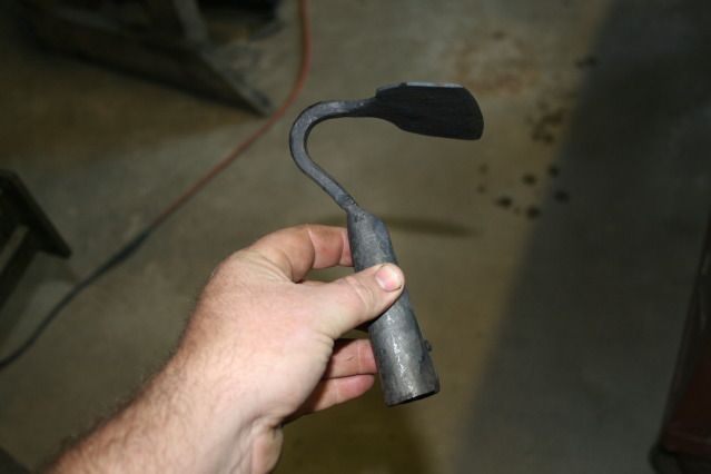

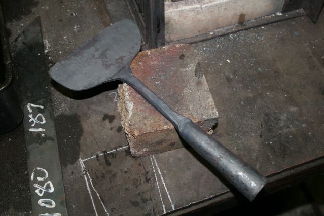

I stamped my touchmark on the blade, the first time I've done that on a hoe. Then came the part of the process that is most difficult for me, bending the neck into the appropriate angle. If the angle's off a bit, it won't work very well.

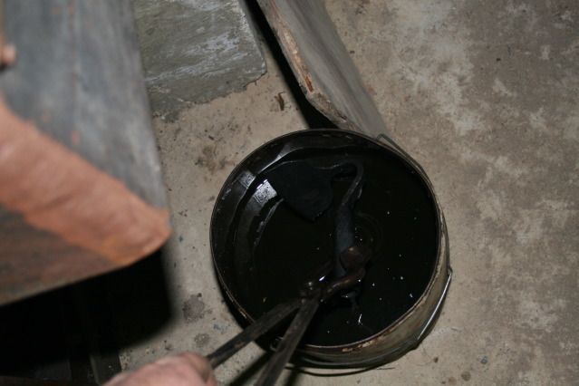

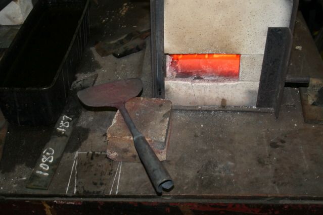

Then I hardened the blade and neck in commercial quench oil.

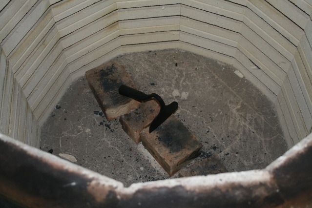

After that I tempered it in my kiln.
This morning after pulling it out, I drilled a hole and forged a little nail to make sure that it stays on the handle once it's fitted.
And now it's off to its new home, in time for Christmas. :)

Nicely done! Did you determine head geometry based on handle length and user height? I don't have the luxury of ground fit for hand tools like this, so I never really used one much. Looks fantastic though and I imagine will be a source of pride for the avid gardener!

Fast14riot - I used a fairly standard hoe handle to figure the socket size (2piR for the top and bottom), and the angle is based on an earlier one I made which was adjusted to the angle of some field hoes that my daddy had set.

Omniviking - Very much so. I really enjoy using good hand tools and strive to make sure that's what I make. :)
