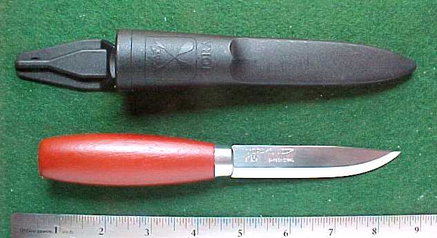

A puukko weould make an excellent choice for a fixed blade for general utility and camp use. This ancient design has no guard or choil, and relies on the woodsman's skill for safe use.
The Swedish Mora is typical:

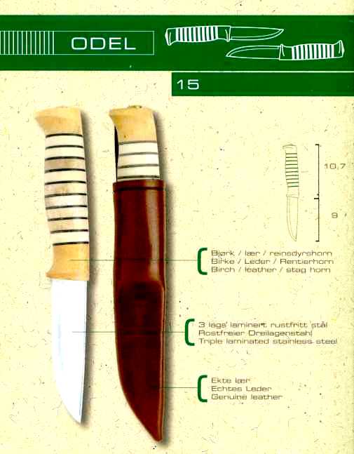

The Norwegian Helle knives are elegant, often with more shape to the handle:

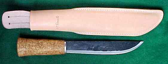

The leuku is a similar knife used by the Lapps:
