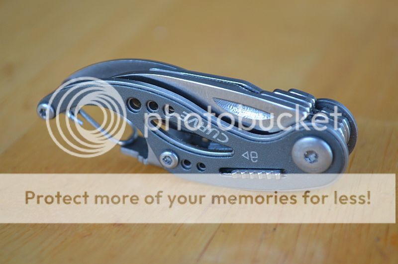

I have been aware of the Gerber Curve for quite some time now and was attracted to it for it’s exotic shape, locking implements and minuscule size. I was just never able to justify paying $10 for the tool and $5 shipping. I found one while browsing in a Dick’s store a little over a week ago. It’s the first time I’ve seen one in a store, and seeing it in person made me want it even more. I ignored the $15 price and bought it.
The tool is tiny and extremely light weight. The length to width ratio is very good making key ring carry easy. From reading reviews online about this tool, I was aware that the spring clip for attaching it to keys is prone to failure. Because of this, I simply ran a key ring through the tool itself, much like I had done with my Gerber Dime.
The tool contains a blade, large flat head driver, small flat head driver, Philips driver/file plus a bottle opener built into the handle of the tool. All implements lock in the open position with a sliding lock bar that is exposed on either side of the tool.

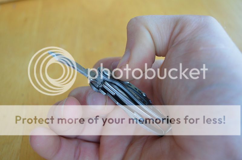

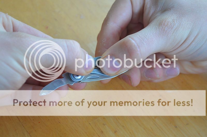

My first instinct on how to unlock the tool is depicted in the picture below. The issue with this method is that the spring is considerably tighter than you may think. Also, due to the tiny size of the tool, you have to hold it in an awkward manner and use your finger nails to pull back on the lock. The bottle opener portion of the handle also is pressed quite hard against the palm of your hand in the process and is uncomfortable.

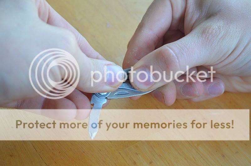

After playing around with the tool, I found this method. The tool is grasped near it’s base between the thumb and index finger of my right hand. With my left thumb and index finger, I press the lock back, and use left ring, or pinky finger to swing the implement back into the handle. This method is much, much more comfortable.

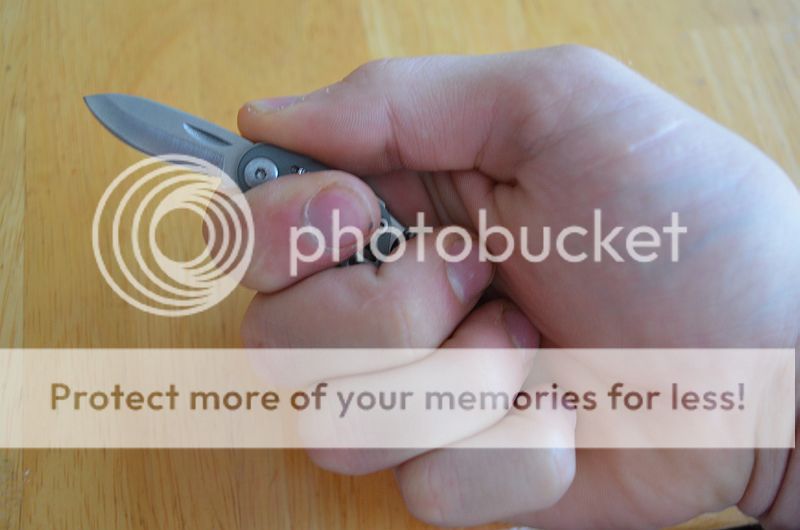

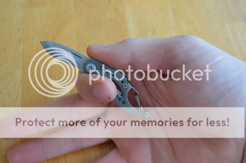

When using the blade, I hold it in this manner:
You will notice that the blade is angled away from my hand. This feels strange at first, but uses the belly of the blade effectively. The lock is beneficial here because the handle shape naturally makes you choke up on the blade and brace your thumb on it’s spine. I have cut plastic, cardboard, paper, cloth and 550 cord with the knife. I also whittled a few pieces of wood just to try it out. Aside from it’s obvious lack of size, it cuts quite well. The edge out of box was alright, and with a little touch up it has taken a nice utility edge. If you use the blade, or any function of the tool for an extended period of time, some hot spots will make themselves known. This is not a hard or all day use type of tool.

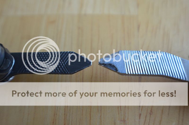

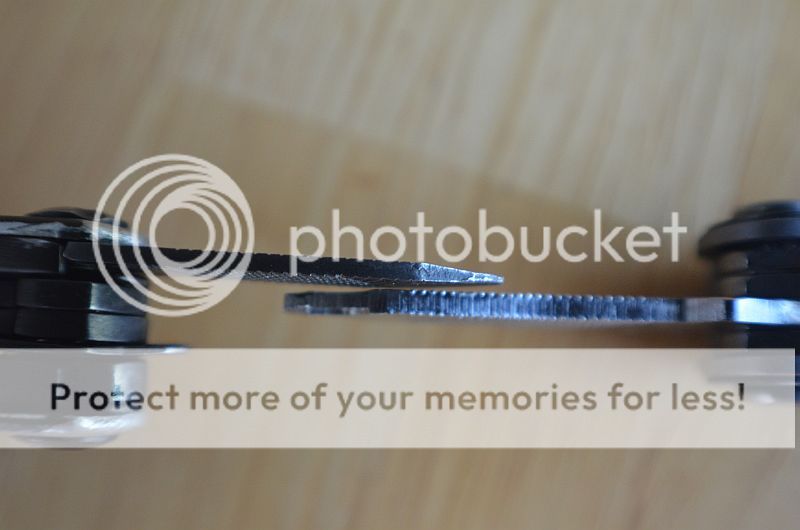

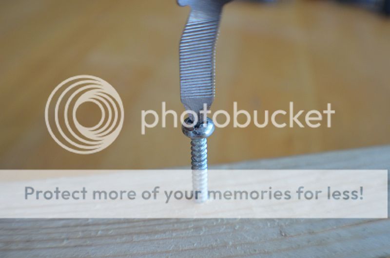

Now, my biggest gripe- The Phillips driver. You can see in the pictures below that it is thicker than the one on my Dime tool, and also has a bit of a 3d portion on it’s tip. This tip is too fat and square for the majority of Philips screws I have tried the tool on.
Here you can see how much deeper the Dime’s driver engages the screw head…
And how shallow the Curve’s is.

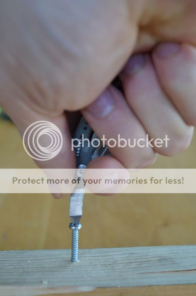

With a lot of downward pressure, the Curve’s driver will turn the screw without slipping, but it is very uncomfortable as the bottle opener portion of the handle is pressed hard into the palm of the hand. The lock really comes in handy here. I will attempt to file the head of the driver down some, to make it more like the one on the Dime.
Also, notice how the driver locks at an odd angle compared to the rest of the tool. It makes it difficult and aggravating to run long or finely threaded screws in or out.

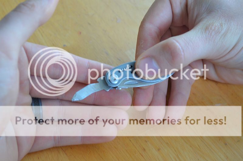

I have found that this technique using the small flat head works better for breaking Philips head screws loose.

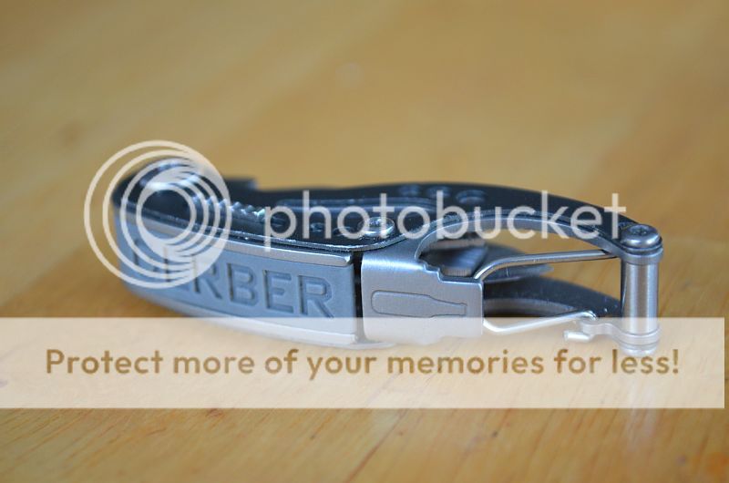

The bottle opener seems to work fine, and usually only requires the user to pry up once. A few more stubborn caps had to be pried up in two locations.
