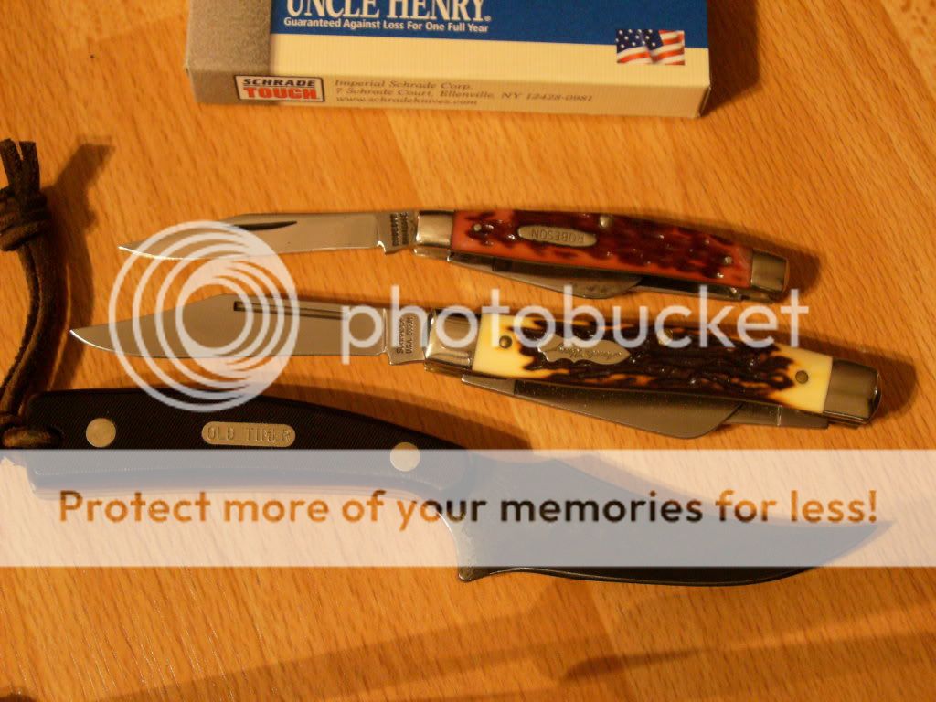

I used bluing formula from the gun store to blue this 80t old timer. I do it to all my carbon steel blades.
scaled.php
