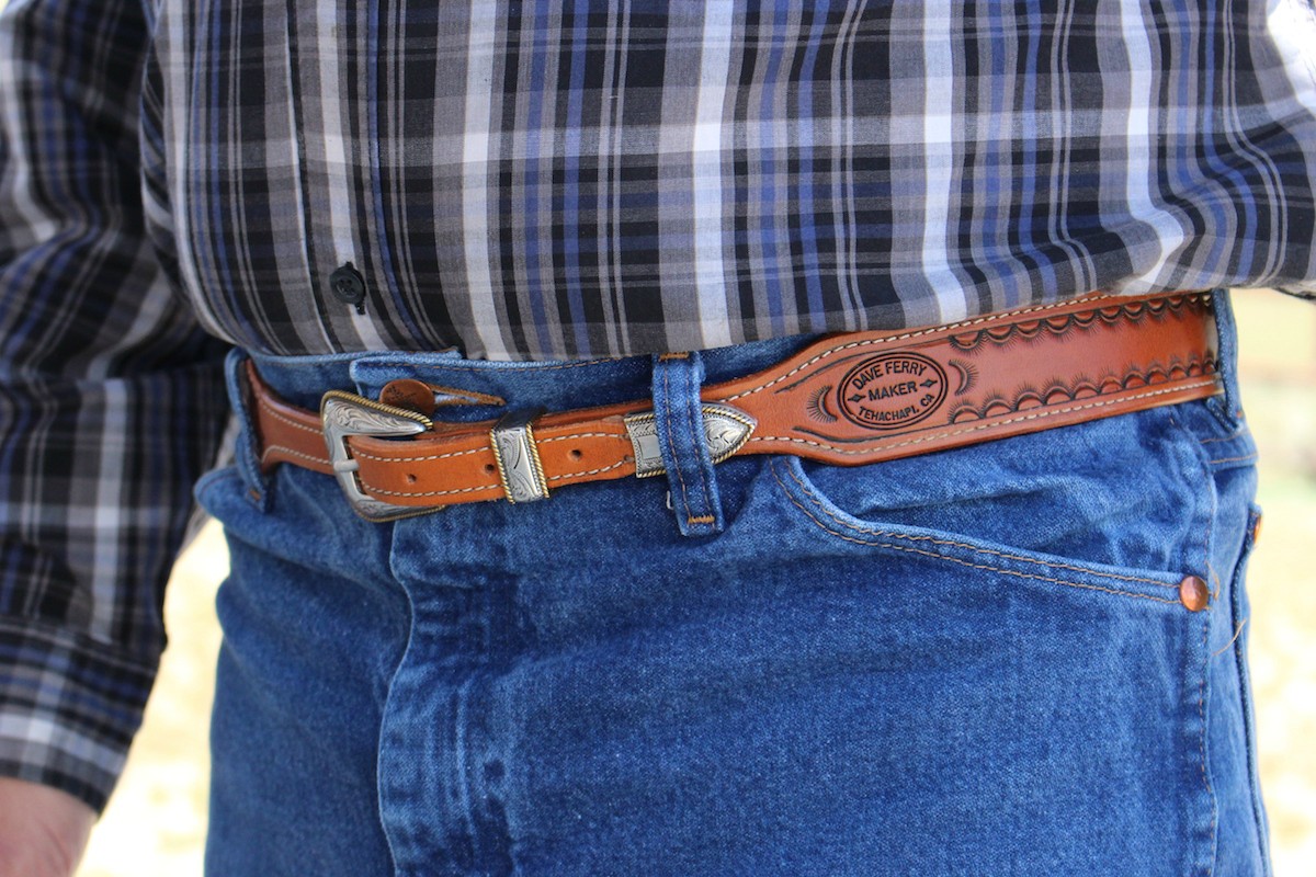

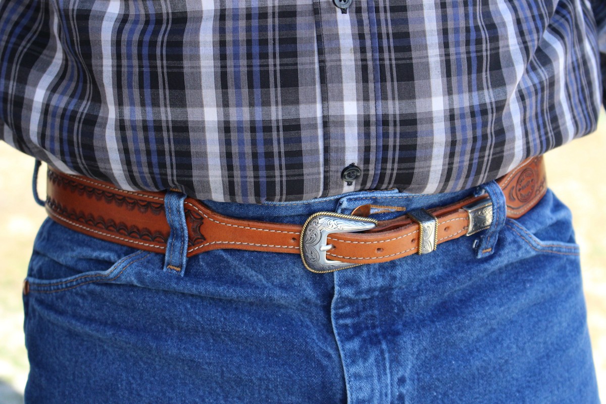

Here ya go Ken: I would say most of the belts I've made over the last few years have been of this tapered style. This is my own personal belt.
This tapered style is really popular here now. It tapers from 1.5" to .75". I do a lot also that taper from 1.5" to 1". The bottom two belts in your pic are what we call Ranger belts. They use to be very popular here but not so much anymore. I only made one in the last year or so. Your top hobble belt doesn't exist here unless you went shopping at an Australian saddelry shop of which there are a few. The manager of the ranch that borders ours wears one, but he's the only guy I can recall wearing one. Cool idea but just not seen here much.
I like to build my belts two ply. I will use 6/7 oz on top and lighter on the bottom 3/4 oz being ideal but 5/6 oz is what I use most often because I don't build an awful lot of belts and that is what I have on hand. 6/7 oz is heavy enough for good tooling. This belt I beveled and border stamped, dyed it saddle tan and antigued. When bevelling a long straight line like on a belt I will use a push beveler not a stamp. I do not dye the lining at all. This prevents absoultely any dye transfer to clothing. Plus I think it looks cool. I dislike dyeing belts as much as I dislike dyeing sheaths. They are gonna crack. I can dye spur straps and holsters all day long and not have em crack. Sheaths and belts not if but when. If I were to set up a belt making business I would use pre dyed leather only. My little brother (I say that tongue in cheek cause he's my height, 6'4"ish and at least a 100 lbs more than my 230) has actually bought the domain name "Big Boy's Belts". He likes my belts cause he says a big guy can't find a decent belt in a store. So we talk about doing bigboybelts.com But that is all it is now talk. Maybe someday we'll do it. But if we do I'll use pre dyed stuff.

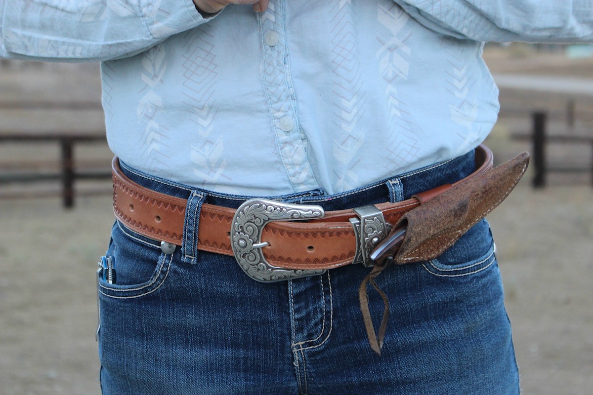

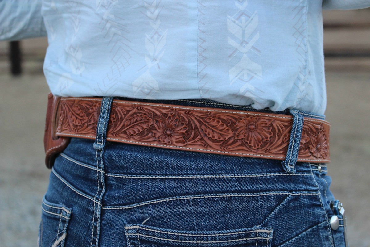

Here's another one I built. Nichole did the carving. This young lady is our local horse Vet's assitant. She and the Doc are walking advertisements for Horsewright. This is a 2" belt without any taper at the buckle, what I call a straight belt. This one is really heavy duty. 7/8 oz on top and lined with 6/7 oz. Besides one of my knives and sheaths over the left front pocket, she has a Leatherman sheath that we made on her left hip and a folder clipped to the right front pocket. This is a knife girl. She asked for the belt to be extra heavy as she often carries a pistol too and wanted the extra heavy belt for the weight of the gun. Haven't made her a holster yet, working on that.
Oilfinish on this one so no cracking. The sheath is roughout and has seen some use. She was just trying the belt on for the first time and missed a couple belt loops and didn't have it up tight enough because we were hurrying, running out of light for the pics.
These three piece buckle sets can be aggravating to work with. Mine and this one are both Tandy buckle sets but even custom ones can be too. I won't make a belt for a three piece buckle set unless I have the buckle set in hand. Too many variations. The buckle will have one measurement, the keeper another and the interior of the tip a third. Ya always have to fudge some with these guys.

That's a nice belt , is there any issues with the 2 ply leather being so thick in regards to where it goes through the Buckle ?

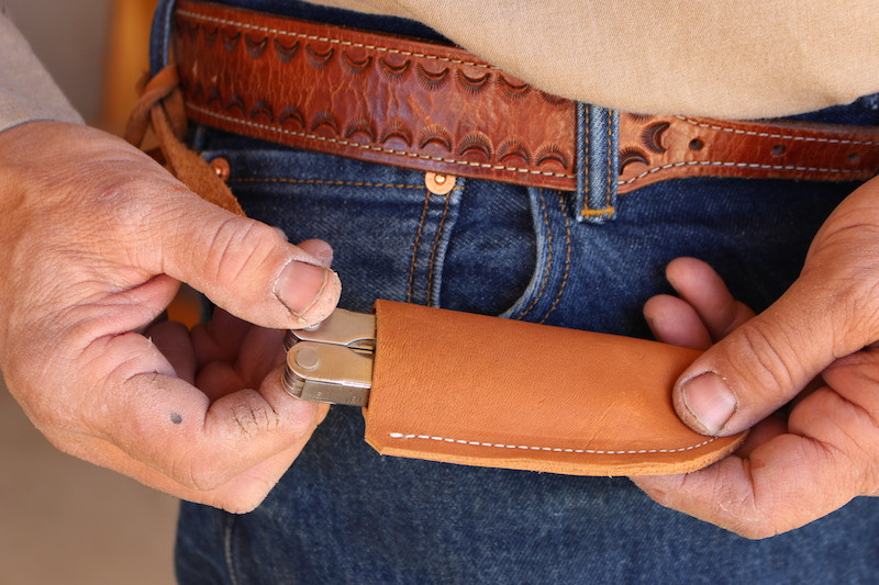

Ya know Ken I don't know!! Here's a pic of the cracking. This is my belt 18 months to two years probably after those first pics.

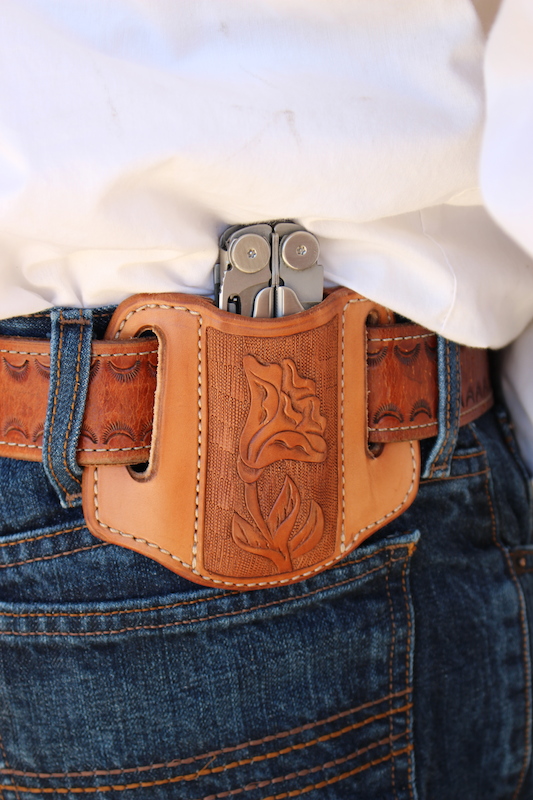

Yeah on a belt that heavy there is some break in period for sure. But the buckle doesn't seem to cause too many problems. Same with my pancake sheaths. Customers tell me its about a month of break in on one of those sheaths. Here is a pic of one of my Leatherman sheaths. She had a different Leatherman so I made a block of wood the same size to use as a form. I've got about ten of these Leatherman blocks now. Lots of different Leathermans out there. We did the California Poppy like this one on hers too at her request.
That is the nicest Leatherman Sheaths I've seen .
It makes my old Surge Sheath that I wear everyday look like a very poor relation , very poor indeed . :)
Ken
That pancake is beautifull. Greetings to lady with nice belt.:)Ken's sheat is also good lookin.
When you make two ply belt do you take into consideration difference in length between two layers?
Thanks guys. Those Leatherman sheaths are fun and easy. Macan no, I do cut the lining a little over sized. Just glue it up, stitch and trim after stitching. Anytime I can I will leave the bottom side of anything I'm sewing oversized. The sewing machine is happier that way. Happy sewing machine, happy Dave. Once the two parts are mated up and stitched together they basically become one piece of leather.
