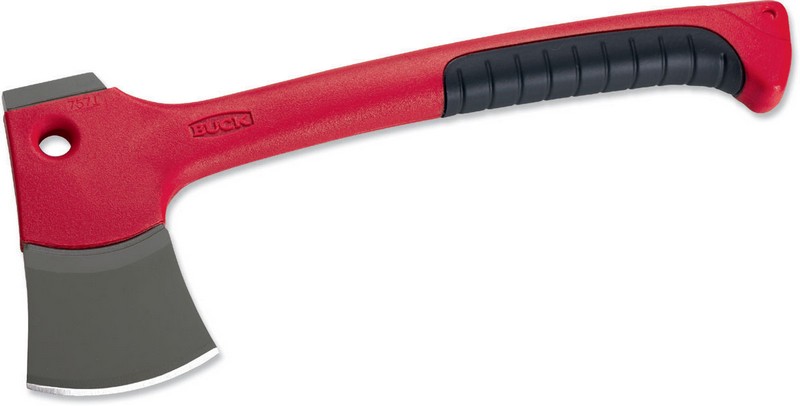

I do like this buck, they were smart by putting a hole in the head for the plastic to mold through making it more secure for a longer lifetime of use:
http://www.great-lakes.org/graphics-2/Buck Knives/rev-04-23-07/757RD.jpg
But really like the combo a bit more.
