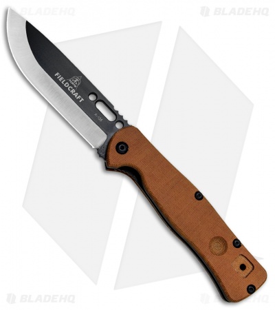

I knew about 1095 as I have an Eese and a mora but am not aware of a modern folder made with this blade steel.
The TOPS Fieldcraft is the only one I know of off the top of my head.
Traditional folders are really where you see any significant amount of 1095, or carbon steels in general. D2 is, by far, the most common non-stainless steel you see in modern folders.
Even then, most non-stainless steels you might encounter in production folders have a fairly underwhelming patina potential. Your best bet might just be to find a folder you like and give it an acid etch.
