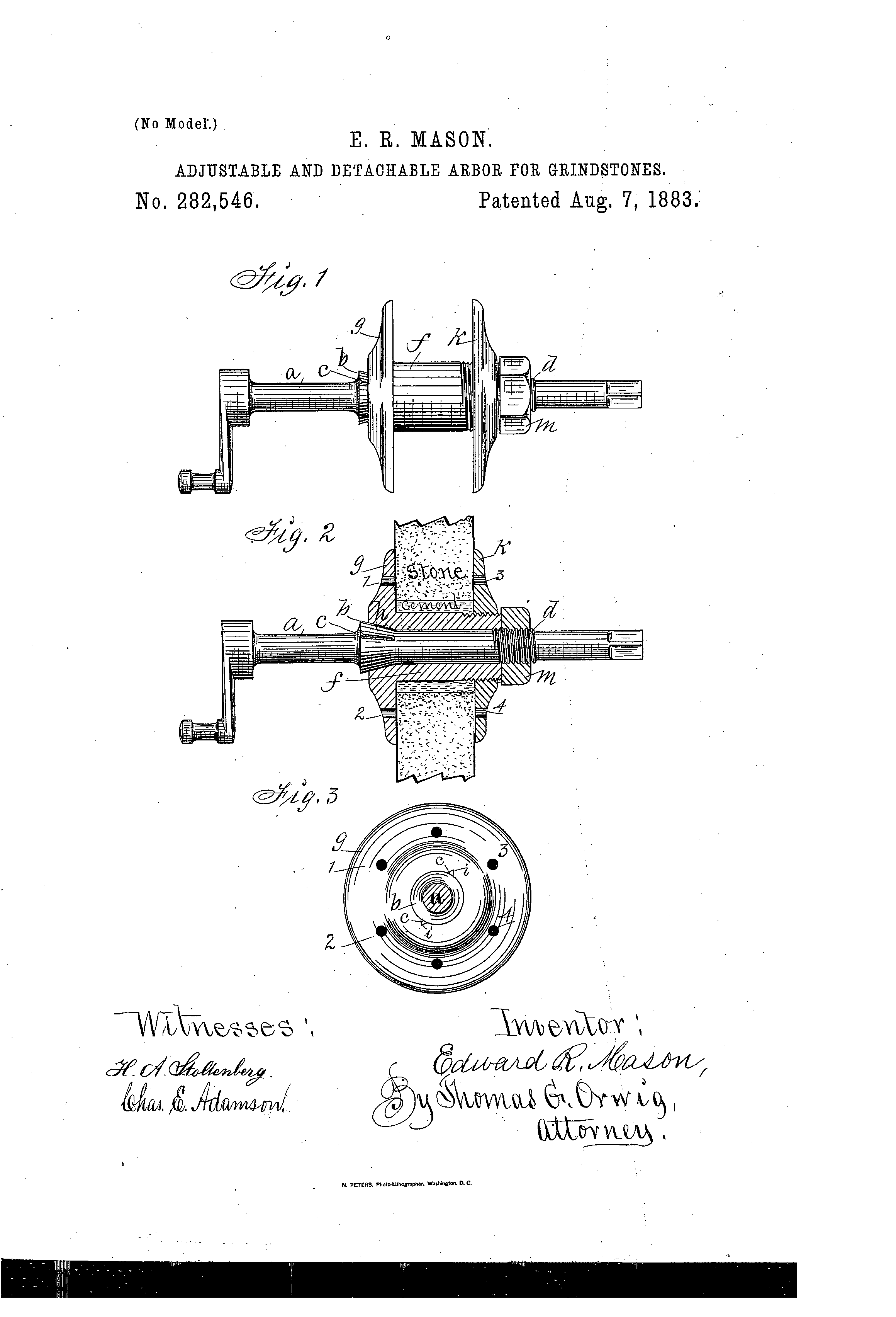

Mine doesn't have a frame, and appears to have been modified to take a leather belt. I'll try to take photos if anyone is interested. Since the nut is frozen with rust I may try to use the method shown below for bearings. Someone even found the patent info for the hub.

Update: I got the hub off, and whoever modified my wheel put the hole WAY off center (like about an inch). So would you try to grind it into a smaller, but truer wheel, or just scrap it?
The last 20 or so years of my dads life he was a part time antique dealer, and he drug me to about 5000 auctions, mainly so I could carry stuff to the tuck I think ;0) and I don't think I ever seen one of those stone wheels that wasn't off center
If it were me I would try to re-balance the wheel using one of those stones for truing bench grinder wheels
