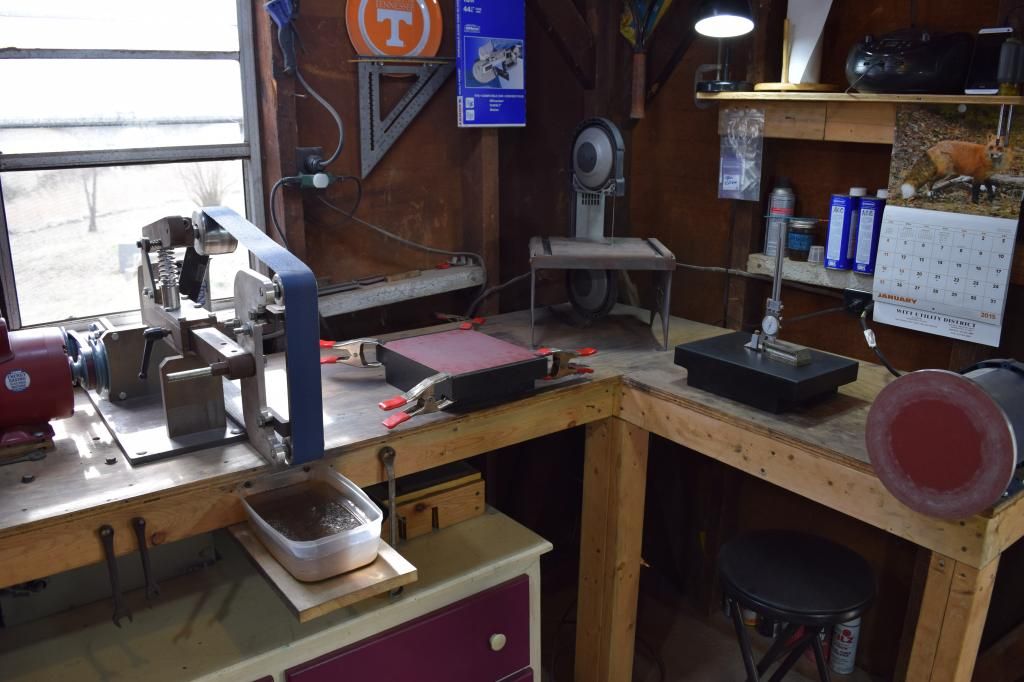

Hey guys, I'm about to purchase a granite surface plate from Grizzly since they will ship up to a 12x9x3" size slab for no extra shipping. Anyway I was wondering what the benefits of having one with a ledge on it would provide? They sell two in the same size (12x9x3) , one without ledges, and one with two ledges on opposite ends, for pretty much the same price. I'm sure they are meant for being able to use clamps, but I'm curious if anybody here can name some differrent ways the ledge of the place can be used in knifemaking.. I was thinking if you needed to clamp the blade down, or if you wanted to clamp a sheet of sandpaper for flat sanding without wanting to use any adhesives they would be nice, but is there any reason it would be better to get the one without the ledges, other than it weighs more?.. (although only by 2 lbs)

I purchased 2 of the 12x9x3 with ledges from Grizzly. I use spring clamps on the ledges to hold paper in place. Works great. As mentioned, it also helps having the ledges if you need to move them around. Couldn't get by without them.

If you skip to 7:20, you can see how I clamp paper down to my small gp. You could easily do this with a pair of C clamp vise grips on a gp with a ledge. :)

Yeah, I'd like to eventually get one of the 18x24 Count. When I purchased mine from Grizzly, I actually meant to order only 1 but ended up with 2 in my cart somehow. I'm kind of glad I did though, cause I use them both. One plate stays set up just for paper and the other I use a lot to check for flat, scribing, stamping leather, etc. Bench space is a premium in my little shop, so I just keep them stored under my bench when not in use. As I mentioned, the ledges are really nice for clamps, but are also handy if you do need to pick them up and move them around frequently like I do.
For anyone who might be interested, here is something I learned from my dad who was an old school tool and die maker. Surface plates should be mounted on a three point mounting system. This keeps the plate from rocking and provides as level a surface as possible. Below is a mil spec diagram that shows the best location for these supports. The example is for a 18"x24" plate, but the diagram give proportional dimensions to be used for any size plate. I used hard rubber bumpers for the tripod points on mine.
