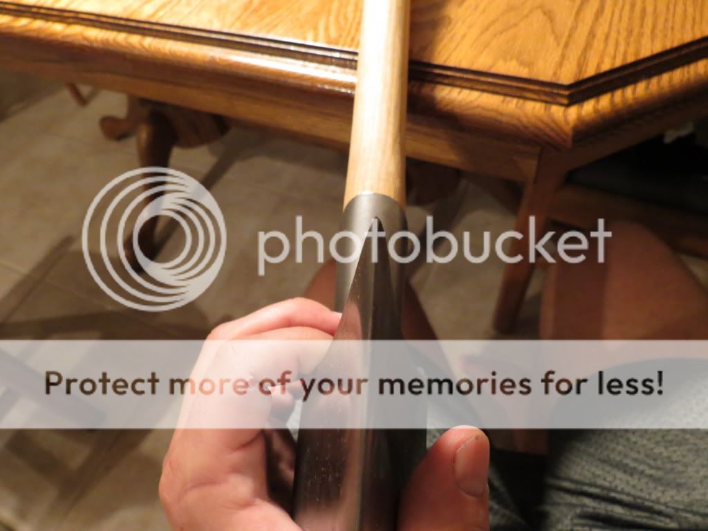

Hi,
Just recently bought the Gransfors Bruks Small Forest and Splitting maul axe from ImagineGear on Amazon. They arrived with what I would call defects to the blade. Over-grinded on corners and one side to the small forest looking like they couldn't keep the angle straight when they were sharpening it. I figure pics will speak better than words. What do you think, return them? normal? Does anyone else have similar occurrences? I don't believe this to be intentional, as it's only done one side. Thanks for any input.

That's a bummer but personally I wouldn't hassle with returning it. Thanks for reporting this; Gransfors Bruks quality needs to be monitored if they want us to pay the high prices. If we get more and more reports of flaws then we know quality control is slipping. My experience with GB has been good so far. I have the heavy maul and carpenter's hatchet which both arrived in perfect condition.
I bought both my GB splitting maul and American felling axe from Imagine Gear. Had one mix-up and they were very easy to work with. If you're not happy, I'd email them. The maul looks more of an issue. If the sfa issues are cosmetic, I wouldn't bother.
my small forest axe from Bruks has several imperfections... and it was the best of five they had at JAX supply when I bought it. There were issues, but I have fixed them and now have a wonderful little axe. Too much money for me to buy another, but a good axe none the less. Next will probably be a wetterlings. If I have to fix it, it shouldn't cost as much and Wetterlings uses good steel in their stuff as well. Wish a US company offered a line of axes like these.
Thanks for the fast input guys, I really do appreciate the feedback. I agree, the sfa isn't really a huge deal. While the edge may not be perfect, the metal is there. I can always go and clean that up. But the maul, I can't bring back metal. They ground the corner down and there's no 'honing it up'. The whole edge will have to be thinned down if the damage is to be repaired correctly. Maybe the best option is to keep the sfa and exchange the maul.

I'm trying to play nice here as I do appreciate EVERYONE's feedback, but I don't understand this file talk. I have Diamond bit stones, Japanese whetstones, plenty of leather for stropping, DVD's on sharpening knives(kitchen). I like to think I have at least some experience in the sharpening world. But with all due respect, when you tell me to go sharpen the edge I immediately think you don't understand the situation. Sharpening removes metal. The more metal you remove from that edge, the more the whole axe needs to be thinned. The corner on the maul was ground down A LOT at some crazy acute angle. Not only that, (it's probably not evident in the pictures), it looked intentional to try and get the edge of the axe straight. Sharpening removes metal, I need metal back! In order to do this RIGHT and actually put the same degree angle on the complete edge of the axe, I would have to thin down A LOT of axe. This is becoming the point of ridiculousness b/c of how much axe I would lose on something brand new. I'm used to buying knives that didn't spend much time on the stones before being shipped to me. But the basic edge was put on, and put on correctly. I would rather have that and finish up the edge myself than have someone attempt it and screw it royally. I mean, c'mon guys, really??? If I had sharpened a knife for a friend like the way the maul was done, he would never let me touch his knife again. I wouldn't blame him for it either! I'm not going to downplay it like it's 'just an axe' either. If it was 'just an axe', people wouldn't buy GP, they'd run down to Home Depot. I bought GF b/c of the craftsmanship; The good quality steel and the time they put into edge of the axe. I paid this money b/c I didn't have time to put on my own edge, it's a lot easier to just keep a nice edge going. Sorry guys, I did my research, I was told GP was perfection and I expect nothing less :/
I apologize in advance if this came across offensive to anyone. I'm more than happy to debate this in a professional manner with anyone that wants to. I like to think I have an open mind about things.
I sent Imagine Gear an email and they agreed this was not the quality work they expect from Gransfors either. They're sending me a return label and are more than happy to exchange them. Too bad the maul is out of stock until mid Jan though, oh well. Oh, and I also emailed GP directly. Still haven't replied, a little disappointing there....

Looks like you came to a decision after getting various opinions. I think this forum is not really a debate but friendly input trying to be helpful. I see your point about the weaker edge on the corners of the maul, and wanting to get what you thought you paid for.
It's understandable and I'm sure with GB's customer service they'll take it back without question. Have to just shake your head at this kind of stuff... world renowned artistry up until the final step, and some guy goes zzzzzzzzzzziiiiiiip sloppily across a belt grinder to mess up the entire piece. We don't have the piece in hand, just going off the one picture, so you may be seeing more than us as well.
It should make the corners thicker, not thinner when you sharpen it up. My GFB SFA came with the corners zipped off too, I think they do it so folks don't poke themselves.????? I filed it back into a razor. These are hand forged axe heads, rough finish, not presentation pieces. I sense the Ernie Emerson in me coming out here. bought a large splitting axe years ago, the head was perfect but the haft snapped a week into using it. GFB sent me a brand new axe, and were very pleasant to deal with. Its the best axe i've ever handled, so I bought the SFA. They are makin a lot of them these days though so I'm not surprised by these small flaws. I'd say make it your own and work on it.
