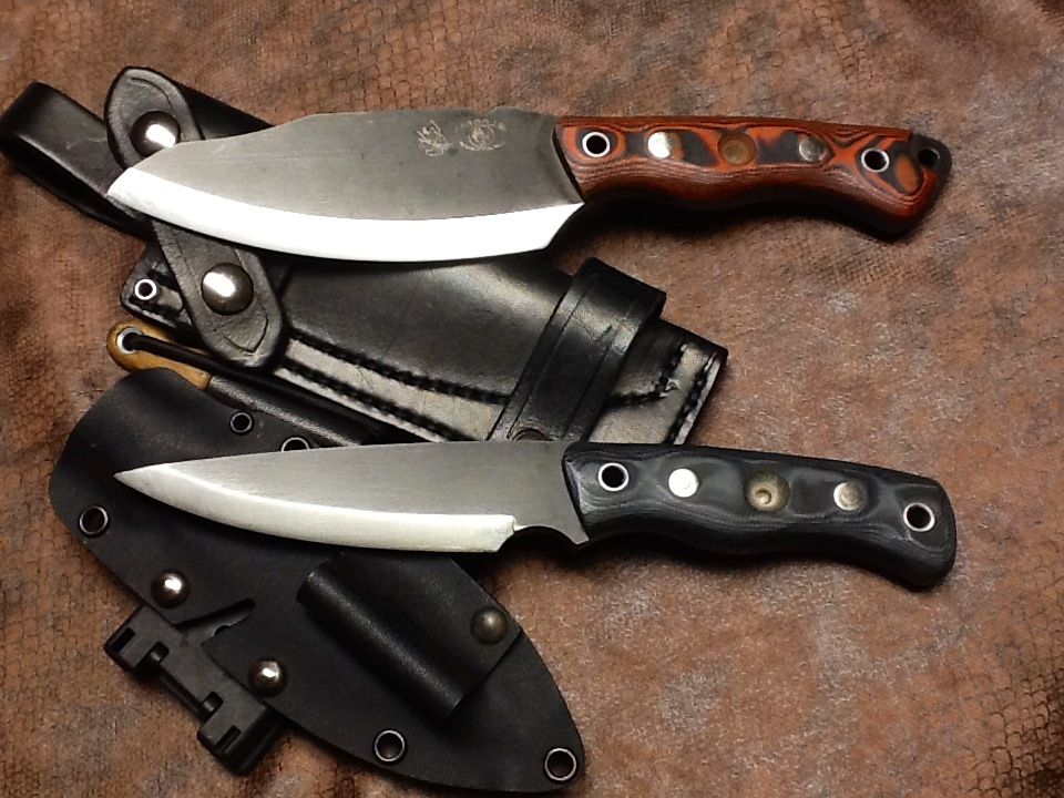

My Habilis bushtool. Loved the knife, hated the only mildly sharp pseudo Scandi grind. So I spent a few hours today doing a full height convex zero grind edge. Now it takes my stropping very well and is very scary sharp.
Already reground my Habilis trapper a few months back.
I like the wide blade and slicing edge. Looks like an excelent bushtool as the name infers.

Well I have used the trapper quite a bit. I've had that for about a yr. Fantastic design. I know some folks don't like a choil but this knife does it right. The point is great for drilling starter holes and if you look at the pic you'll see that I've used the fire bearing for a few bow drill fires. The spine is plenty sharp too shower good sparks off the ferro rod. I mostly use mine for bushcrafting tasks and food prep. The trapper sucked at food prep until my high line regrind. Now it slices and shaves like a dream. No issues with rust at all on the polished edge portion. Course I keep my knives well oiled.:)

Sure. I used a smiths diamond segmented plates first. The Coarse Diamond - 325 Grit to remove the heavy grinding lines and reshape the apex bevel, removing the shoulder portion. Next the Fine Diamond - 750 Grit to remove the scratches left from the 325 and bring the micro bevel line down to the edge. All this is just reshaping not sharpening.
Next I go to a 1000 grit wet stone to hone the edge. After stoning I move to the leather stropp. Black compound to develop the micro bevel and polish the stoning marks out. At this point she should be able to slice newsprint very easily. Then I go to the green compound to refine the edge and polish the convex bevel even more.
Now, all of these steps require a bit of practice and control. This is not my first rodeo if you follow me. There are many videos online with Cliff Stamp and virtuovice if you wanna pick up some very valuable information beforehand. I only say this because I throw a small word like "stoning" or "stropping". These words are loaded with skill and technique and take up a lot of time. Hope this helps. I'll try and post some pics of during resharpening for you as well. In all, I have 5hrs in this edge.
