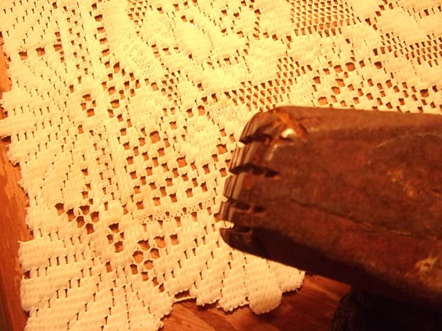

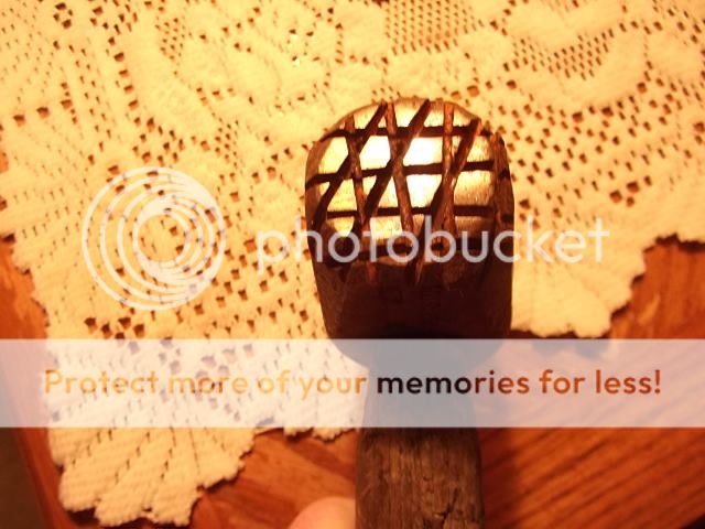

Take an old smaller sledge or an old ball peen hammer and use a cut off wheel on an angle grinder to grind on the flat face of the hammer a bunch of hash tag or tic tac toe type marks in it, and grind some diagonally across those as well. This is just a simple decription and preferably you grind them so they're a bit more random, which looks better IMHO.. Then if you don't forge, you can profile your knife blade, drill the holes in the tang, and then hammer the blade and ricasso area before grinding the bevels. I like to texture mine after I get the profile forged in for the most part. But for heavier texture, I took a 1"x 3"x 1/2" thick piece of scrap steel and made it fit a hardy hole (very crudely) and did the same texture on the face of that which I will use than as a bottom die. In other words, I'll lay the blade on top of that small chunk of steel with it's face textured ("the die") while I hammer in the texture of the other side. I do this so I don't end up flattening out the texture I just hammered in due to the flat anvil surface. Here is a pic of the hammer I use for texuring...
Here is a side shot to show the depth of the cuts made. IMHO I'd say about 1/4" deep cuts are better than shallower, and give better texture..

I have a dog's head hammer like that one for doing Japanese small utility blades. The thing to remember in making one is that the size of the slots is as important as the size of the "pattern" flats. The wider the slot, the wider the raided pieces of metal on the surface.
Good point. So then the wider the slots are cut, the deeper the texture can go and the more aggresive it will feel and look due to the less surface area... I'll probably end up widening them up on mine since I like the texture like that.. Thanks for the tip Stacy! :) .
